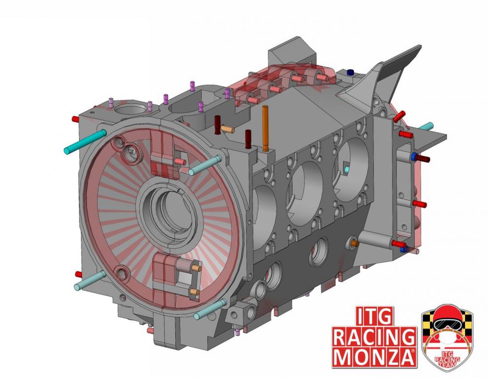

But this isn't far off from my dream for a narrow six-cyl 914: a mag-case 2.2S with MFI that revs to 8000 rpm backed up by short gears for 2/3/4 and a cruiser 5th.

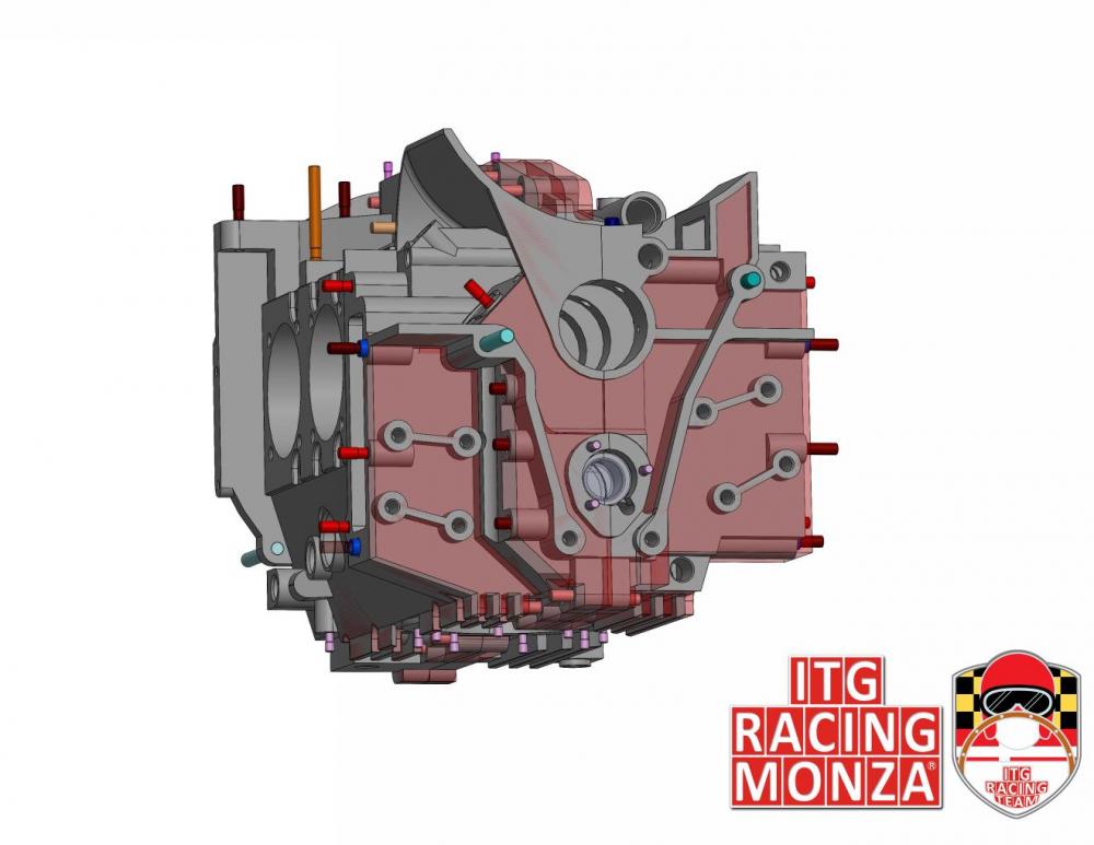

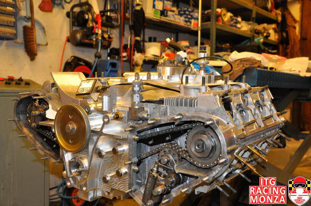

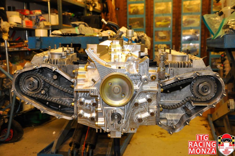

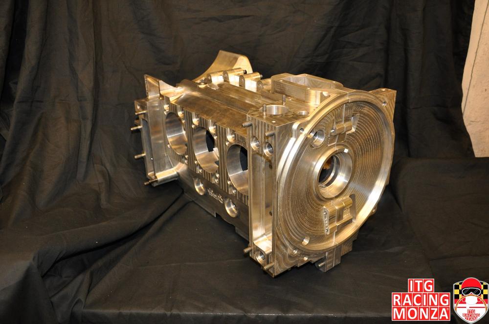

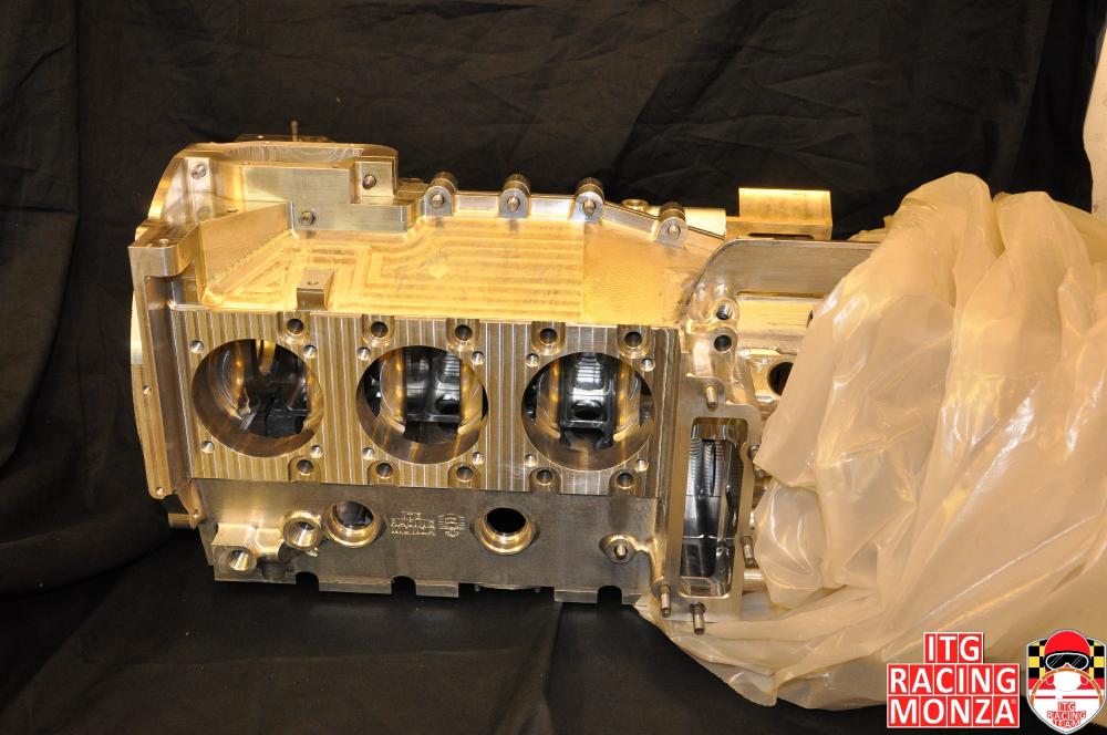

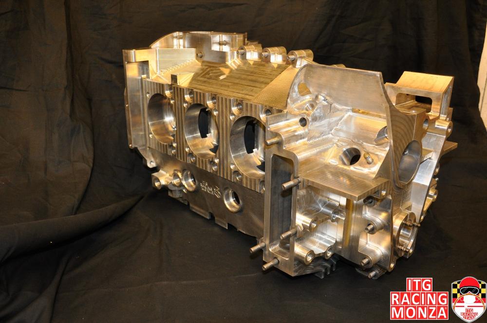

QUOTE(Superhawk996 @ Feb 21 2021, 09:44 AM) *
In the grand scheme of maching up mag cases, $6500 for a completely new casting CNC machined, would be sort of "resonable". Still wouldn't be Mag which would be sort of a downer for me but I get it. Hardly anyone casting Mag these days.
Not sure about price, but machined mag case got FIA approval for early 911 race cars—and startup doesn't look too far off.
https://www.early911sregistry.org/forums/sh...c-Racing/page20

stownsen914   Pretty sure that ITG small bore case pictured abov...   Feb 22 2021, 11:32 AM
