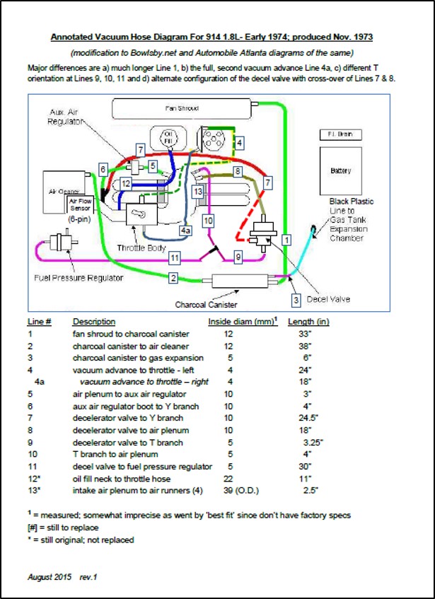

Is the hose sizes correct in the pic below, are they measured OD or ID?
I'm trying to figure out what size and how much hose to buy for three '74 djet systems.
Thanks (IMG:style_emoticons/default/smile.gif)
edit dang I thought this was the Djet Diagram, but it's 1.8 (IMG:style_emoticons/default/sad.gif)
(IMG:http://www.914world.com/bbs2/uploads/post-10753-1611167954.jpg)

Mark Henry   Is the hose sizes correct in the pic below, are th...   Feb 22 2021, 02:38 PM
StarBear   Is the hose sizes correct in the pic below, are t...   Feb 23 2021, 07:19 AM
JeffBowlsby   Here you go Mark, if you choose to use my hose dia...   Feb 25 2021, 03:18 AM
Mark Henry   Excellent! Thank you Jeff I have four 2.0 buil...   Feb 25 2021, 11:52 AM
