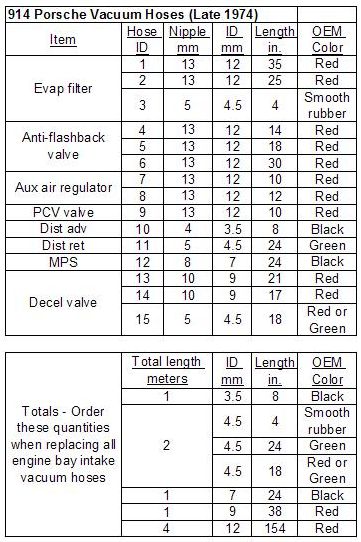

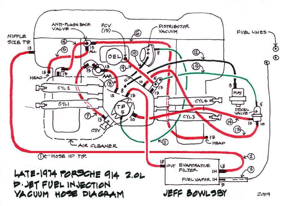

Here you go Mark, if you choose to use my hose diagram:

Mark Henry   Is the hose sizes correct in the pic below, are th...   Feb 22 2021, 02:38 PM
StarBear   Is the hose sizes correct in the pic below, are t...   Feb 23 2021, 07:19 AM
JeffBowlsby   Here you go Mark, if you choose to use my hose dia...   Feb 25 2021, 03:18 AM
Mark Henry   Excellent! Thank you Jeff I have four 2.0 buil...   Feb 25 2021, 11:52 AM
