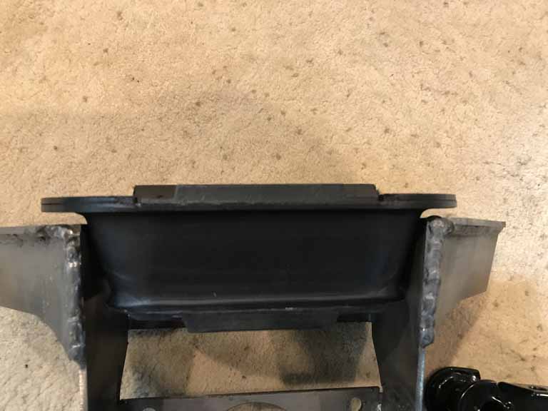

I recently purchased the OEM mount from Mad Dog, you couldn't ask for a better fit. It nestled into the recess and allowed basically no room for error. I socked it in with a couple self tapping screws and went ahead with the plug and fillet welds.
I removed the paint from the mounting surfaces with paint stripper and cleaned it up with a sanding disc prior to welding
From what I understand the factory placed additional reinforcement in this area. Running the welds for this mount I sensed it the way my MIG was acting. I bet you could pick the entire car up from this mount. Very well done Mad Dog Attached Image Attached Image

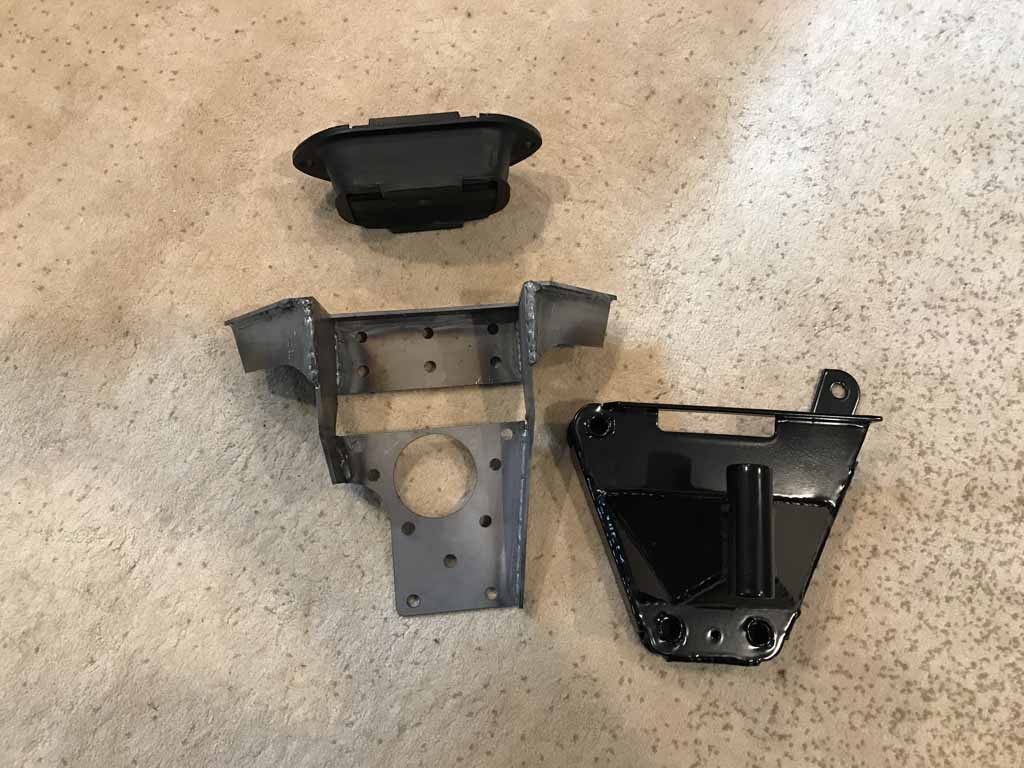

Got the engine side back from powder coat. Looks great!
Yesterday I received the URO mount p/n 914 375 049 00 Appears to be nicely made.
Did a quick trial fit to put URO mount into the body side bracket . . . almost! (IMG:style_emoticons/default/idea.gif)
Not a big deal really, but the body side bracket will need a little clearnace work to properly fit the the radius of the URO isolator can.
I want to be really clear - I don't see this as reflecting poorly on the Mad Dog mount or the URO isolator.
When you're doing these sorts of conversions with hand made parts, a little finessing is part of the game. Knowing many will likely use the Wevo mount, it wouldn't even be an issue. The isolator holes line up perfectly though! Great job making allowance for use of the OEM style isolator!
Likewise, there could be minor difference in the URO isolator can vs. the 914/6 mount isolator that Mad Dog built his orignal prototype to. Again, I'm just very glad URO is reproducing the 914/6 mount that was NLA for quite a while.
Mock ups and trial fitting are all part of the game. Just wanted to post my situation and prep others for need to do a little fitting to make it all work.

Superhawk996   @930cabman Oh man, that was beyond simple. ...   Feb 27 2021, 03:12 PM
930cabman   Hawk, guess I should have tried a test fit prior t...   Feb 27 2021, 06:48 PM
Superhawk996   I should have tried a test fit prior to welding t...   Feb 27 2021, 06:54 PM
