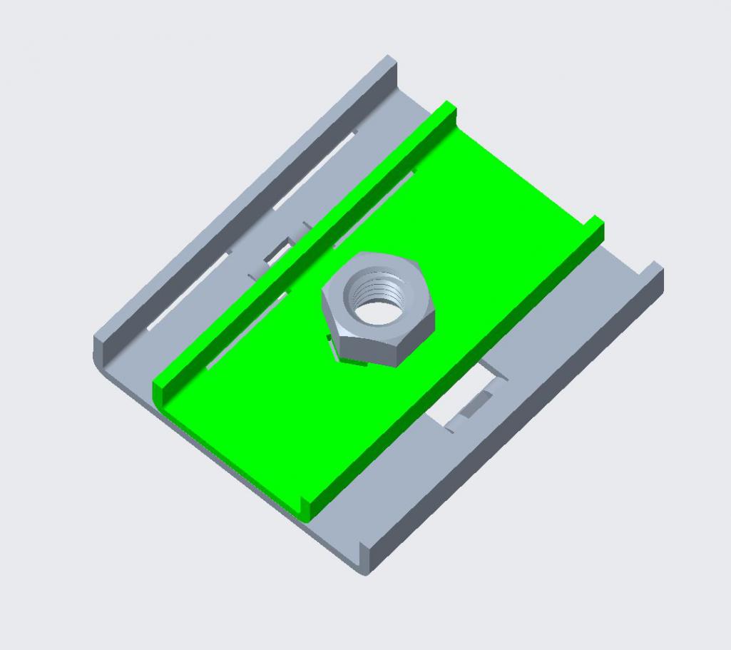

maddog   Here is what Im thinking for the bottm plate?   Feb 16 2021, 02:36 PM
Superhawk996   Here is what Im thinking for the bottm plate? ...   Feb 16 2021, 02:55 PM
maddog   Hawk, I think the thickness of the bottom plate is...   Feb 16 2021, 03:04 PM
Superhawk996   Hawk, I think the thickness of the bottom plate i...   Feb 16 2021, 04:04 PM

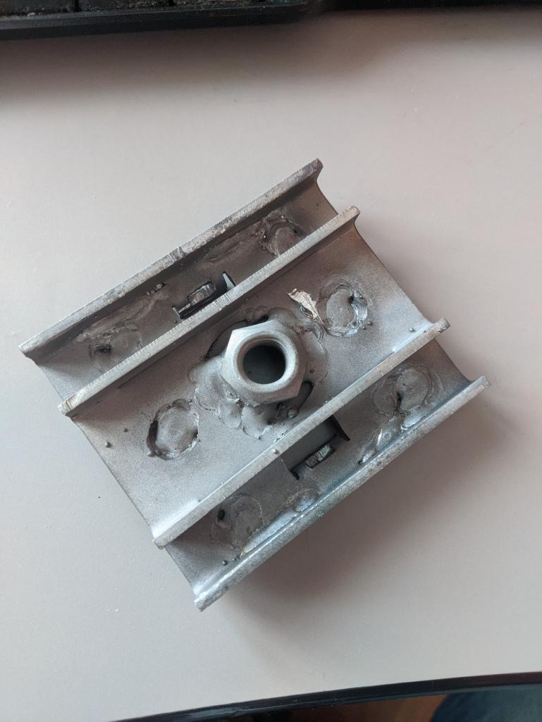

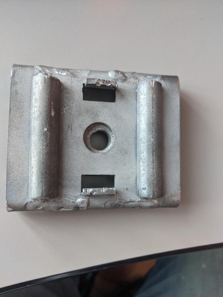

maddog   got the blanks the other day, formed them up, just...   Feb 19 2021, 04:05 PM
mb911   got the blanks the other day, formed them up, jus...   Feb 19 2021, 04:10 PM
mepstein   got the blanks the other day, formed them up, jus...   Feb 19 2021, 04:38 PM
Superhawk996   got the blanks the other day, formed them up, jus...   Feb 19 2021, 07:06 PM

maddog   so not happy with how the first prototype turned o...   Feb 23 2021, 09:26 AM
Superhawk996   so not happy with how the first prototype turned ...   Feb 27 2021, 11:16 AM
mepstein   [quote name='maddog' post='2893914' date='Feb 23 ...   Feb 27 2021, 11:29 AM
