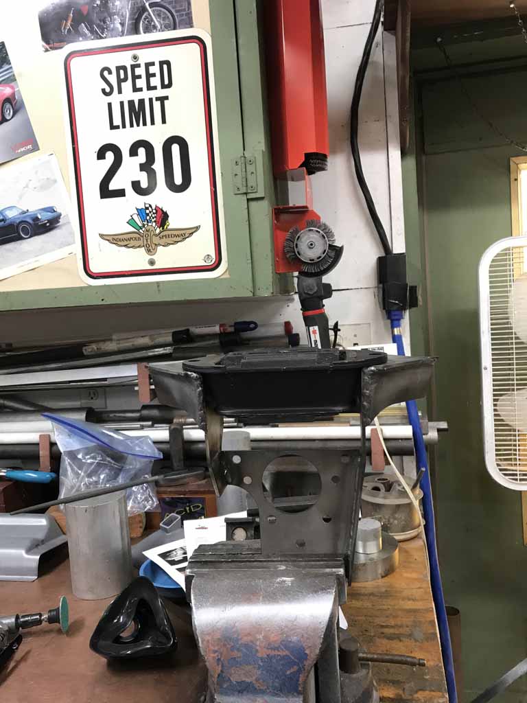

Making the conversion to a 6 cyl, we have several choices to make with mounts, exhaust, fuel, oil tank, engine tin, ....

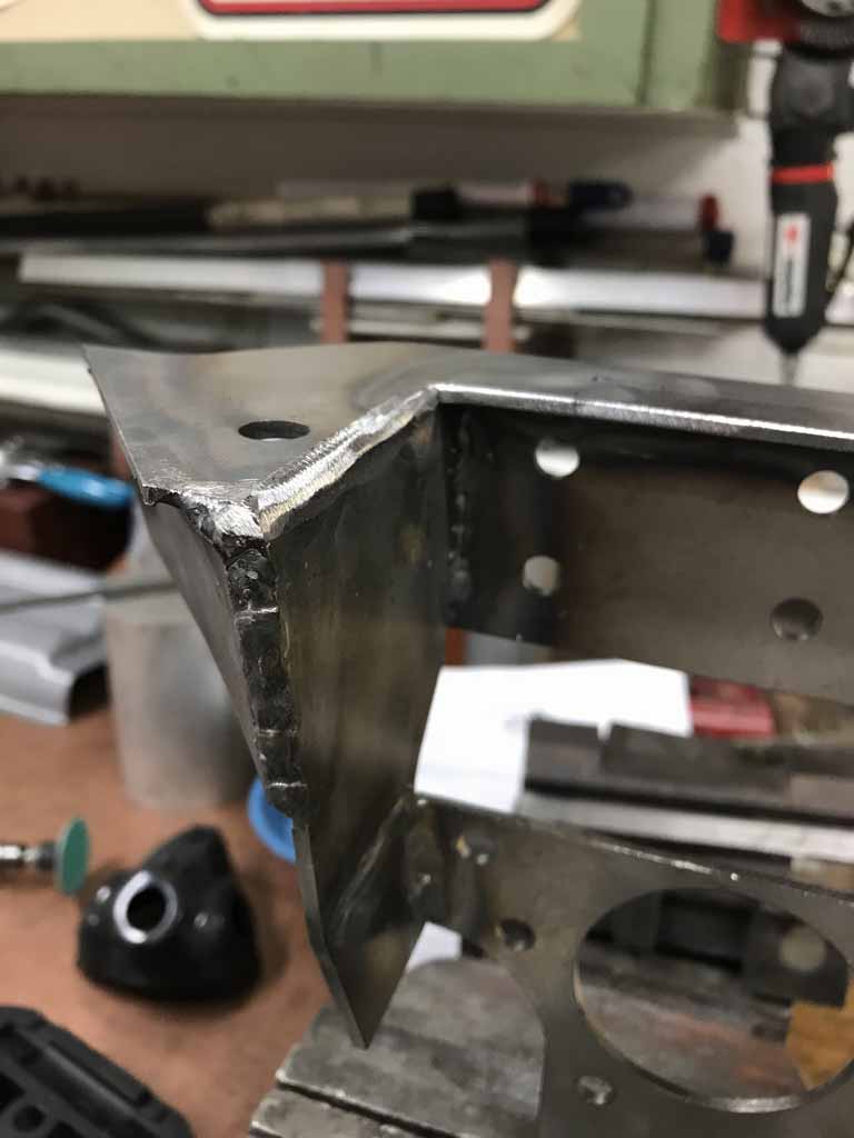

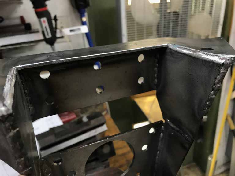

I recently purchased the OEM mount from Mad Dog, you couldn't ask for a better fit. It nestled into the recess and allowed basically no room for error. I socked it in with a couple self tapping screws and went ahead with the plug and fillet welds.
I removed the paint from the mounting surfaces with paint stripper and cleaned it up with a sanding disc prior to welding
From what I understand the factory placed additional reinforcement in this area. Running the welds for this mount I sensed it the way my MIG was acting. I bet you could pick the entire car up from this mount. Very well done Mad Dog Attached Image Attached Image

Oh man, that was beyond simple.
All I had to do was radius the corners a bit, took a smidge off the back side, and leveled a weld bead. 36 grit on a 2" disk and it was done in like 15 minutes.
No modification done to the URO isolator.
Fits perfectly now. (IMG:style_emoticons/default/piratenanner.gif)
