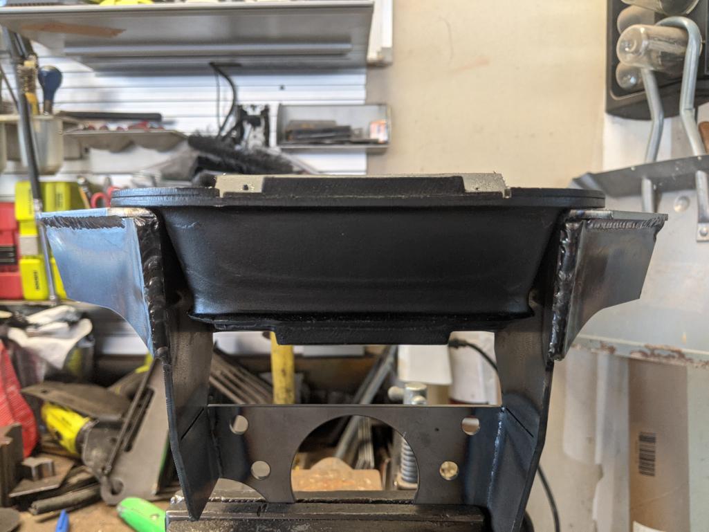

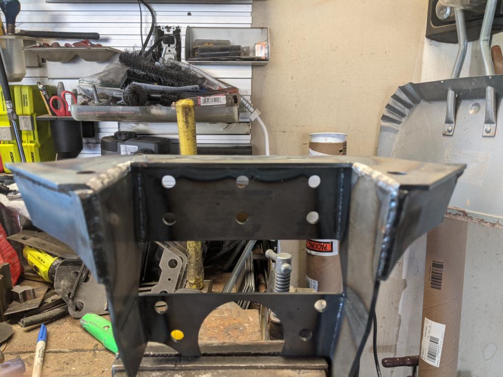

maddog   Hi guys, Hawk is right about the URO mount interfe...   Feb 28 2021, 07:58 AM
