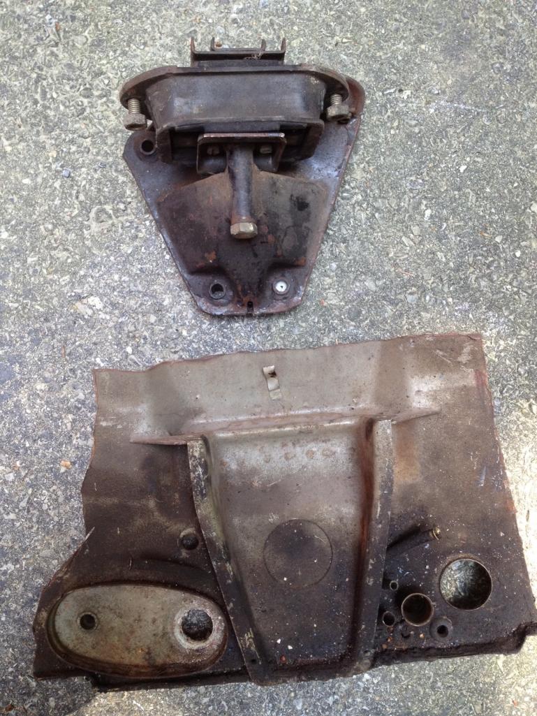

for comparison..

QUOTE(sixnotfour @ Feb 28 2021, 02:22 PM) *
for comparison..
Thanks for the pic of the OEM sheetmetal. I initialy investigated trying to find OEM metal but that was a losing proposition both from availability and cost perspective. Nice score!
Yup, that explains it -- softened radius vs. MadDog mount that was a sharp corner that interfered with the URO mount.
A few minutes with the grinding disc and I'm good to go.

QUOTE(Superhawk996 @ Feb 28 2021, 04:13 PM) *
for comparison..
I sold an oem mount for $600 a couple years ago. It went quickly with multiple offers. Probably double now.
