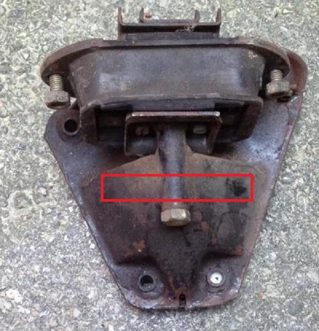

Ralph meaney showed me one of his engine consoles that that had a piece steel overlapping the mount ,,,see pic below..

sixnotfour   Ralph meaney showed me one of his engine consoles ...   Feb 28 2021, 05:02 PM
