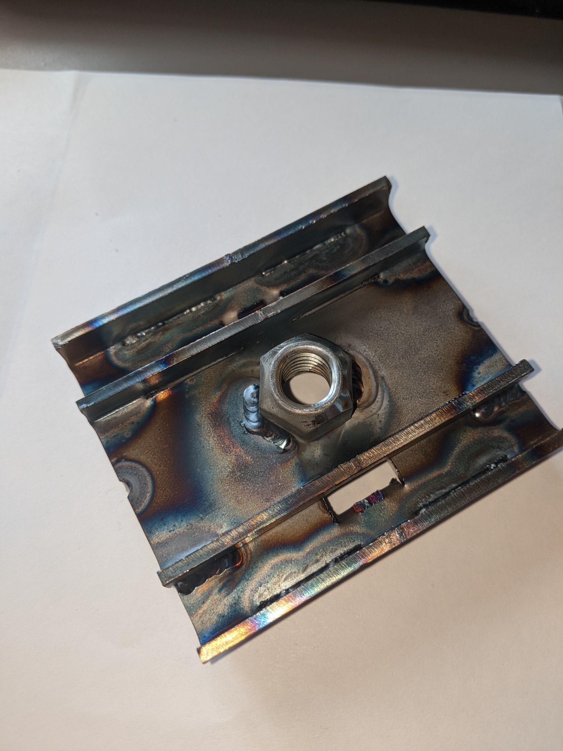

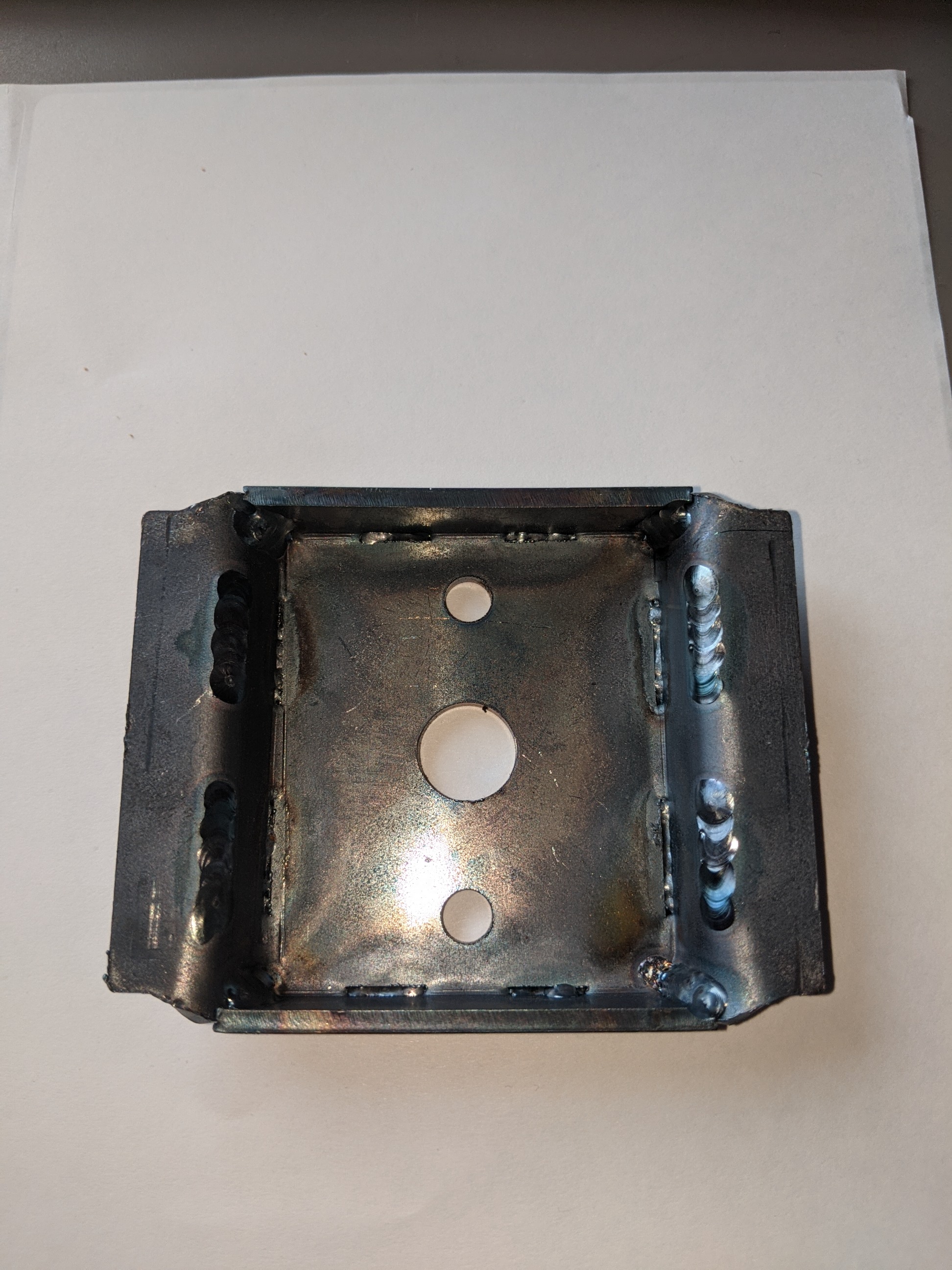

UPDATE: got the new blanks formed and tig welded, going to drop these off to get plated today or tomorrow

maddog   got the blanks the other day, formed them up, just...   Feb 19 2021, 04:05 PM
mb911   got the blanks the other day, formed them up, jus...   Feb 19 2021, 04:10 PM
mepstein   got the blanks the other day, formed them up, jus...   Feb 19 2021, 04:38 PM
Superhawk996   got the blanks the other day, formed them up, jus...   Feb 19 2021, 07:06 PM
930cabman   Dave is on the case for sure, keep up the good wor...   Feb 19 2021, 05:30 PM
maddog   so not happy with how the first prototype turned o...   Feb 23 2021, 09:26 AM
Superhawk996   so not happy with how the first prototype turned ...   Feb 27 2021, 11:16 AM

Superhawk996   Update on OEM mount Got the engine side back from...   Feb 27 2021, 11:12 AM
930cabman   Update on OEM mount Got the engine side back fro...   Feb 27 2021, 01:37 PM
Superhawk996   we are in a similar boat, but I have welded the ...   Feb 27 2021, 01:43 PM
Superhawk996   @930cabman Oh man, that was beyond simple. ...   Feb 27 2021, 03:12 PM
930cabman   Hawk, guess I should have tried a test fit prior t...   Feb 27 2021, 06:48 PM
Superhawk996   I should have tried a test fit prior to welding t...   Feb 27 2021, 06:54 PM
maddog   Hi guys, Hawk is right about the URO mount interfe...   Feb 28 2021, 07:58 AM

maddog   UPDATE: got the new blanks formed and tig welded, ...   Mar 10 2021, 11:54 AM

maddog   just picked these up from the platers, turned out ...   Mar 18 2021, 04:56 PM
maddog   here is the top bracket   Mar 18 2021, 04:57 PM
