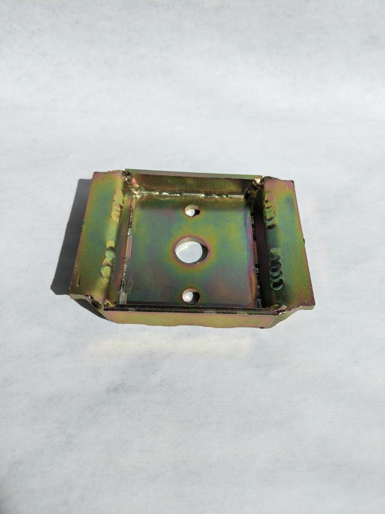

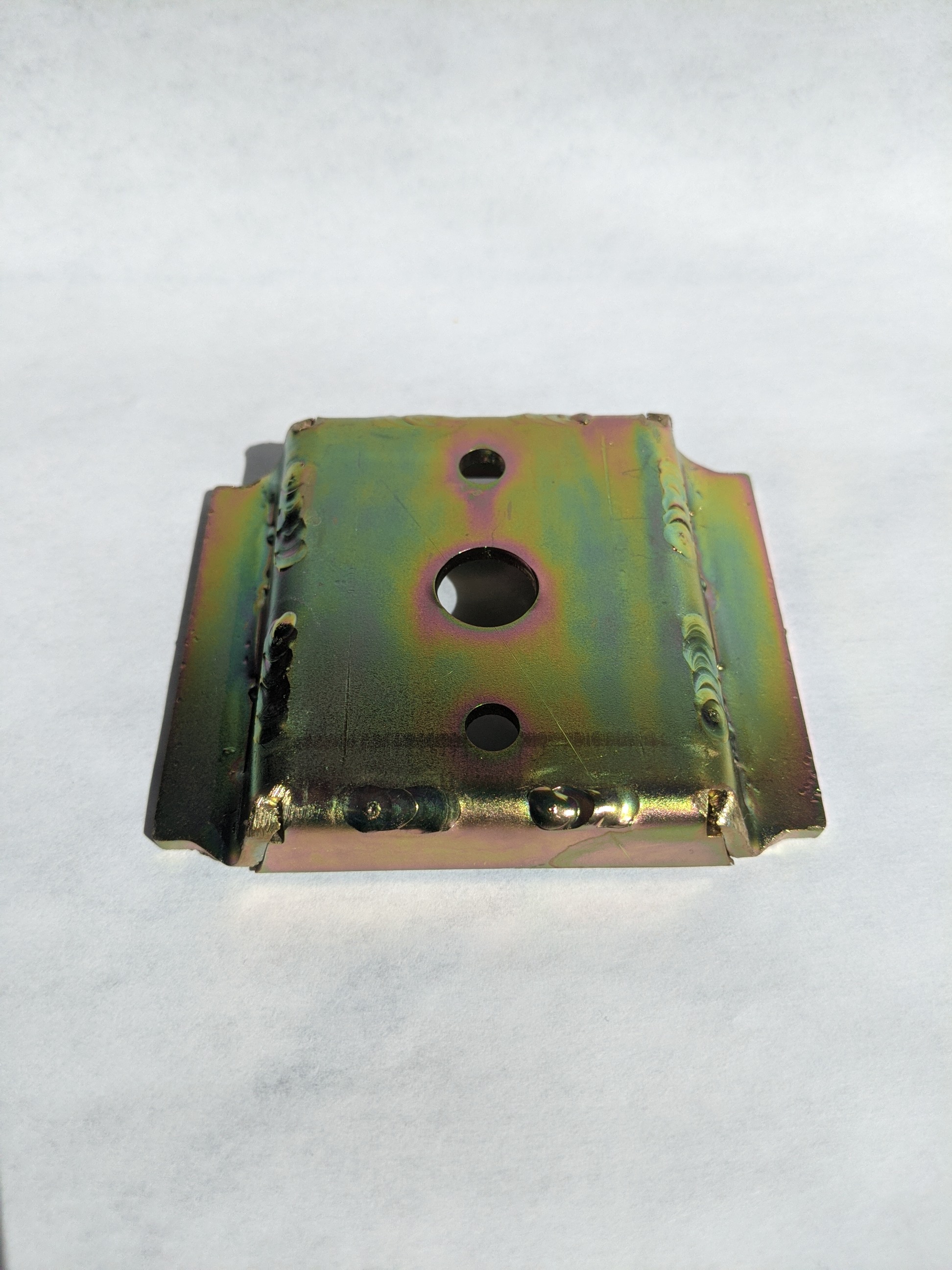

maddog   UPDATE: got the new blanks formed and tig welded, ...   Mar 10 2021, 11:54 AM
Superhawk996   :headbanger:   Mar 10 2021, 12:34 PM

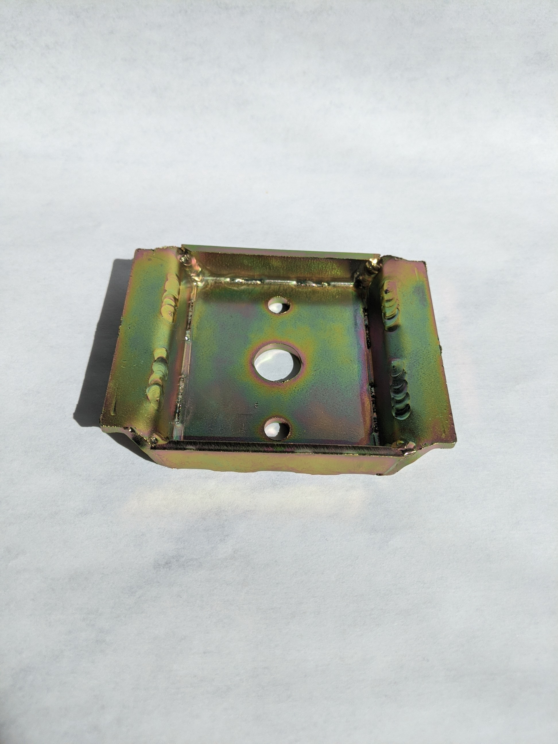

maddog   just picked these up from the platers, turned out ...   Mar 18 2021, 04:56 PM
maddog   here is the top bracket   Mar 18 2021, 04:57 PM
Superhawk996   :wub:   Mar 18 2021, 05:51 PM
mb911   What will pricing be at? I want to bring in some i...   Mar 18 2021, 06:04 PM
maddog   Ben, parts are live on the website now. Upper brac...   Mar 18 2021, 07:12 PM
