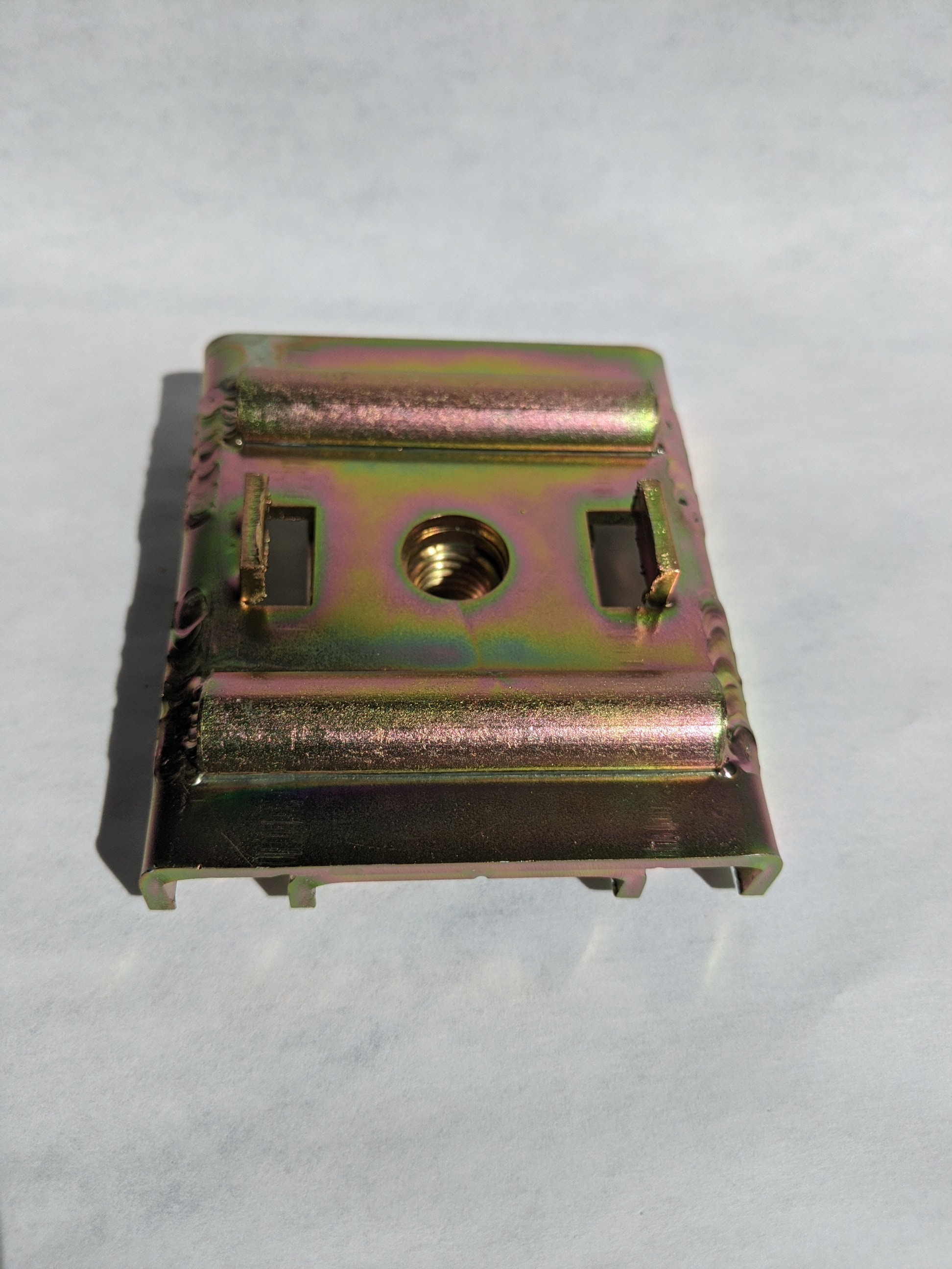

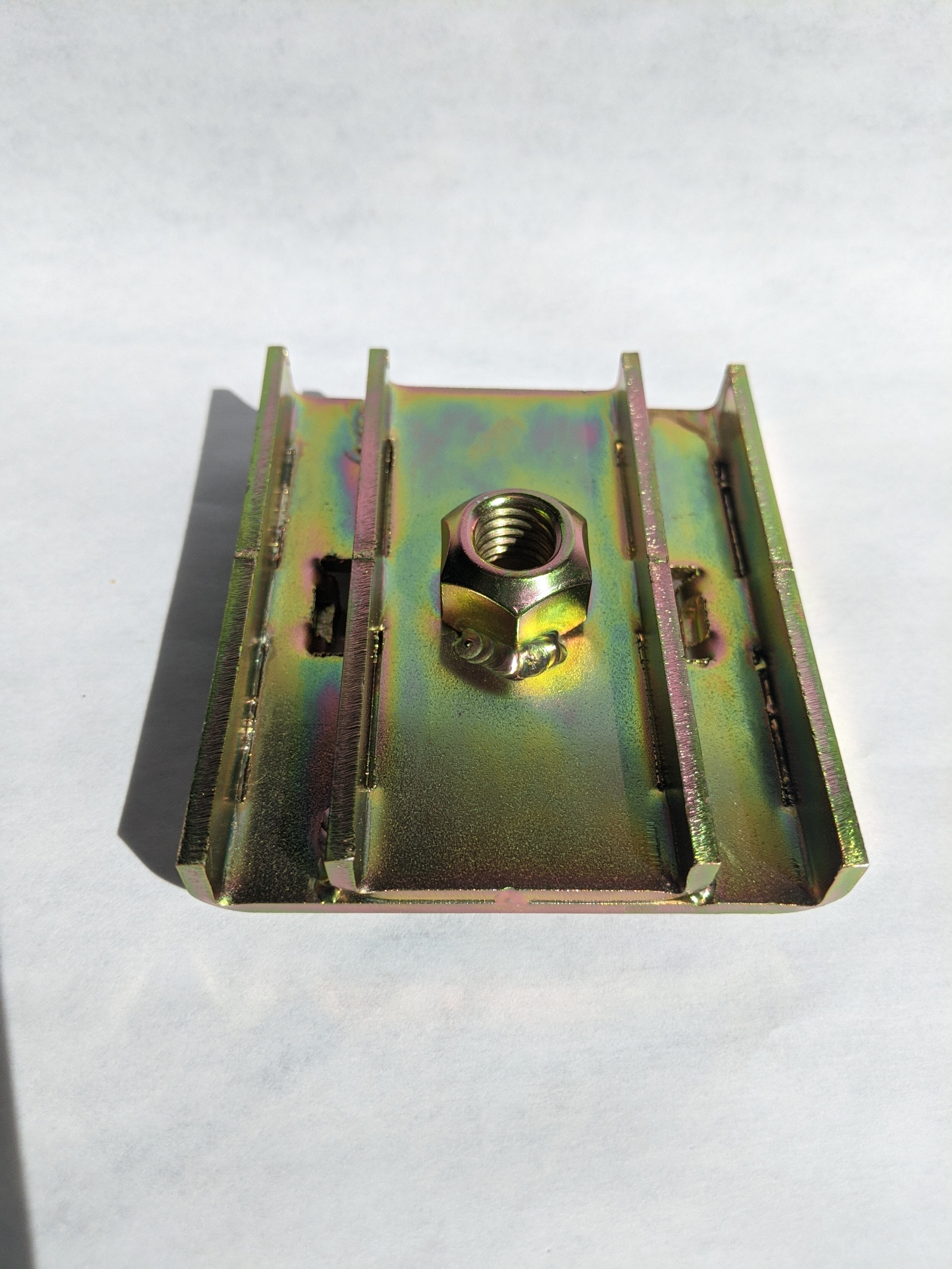

maddog   UPDATE: got the new blanks formed and tig welded, ...   Mar 10 2021, 11:54 AM
Superhawk996   :headbanger:   Mar 10 2021, 12:34 PM
maddog   just picked these up from the platers, turned out ...   Mar 18 2021, 04:56 PM
maddog   here is the top bracket   Mar 18 2021, 04:57 PM
