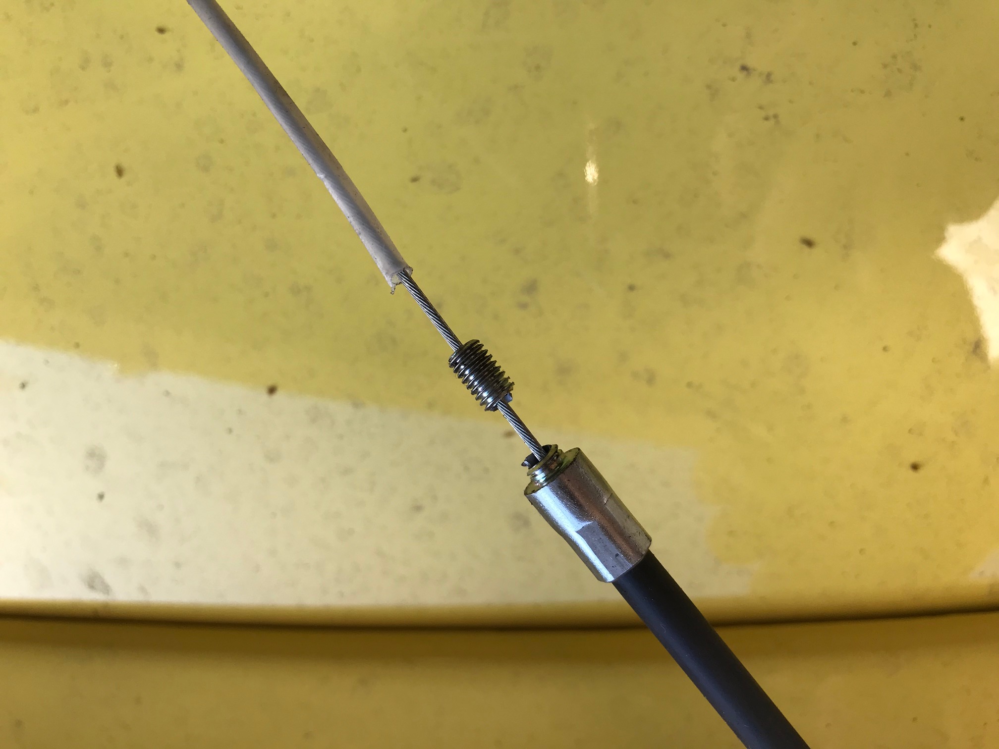

Finally I find the time to install the cable I bought from Pelican (I didn't see the message about my fellow Texan, until after I already ordered the part).
When tightening up the locking nut the stupid thing broke off. Now the car will have to remain on blocks even longer. (IMG:style_emoticons/default/headbang.gif)
Also noted that the cable is too short to install it stress free and without sharp bends. So will be looking for longer version.

QUOTE(HansJan @ Mar 20 2021, 07:38 PM) *
Because y'all like pics.
What brand cable was it ? I like Gemo. I have heard complaints about Terry cables that they use fewer strand that are larger in diameter and have more drag sometimes resulting in delayed return.
