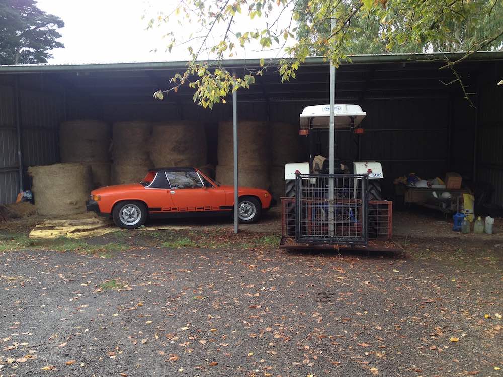

good news.
its been at least 20 years since the car has done a good long run.
it got it.
out on the "interstate" it keeps on winding out.
i took my eyes off the speedo a few times and it was running up to 90 mph comfortably on its accord - turbine smooth, had forgotten what this car was like at speed cruise.
(in australia sadly that would mean instant loss of license and car impounded if the cops got you in the radar gun or pole cameras - so i had to start being careful after i let it happen a few times).
happy to sit and cruise at 70/75mph all day long.
run up through a great little back road twisty enscarpement climb with lots of sharp corners.
no coughs, no stumbles.
gave 8.9L per 100k or in usa-speak 26/27 miles per US gallon.

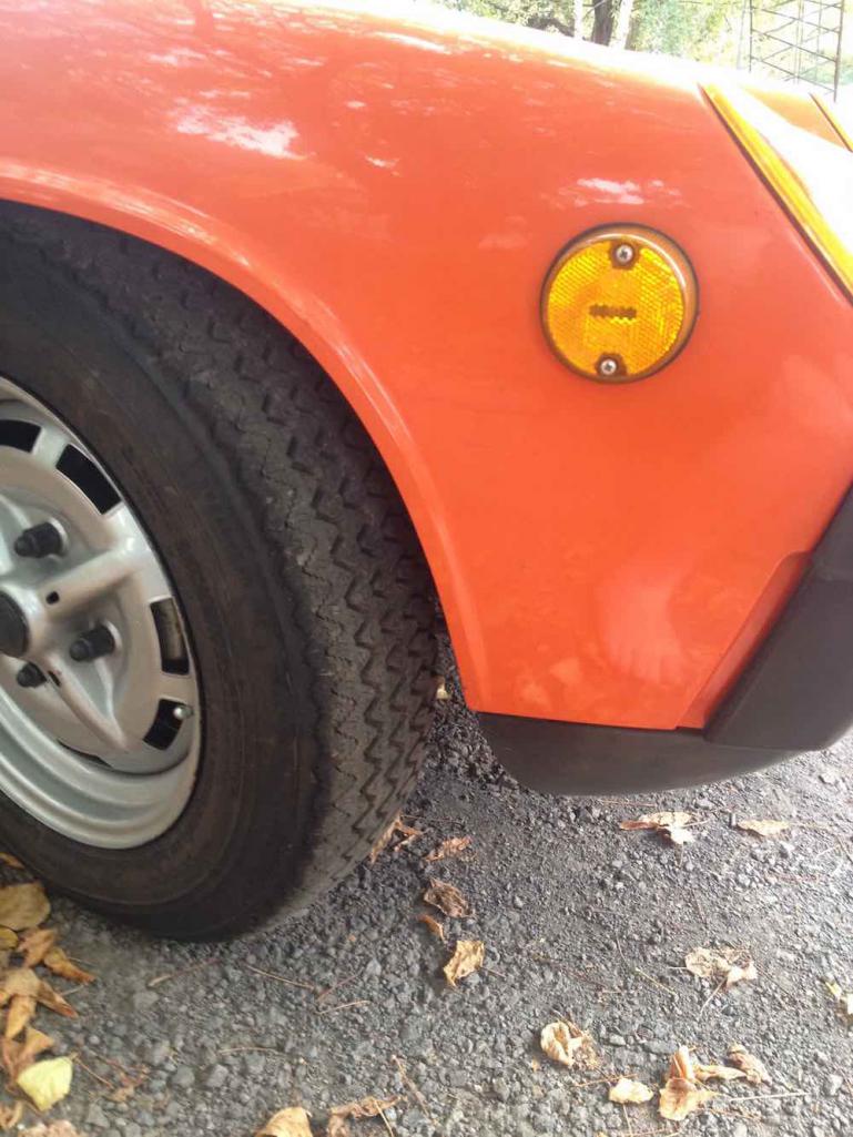

getting used to the thin michies, feel good on second rate little country roads with uneven pitching surfaces.
