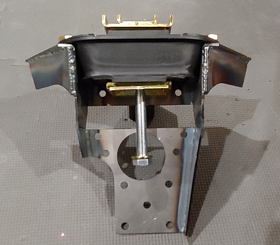

Making the conversion to a 6 cyl, we have several choices to make with mounts, exhaust, fuel, oil tank, engine tin, ....
I recently purchased the OEM mount from Mad Dog, you couldn't ask for a better fit. It nestled into the recess and allowed basically no room for error. I socked it in with a couple self tapping screws and went ahead with the plug and fillet welds.
I removed the paint from the mounting surfaces with paint stripper and cleaned it up with a sanding disc prior to welding
From what I understand the factory placed additional reinforcement in this area. Running the welds for this mount I sensed it the way my MIG was acting. I bet you could pick the entire car up from this mount. Very well done Mad Dog Attached Image Attached Image

Look what showed up today... (IMG:style_emoticons/default/piratenanner.gif)
All fits well and gonna put it aside for a future project.
Thanks again to David (Maddog) for making these items.

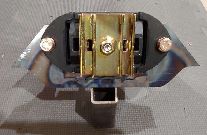

Superhawk996   Update on OEM mount Got the engine side back from...   Feb 27 2021, 11:12 AM
930cabman   Update on OEM mount Got the engine side back fro...   Feb 27 2021, 01:37 PM
Superhawk996   we are in a similar boat, but I have welded the ...   Feb 27 2021, 01:43 PM
Superhawk996   @930cabman Oh man, that was beyond simple. ...   Feb 27 2021, 03:12 PM
930cabman   Hawk, guess I should have tried a test fit prior t...   Feb 27 2021, 06:48 PM
Superhawk996   I should have tried a test fit prior to welding t...   Feb 27 2021, 06:54 PM
maddog   Hi guys, Hawk is right about the URO mount interfe...   Feb 28 2021, 07:58 AM
