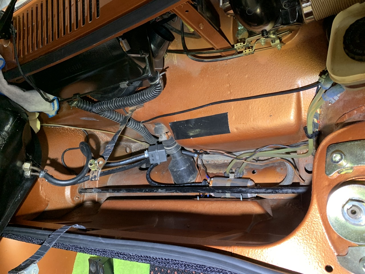

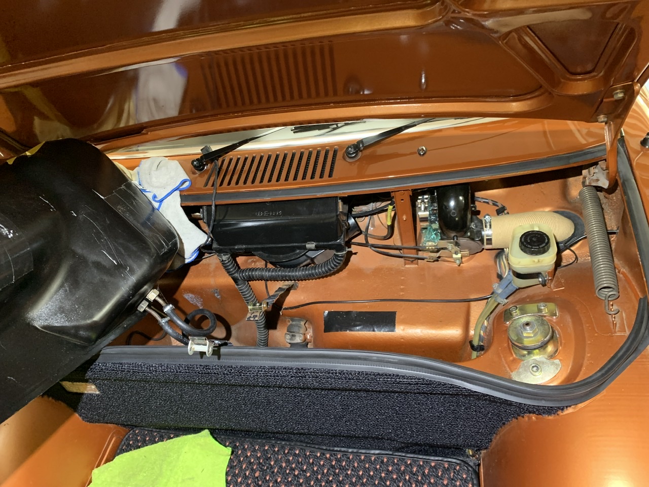

DRPHIL914   UPDATE: finally got around to installing this ne...   Mar 23 2021, 08:19 AM
DRPHIL914   tank up and box accessed- pretty clean under there...   Mar 23 2021, 08:24 AM
bob164   Don't think this is the issue with the fans, b...   Mar 23 2021, 02:39 PM
DRPHIL914   Don't think this is the issue with the fans, ...   Mar 24 2021, 04:59 AM
bob164   The picture isn't that clear, was referring to...   Mar 24 2021, 11:22 AM
DRPHIL914   The picture isn't that clear, was referring t...   Mar 25 2021, 06:39 AM
DRPHIL914   ok update from trouble shooting last night, after...   Mar 25 2021, 06:52 AM
