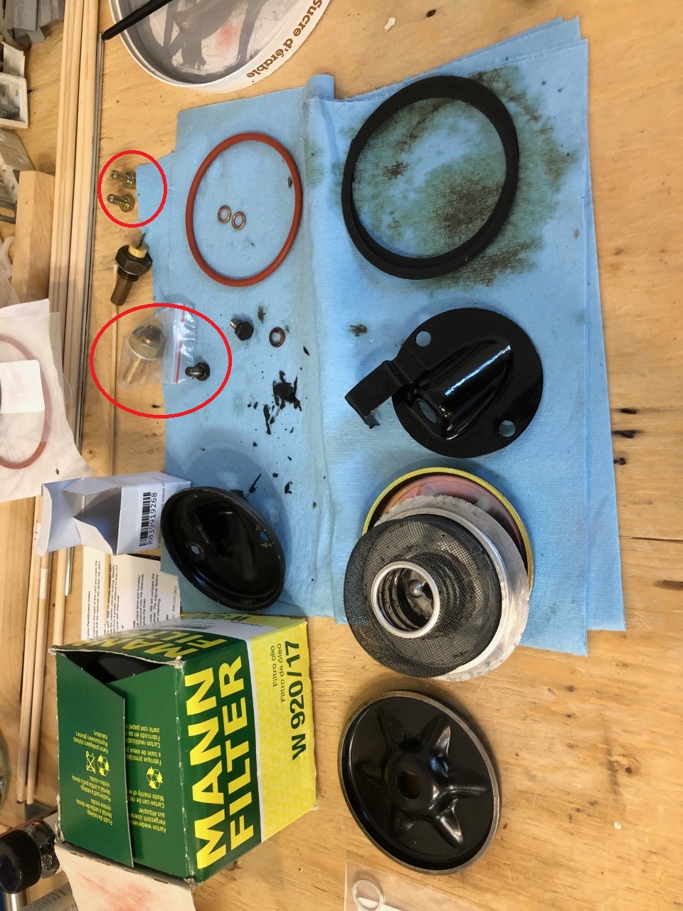

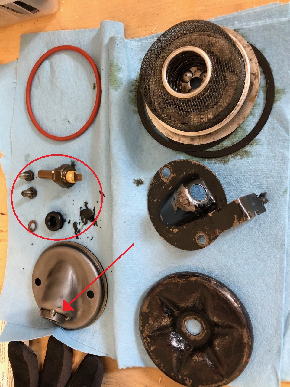

I have recently replaced gaskets, oil temp sensor and the "taco" plate on my '73 1.7. My central console temp gage was not working.
Now, not only the temp gage still not working, but I am facing a major oil leak which appears to be coming from the sensor wire rubber boot on the taco plate.
I took care to properly install the components ("red" oring, paper gasket and "crush washer" on the 2 retaining hex bolts) in addition to tightening them well as spec.
Before I attempt to retry this experience (I will need to drop engine oil again!), wondering what could be the problem:
1- for the temp gage still not working...
2- for the bad leak I noticed...
I heard that the sensor must fit the gage... I don't know if I have the correct part number.
Also, wondering if the sensor threaded coupling welded on the taco plate is supposed to be oil proof? There are only a few welds and so I assume that the oil can seep between the threaded part and the plate and escape through the boot.... My theory.
Thank you very much for your thought and comments!
Sebastien

Most type 4 engines have just a steel plate with no hole for the sensor.
Usually seal well with just the o-ring & copper washers.
