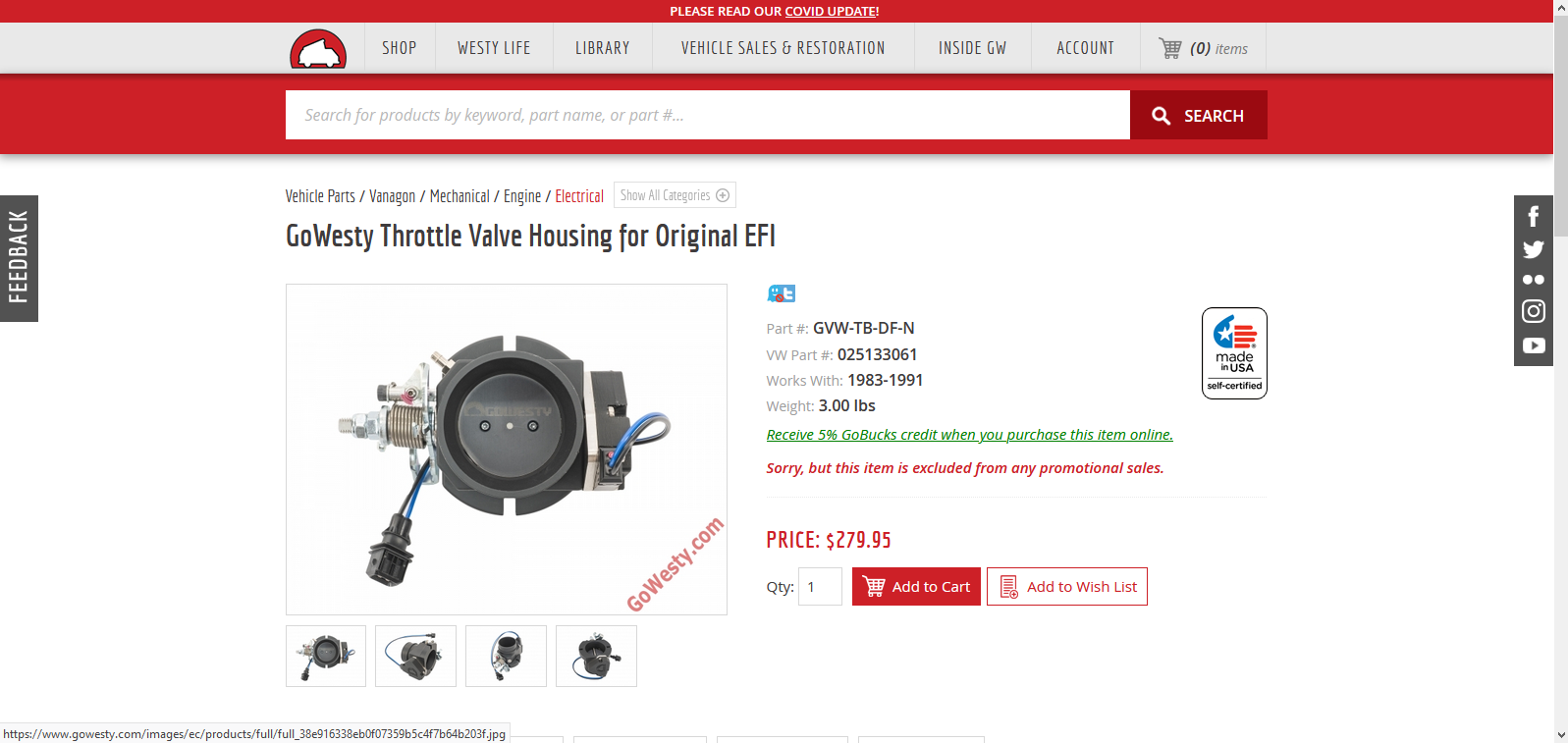

Has anyone done a GoWesty conversion yet?

QUOTE(timothy_nd28 @ Feb 17 2021, 10:40 AM) *
I sent a message yesterday to the folks at GoWesty (their "campus" is located about 0.5 miles from my house!) to see how their TPS could be adapted to work with our L-Jet system. I'll provide an update as soon as I hear back.

timothy_nd28   Has anyone done a GoWesty conversion yet?   Feb 17 2021, 11:40 AM
strawman   Has anyone done a GoWesty conversion yet? I se...   Apr 2 2021, 11:41 AM
ClayPerrine   Has anyone done a GoWesty conversion yet? I s...   Apr 2 2021, 12:05 PM
timothy_nd28   I purchased the GoWesty throttle body a few weeks ...   Apr 2 2021, 04:49 PM
