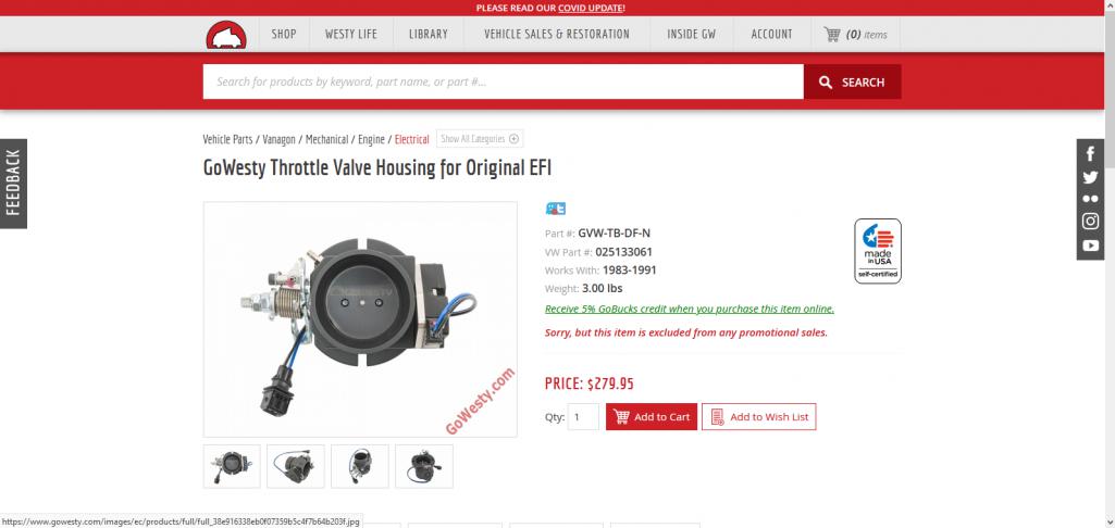

Has anyone done a GoWesty conversion yet?

I sent a message yesterday to the folks at GoWesty (their "campus" is located about 0.5 miles from my house!) to see how their TPS could be adapted to work with our L-Jet system. I'll provide an update as soon as I hear back.

The L-Jet is a throttle switch, not a TPS.
So a TPS fitted to it won't work. You would have to put the original L-Jet switch on it.
