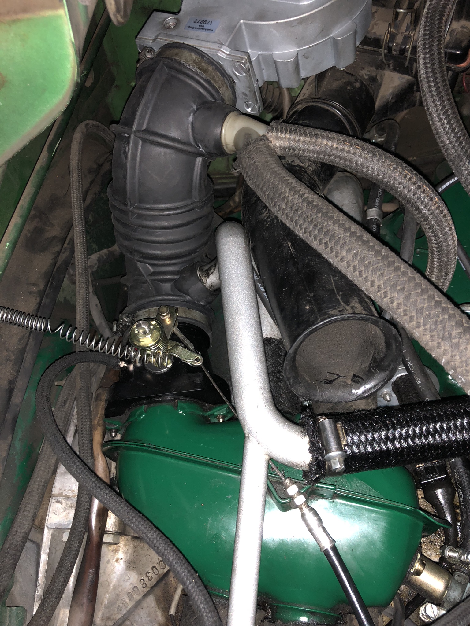

echocanyons
post Apr 2 2021, 05:17 PM
Posts: 2,119
Joined: 24-December 02
From: Bay Area, CA
Member No.: 7
I ran the go west TB for a couple years. I had ZPhill reorient it so the operating arm would fit.
It works and looks nice but it’s the long expensive way from point A to B.
It woke up the top end considerably, minor hit to the low end though.
Pay no attention to the throttle return spring. (IMG:style_emoticons/default/huh.gif)

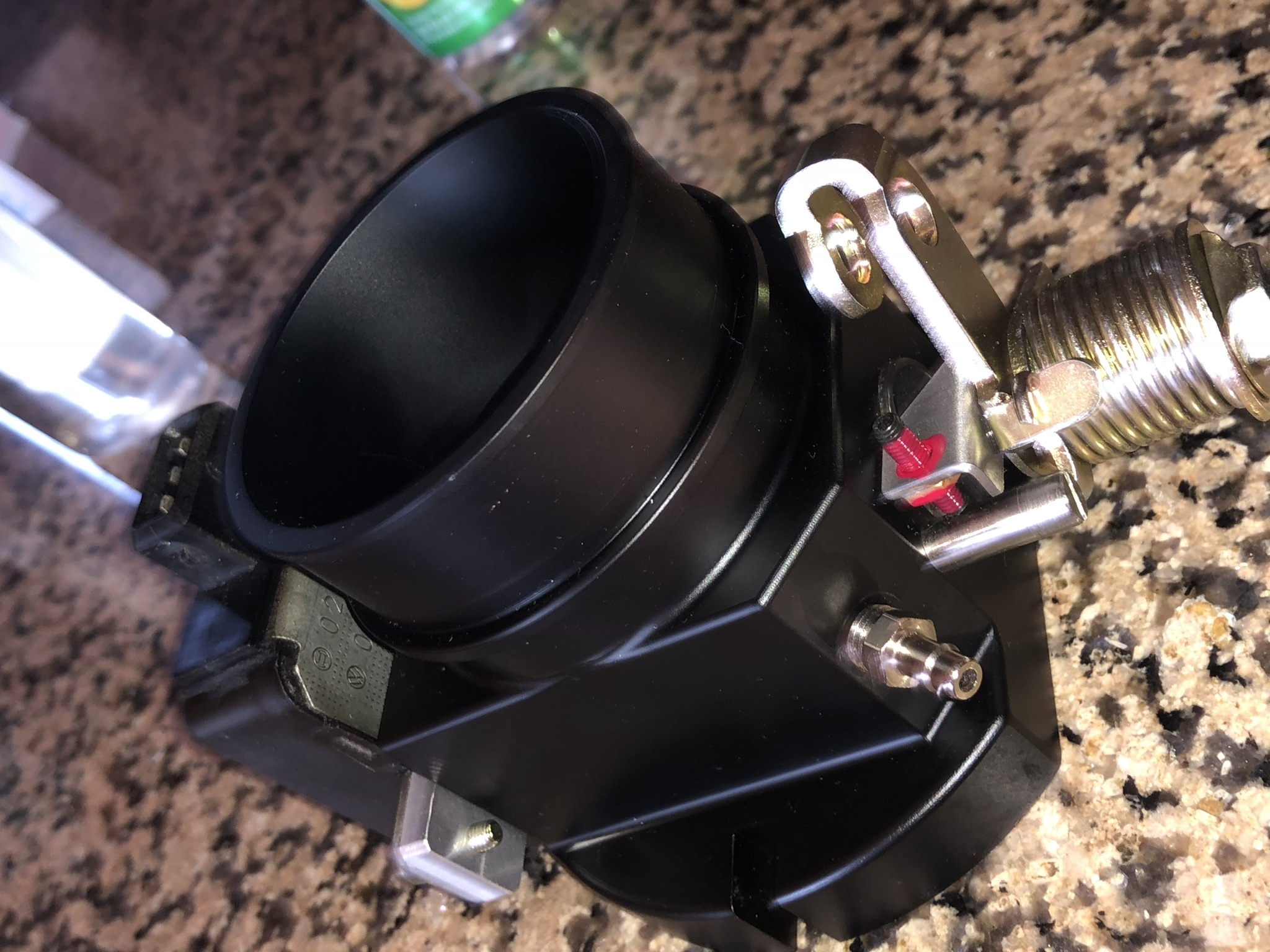

timothy_nd28   Has anyone done a GoWesty conversion yet?   Feb 17 2021, 11:40 AM
strawman   Has anyone done a GoWesty conversion yet? I se...   Apr 2 2021, 11:41 AM
ClayPerrine   Has anyone done a GoWesty conversion yet? I s...   Apr 2 2021, 12:05 PM
timothy_nd28   I purchased the GoWesty throttle body a few weeks ...   Apr 2 2021, 04:49 PM
wonkipop   I purchased the GoWesty throttle body a few weeks...   Apr 2 2021, 05:04 PM
echocanyons   I ran the go west TB for a couple years. I had ZPh...   Apr 2 2021, 05:17 PM
timothy_nd28   Beautiful! I'm going a slightly different...   Apr 2 2021, 05:22 PM
echocanyons   There is a taper but the go westy is part fits wit...   Apr 2 2021, 05:26 PM
timothy_nd28   I was going to buy a used Vanagon throttle body, b...   Apr 2 2021, 05:41 PM
Geezer914   I had to open up the plenum with a tail pipe expan...   Apr 4 2021, 01:38 AM
timothy_nd28   The GoWesty throttle body came like this, some kin...   Apr 5 2021, 03:29 PM
