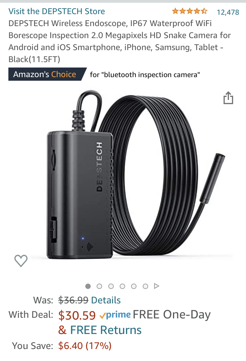

how about spending something like this and you can use it for various projects.

HansJan   Now I have really done it. This 'easy' thr...   Apr 3 2021, 11:21 PM
ndfrigi   how about spending something like this and you can...   Apr 4 2021, 01:23 AM
