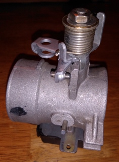

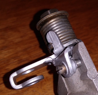

I tried it but ran into an issue with the orientation of the flat on the shaft that engages the throttle body switch component used with L-Jet.
Pictures are worth a thousand words, so here goes..
Here's the TPS and a picture of each TB with the plate in the throttle closed position. Original 1.8 L-jet on the right, Vanagon donor TB on the left. Notice the different orientation of the flat on the shafts. The flat engages a corresponding flat on the TPS. The flat on the Vanagon shaft is in the wrong position for the TPS.

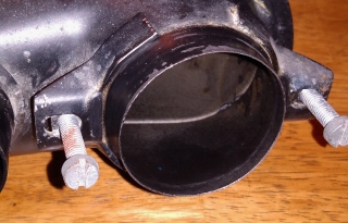

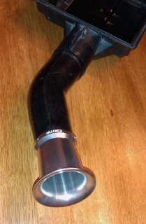

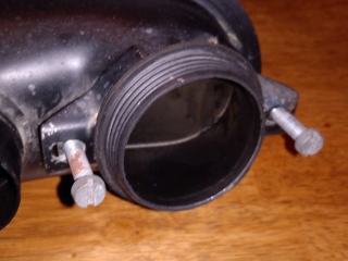

I had to open up the plenum with a tail pipe expander from 45 mm to 50mm. Also the snorkel on the air cleaner box is only 45 mm. Ordered a Vanagon rubber throttle body gasket, part # 025 133 073. The air horn is on ebay, 55mm motor cycle velocity stack, unfortunately from China for $9.99 shipped. Attached Image Attached ImageAttached ImageAttached Image[attachmentid=788
