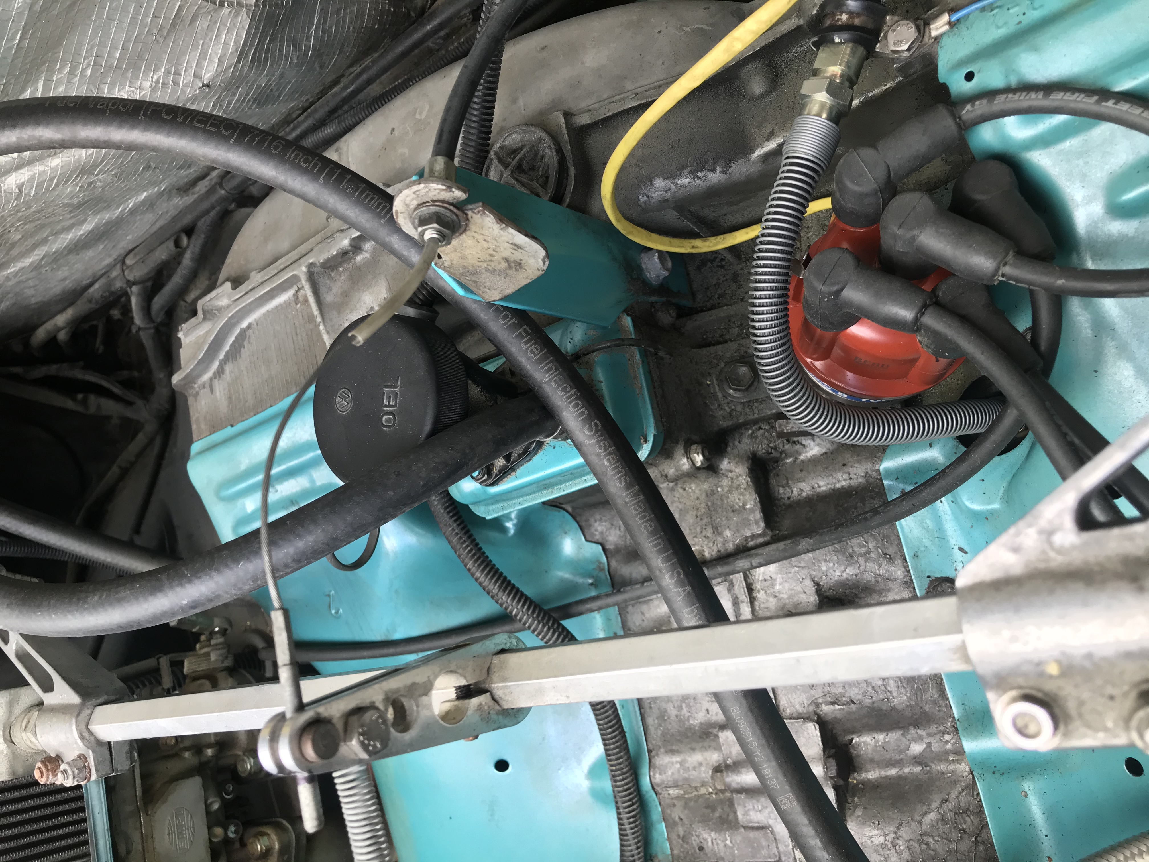

Ok. It was my turn to break down.
The throttle cable broke.
I was able to crank up the idle and limp to work.
Looking to buy new cable, so I can get back on the road.
914Rubber is sold out. Where can I buy a new one (for carbureted car with X-bar linkage).
Auto Atlanta might have them, but with them you never know when to expect the parts.

HansJan   Finally I find the time to install the cable I bou...   Mar 20 2021, 08:38 PM
bdstone914   Finally I find the time to install the cable I bo...   Mar 21 2021, 08:57 AM
HansJan   What brand cable was it ? I like Gemo. I have hear...   Mar 21 2021, 09:58 AM
scottthephotog   Finally I find the time to install the cable I bo...   Mar 21 2021, 06:12 PM
HansJan   Ooof. I've had that happen. As Clay said, Zim...   Mar 21 2021, 07:28 PM
HansJan   Also found that the pedal is not resting on the pe...   Mar 21 2021, 10:00 AM
Mark Henry   Yeah that part can break if even slightly over tig...   Mar 21 2021, 10:26 AM
HansJan   Seems that this easy repair is becoming a challeng...   Mar 31 2021, 08:46 PM
Sycolyst   Following....same issue. I drilled out a bolt and...   Apr 1 2021, 04:57 AM
Olympic 914   Have you checked the Porsche dealers? That's ...   Apr 1 2021, 08:05 AM
HansJan   Now I have really done it. This 'easy' thr...   Apr 3 2021, 11:21 PM
ndfrigi   how about spending something like this and you can...   Apr 4 2021, 01:23 AM
Tdskip   Oh man, hate when this stuff snowballs.   Apr 4 2021, 06:07 AM
bbrock   I think I would try gently jerking the accelerator...   Apr 4 2021, 09:06 AM
Mikey914   Pretty sure I have most of the parts needed to fab...   Apr 4 2021, 09:10 AM
HansJan   Pretty sure I have most of the parts needed to fa...   Apr 4 2021, 11:53 AM
914werke   I just ordered a custom length accelerator cable ...   Apr 4 2021, 11:24 AM
HansJan   I just ordered a custom length accelerator cable...   Apr 4 2021, 11:52 AM
HansJan   Using brute force, I was able to pull the jammed c...   Apr 4 2021, 09:52 PM
