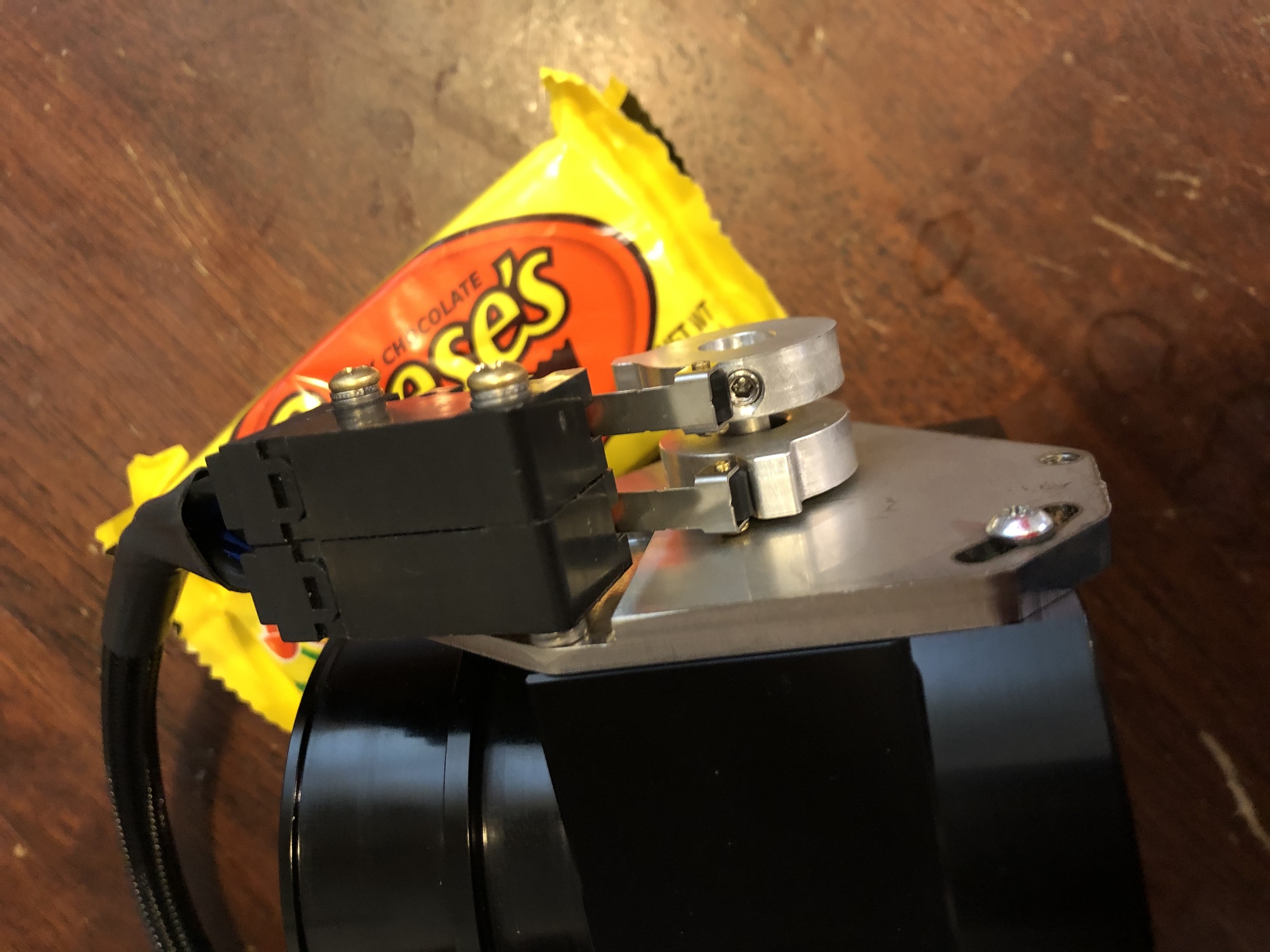

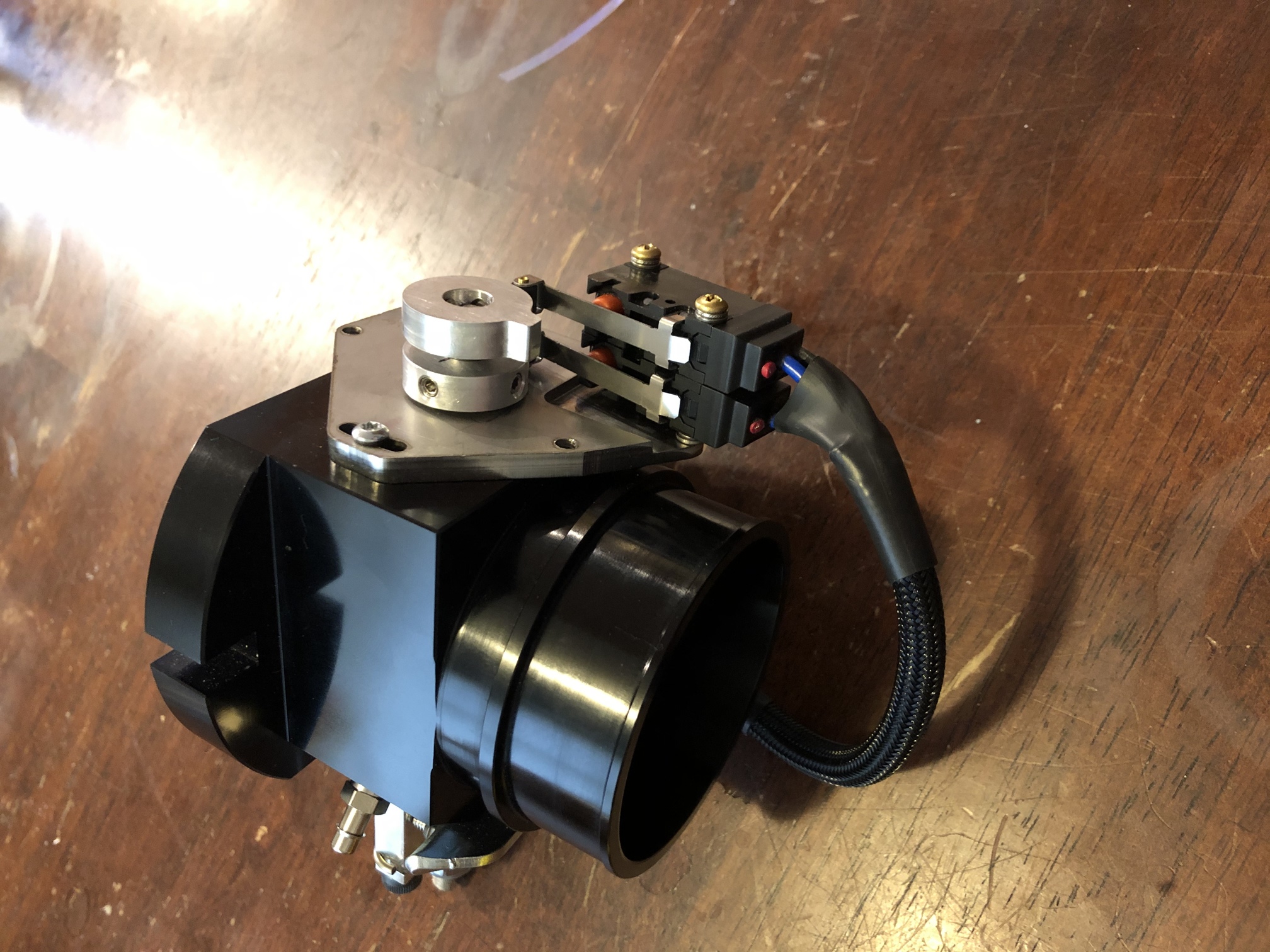

The GoWesty throttle body came like this, some kind of a cheap plastic cam printed from a 3d printer.
To make this work, I bought a 2nd switch, and stacked it on top. Also got rid of the 3d printed cam, and had two new ones made.
Lots of screwing around, but I'm hopeful that this setup will at least work as well as the original if not better. Bigger throttle plate, double sealed ball bearings, and the action is so much smoother than what I had.
