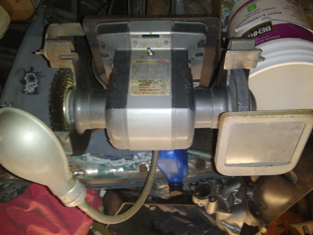

rgalla9146   All of the grinding was done with the bench grinde...   Oct 1 2016, 10:47 AM
