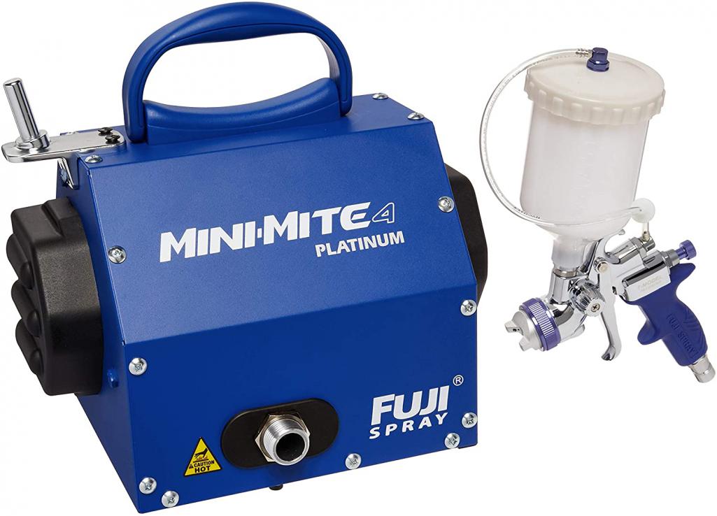

Just pulled the trigger on one of these. It's not cheap, but I'm looking forward to seeing how well it masks a newbie's lack of skill and knowledge. Some people suggest you can do a great job with the model below this, but I think Fuji recommends this one (or higher) for full car painting. I'll share my experiences.
Also. You have to breathe. I use a supplied air respirator. Another hose to drag around, but it doesn’t fog up. I await with bated breath.
