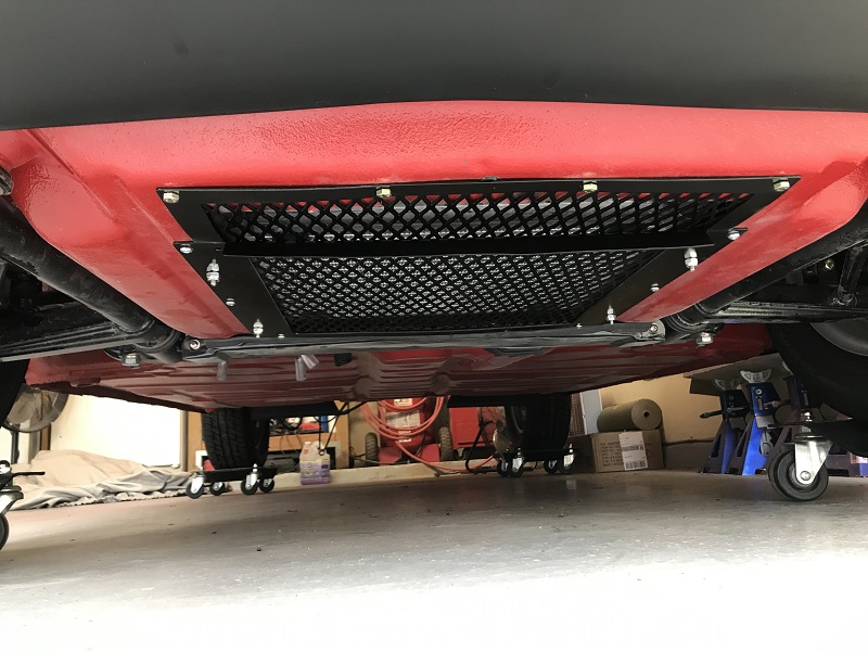

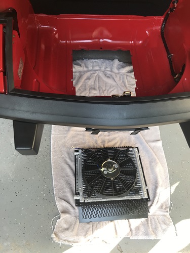

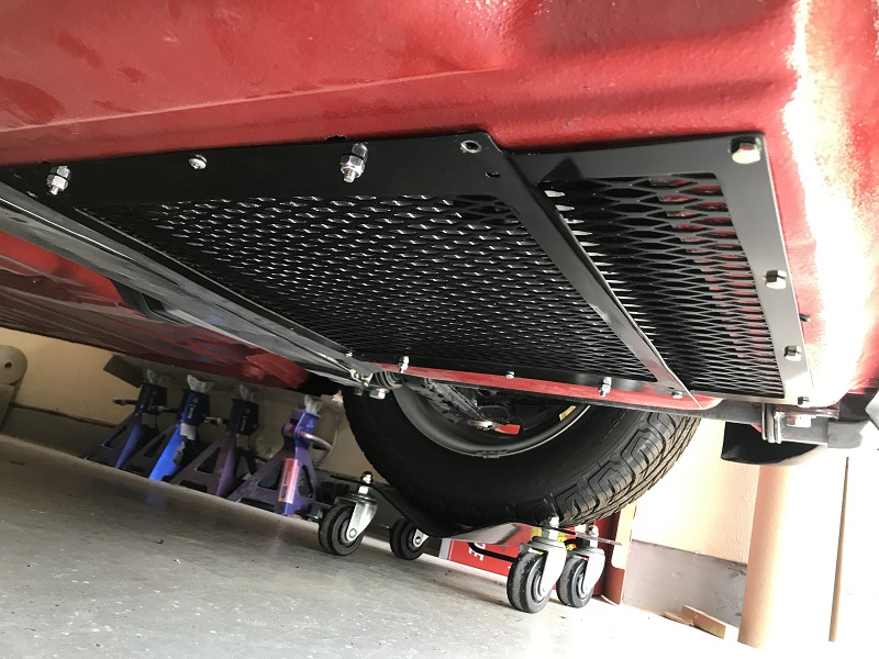

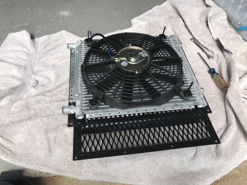

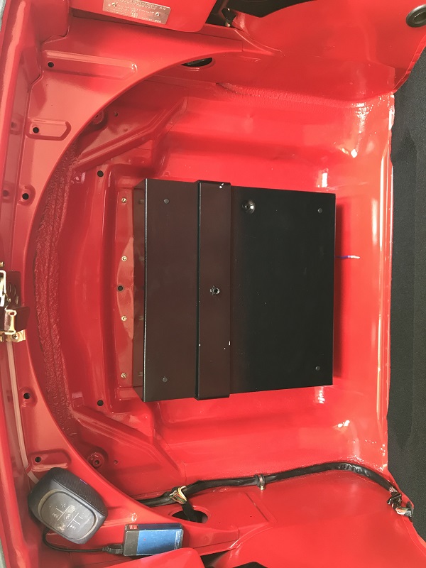

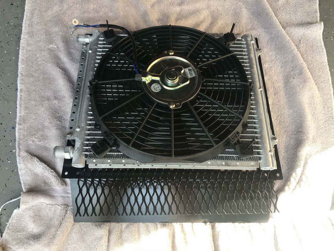

Condenser Install I think I mistakenly placed my previous photos on Doug's other commercial A/C thread. Go there to see my pre-fit photos. So, here we go! Here are my final install pics of my A/C Condenser unit on my '74. I had to make a last minute adjustment to the flipped down portion of the mounting cover (photos 2 and 3). My issue was that it just stuck down too low. If I hit a speed bump or something, the entire condenser would be ripped out of my trunk. I also wanted something to cover up the front portion of the grate. I satisfied both issues by pounding the metal bracket flat and then cutting out an inner rectangle - leaving enough to bend down a much smaller scoop.
DRPHIL914
post Apr 30 2021, 12:06 PM
Dr. Phil
Posts: 5,971
Joined: 9-December 09
From: Kennesaw, GA
Member No.: 11,106
QUOTE(friethmiller @ Apr 29 2021, 04:48 PM) *
thats pretty cool, nice clean install. are you using the electric compressor set up?
