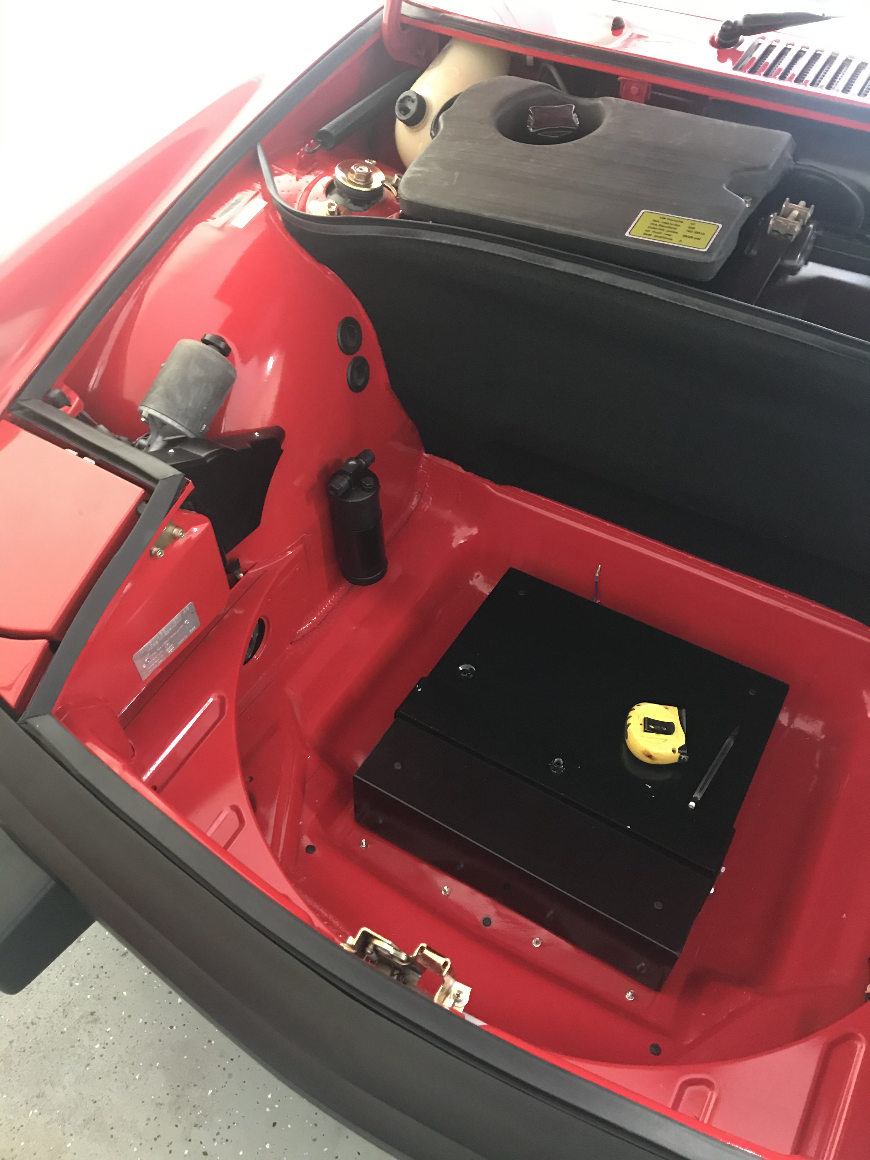

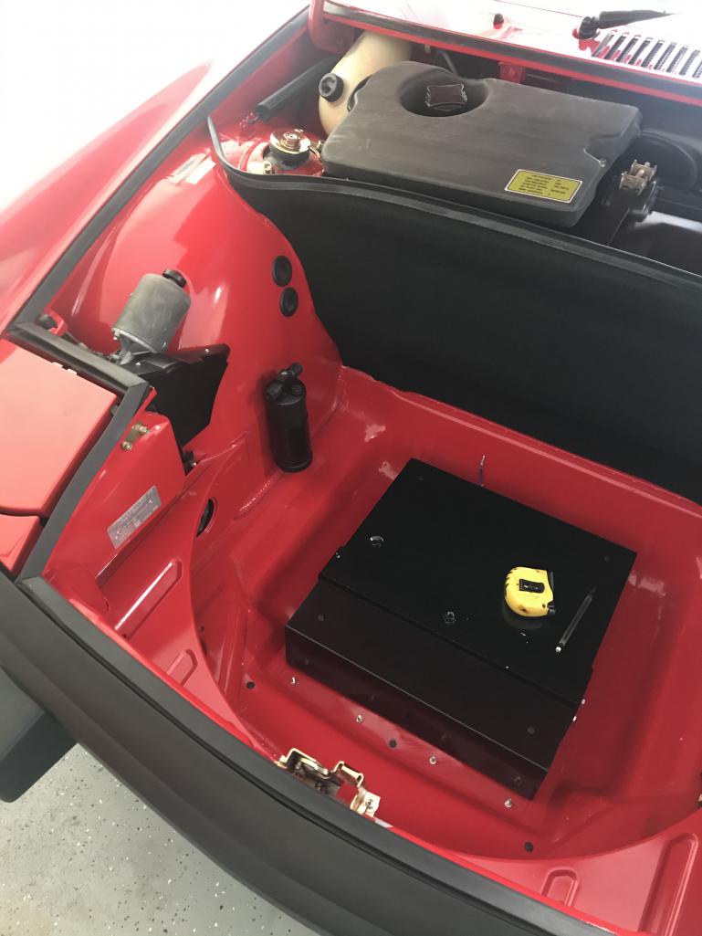

Thanks! Good comments here. I like the idea of extending the scoop with something less rigid. I have a Sanden 508 compressor that will be getting top mounted on the engine in the coming weeks. These parts all come with the A/C kit from Classic Auto Air. Photo of the dryer installed. Had to switch over to install the fuel pump and a few other items to move the engine along. More to come...

friethmiller   Condenser Install I think I mistakenly placed my ...   Apr 29 2021, 02:48 PM
DRPHIL914   Condenser Install I think I mistakenly placed my...   Apr 30 2021, 12:06 PM
DRPHIL914   Condenser Install I think I mistakenly placed my...   Apr 30 2021, 12:07 PM
Chris914n6   Condenser Install I think I mistakenly placed my...   Apr 30 2021, 03:35 PM
friethmiller   Thanks! Good comments here. I like the idea ...   May 3 2021, 08:43 AM
