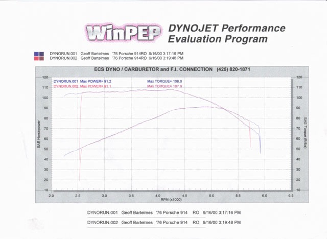

This is from 2000 when my 2.0L was stock with flat Euro pistons with SSI exchangers and a OEM banana muffler. 91HP and 107ftlbs of torque so I have always used this a baseline for a stock 2.0L.
I have always heard the 901 tranny loss was about 10% so add 9hp gives a HP rating of 100HP!
