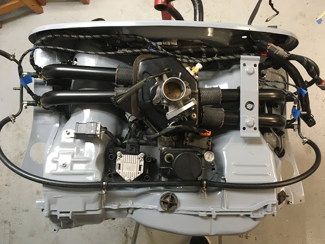

Microsquirt can be used wholly independantly of your ignition system.
But it is far better engine management if you leverage the MS for ignition as well as fuel injection. I use the VW IGN4 coil with wasted spark, controlled by the MS ECU and I have full control of spark timing through the whole range of RPM and manifold pressure. I have completely removed my distributor and plugged the hole.
Plus, I use spark advance/retard to improve warmup, and to fully control idle without an AAR/idle valve.
So if you like your 1-2-3 dizzy, you can keep your 1-2-3 dizzy. Hell, you could keep your stock dizzy if you wanted to. But it's better to use the MS.

https://tgadrivel.blogspot.com/2020/03/on-m...914-part-1.html
(IMG:http://www.914world.com/bbs2/uploads_offsite/1.bp.blogspot.com-15565-1620829384.1.jpg)

QUOTE(GregAmy @ May 12 2021, 07:23 AM) *
Great bedtime reading. Not for the TL;DR crowd.
Followed your advice and read the whole thing last night. Fantastic reading. Thanks! I haven't even test driven my freshly rebuilt 2L with 40IDFs yet but already fantasizing about Microsquirt. Sounds like it could be tuned to work with my carb cam?

QUOTE(bbrock @ May 13 2021, 06:08 PM) *
(IMG:style_emoticons/default/biggrin.gif) Thanks. I have to admire anyone that actually makes it through the thing; I'm not even sure I've read it all... (IMG:style_emoticons/default/wink.gif)
Absolutely. That's the great part about tunable EFI: it'll work with *anything*. It worked great with my D-Jet cam, and it's working great with FAT's cam.
And if you change the cam - or injectors, or heads, or valves, or whatever - just re-tune to optimize. Hell, just drive it around and, as with Russia, it will tell YOU where to make changes (I tried plugging the USB cable into my racer's Dellorto-equipped engine, and it pretty made farting noises at me...) - GA
