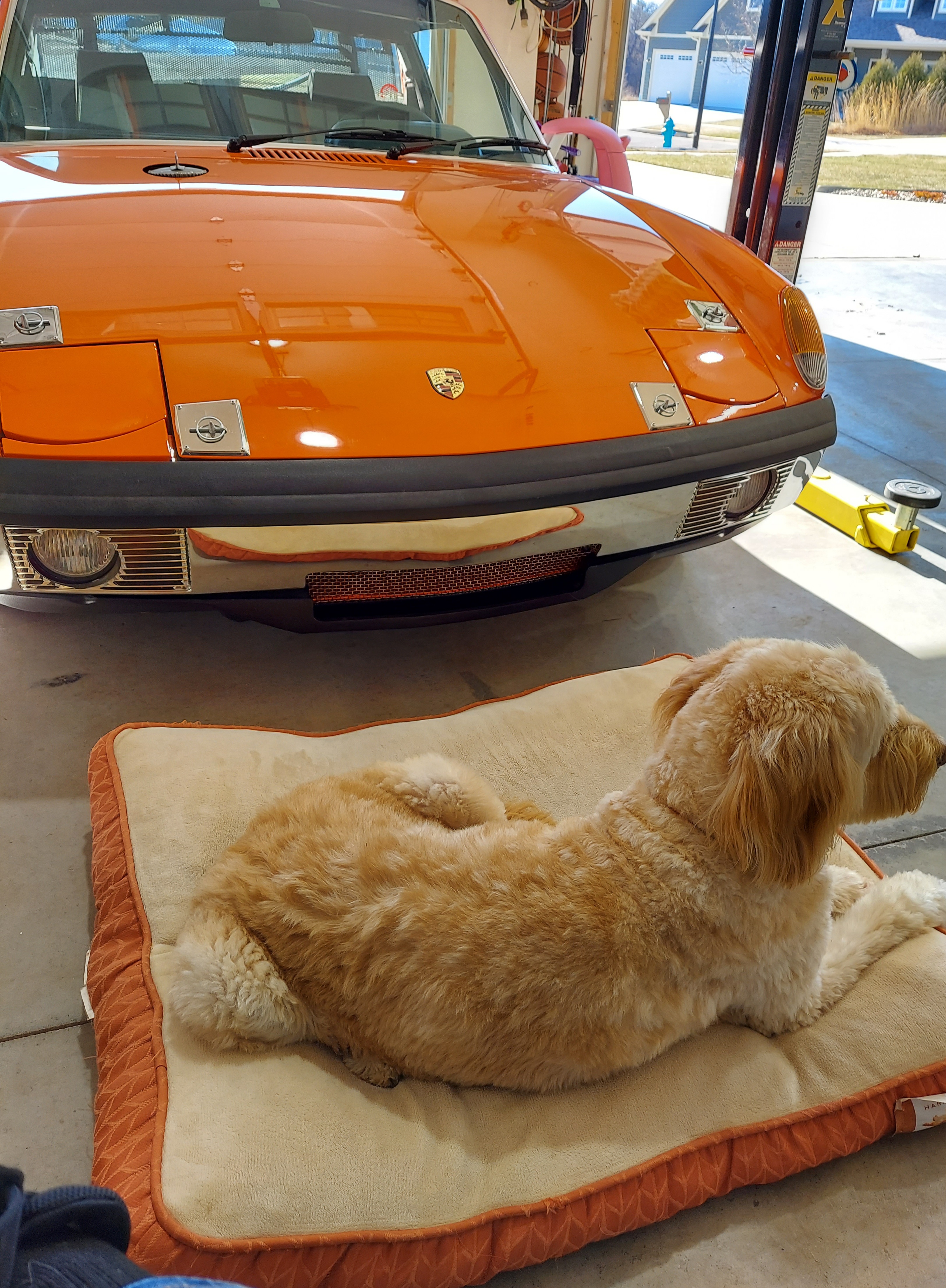

Here is how mine turned out. Attached Image

Your car is beautiful Ben, great shot with a happy pup.
