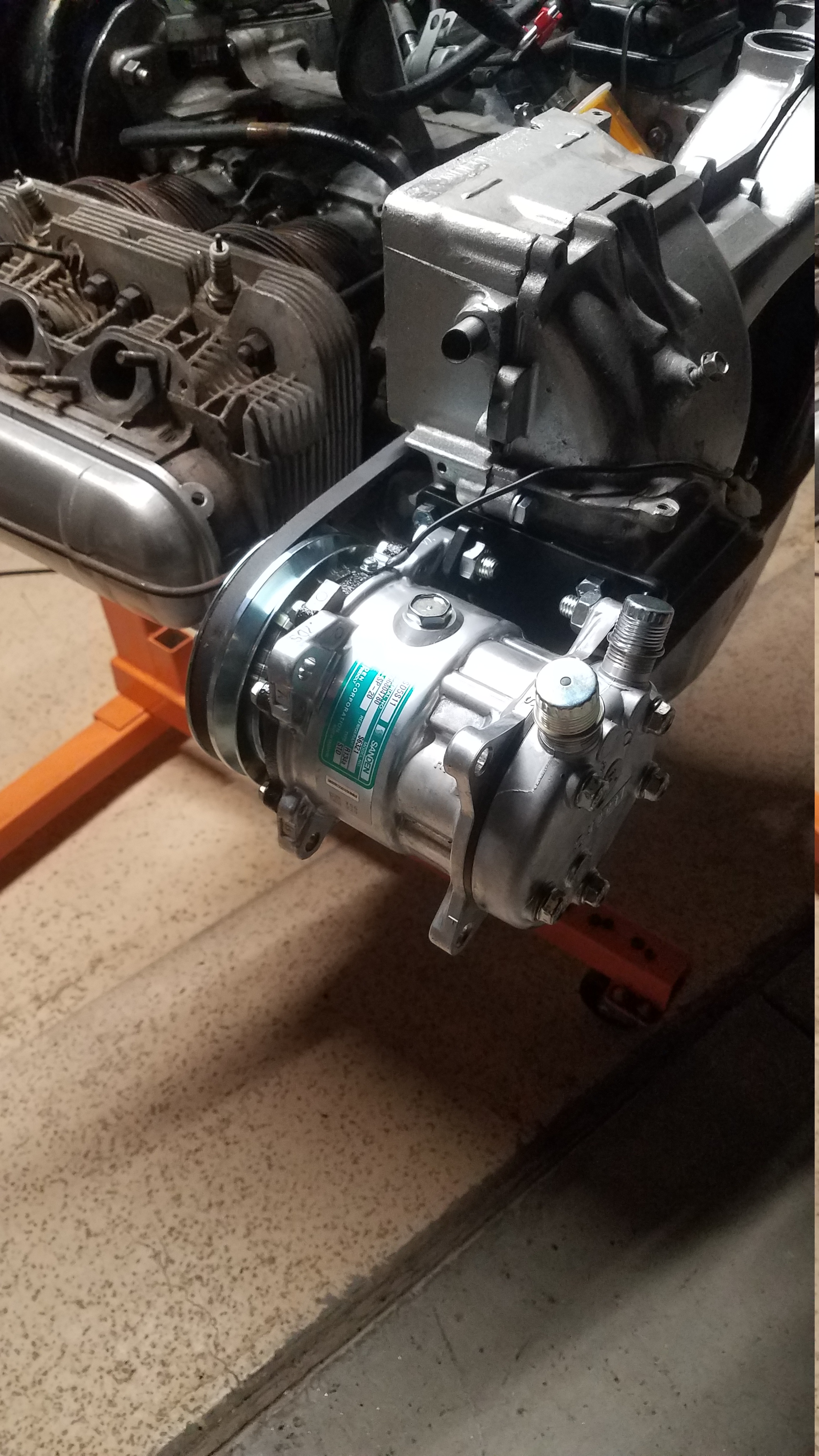

With the advances in modern compressors, condensers, and fans I decided to try an installation with the condenser mounted to the underside of a GT style engine lid.
In addition to the original style under dash evaporator, I am using a Sanden sd5h11 6333 compressor. It is the modern equivalent of the SD507 and is designed to use R-134a. I will be mounting it to the passenger side of the engine with amount plate I got from Gilmore Enterprises out of Las Vegas. Their website (gilmore-enterprises.net) doesn't list parts for the 914 or any individual parts but Ed, the owner is super easy to deal with. I called him up, told him what I was looking for, and it was on the truck heading out to me later that day.
I picked a universal fit parallel flow 11" X 21" condenser and 2 high flow, low profile 10" fans and a drier with a trinary switch.

Did Gilmore ship you the pulley and belt too? That pulley looks larger than the factory one which will turn the compressor better. I think that condenser will be fine. If its not you can buy a larger one, they are fairly cheap.
Yes, I got the pulley and belt from Gilmore. Ed was really easy to work with.
I started doing some test fitting so I know how much I have to trim the engine tins.
