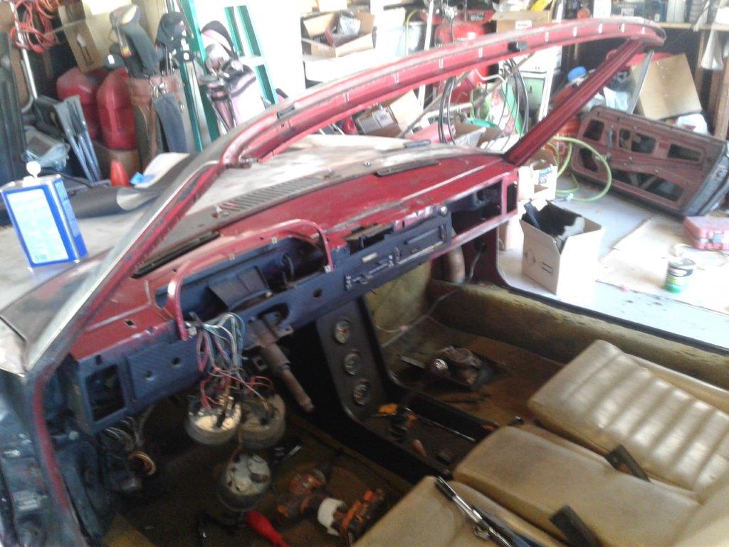

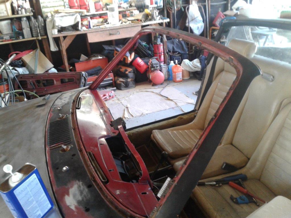

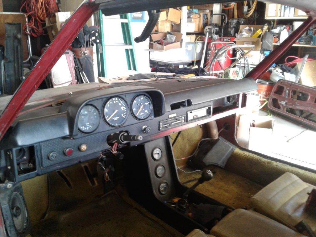

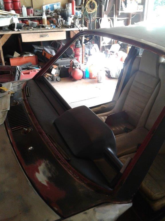

I just did mine this weekend,Attached Image Attached ImageAttached ImageAttached Image

mitchdiego1   I just did mine this weekend,   Jun 14 2021, 02:36 PM
