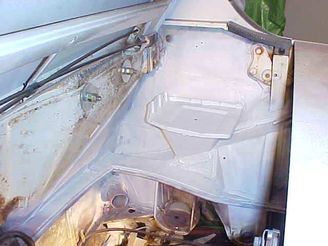

I'm repairing the battery tray and related hot spot. (IMG:http://www.914world.com/bbs2/html/emoticons/unsure.gif)
I need your tech advice on the procedure.
I want to first make paper templates and then fit the sheet metal. Maybe hang it with rivets or screws before the big weld off.
Stock look is not important to me. Just needs to drain and support the new battery tray and pedestal.
I will sand off the remaining surface rust before applying rust converting primer. I'm scratching the naval jelly approach.
Also, please post pics of your repaired areas.
Here's my project.
Thanks, as usual! (IMG:http://www.914world.com/bbs2/html/emoticons/clap.gif)
KT

Done! (IMG:http://www.914world.com/bbs2/html/emoticons/wub.gif)
KT

airsix   In the picture below I've marked off the piece...   Dec 30 2004, 12:46 AM

airsix   Let me elaborate a little on my 'beat to fit...   Dec 30 2004, 12:50 PM

trekkor   Good things are happening http://ww...   Dec 30 2004, 07:26 PM
trekkor   Painted with rust converting primer. http://www.914world.com/b...   Dec 30 2004, 07:36 PM
trekkor   http://www.914world.com/bbs2/ht...   Dec 30 2004, 09:16 PM

trekkor   Done! http://www.914world.co...   Dec 31 2004, 08:14 PM
DJsRepS   What are the two big bolts through the cab firewal...   Jan 1 2005, 06:36 AM
greg.treadway   Finally a repro piece. Whew!! Are the bolt...   Jan 1 2005, 02:08 PM
markb   Nicely done! http://www.91...   Jan 1 2005, 02:51 PM
Engman   Nicely done! Proof positive that you CAN make...   Jan 1 2005, 03:29 PM
Gint   Looks great Trekkor! Get that 6 in there!   Jan 1 2005, 05:58 PM
McMark   The bolts are for a 5 point harness.   Jan 1 2005, 06:15 PM
