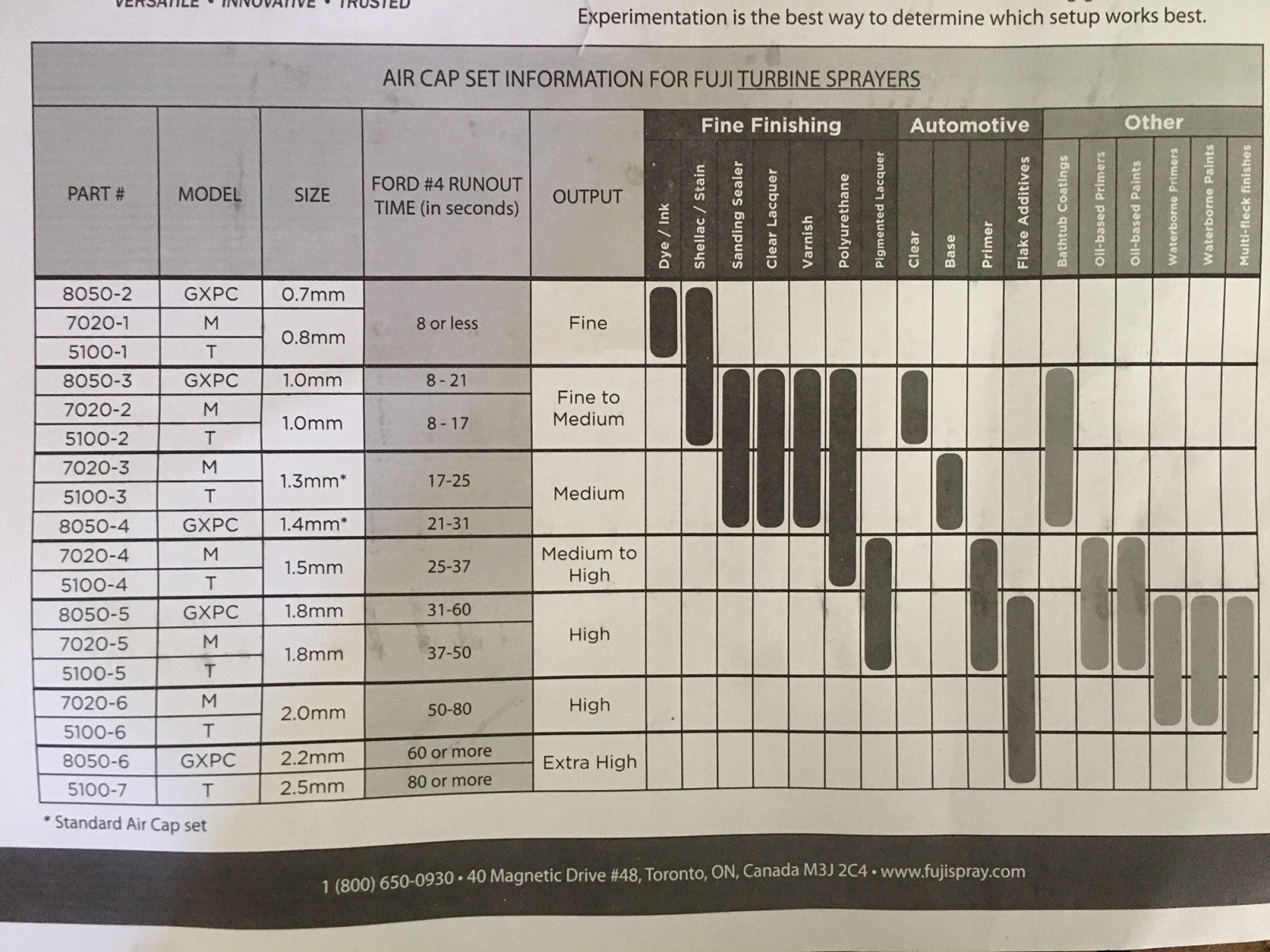

So I ended up buying that Fuji mini mite 4 platinum as shown in the pic. It was super easy to setup, and, when the time came, to clean.

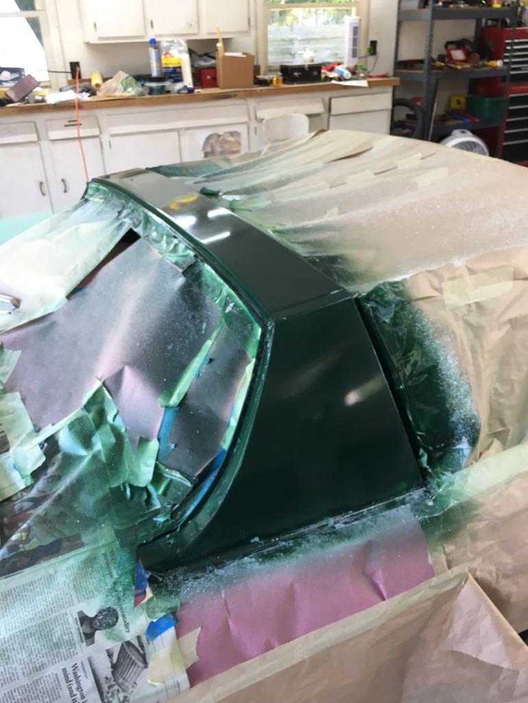

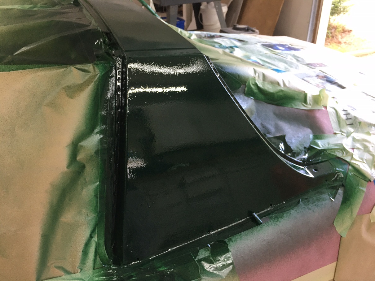

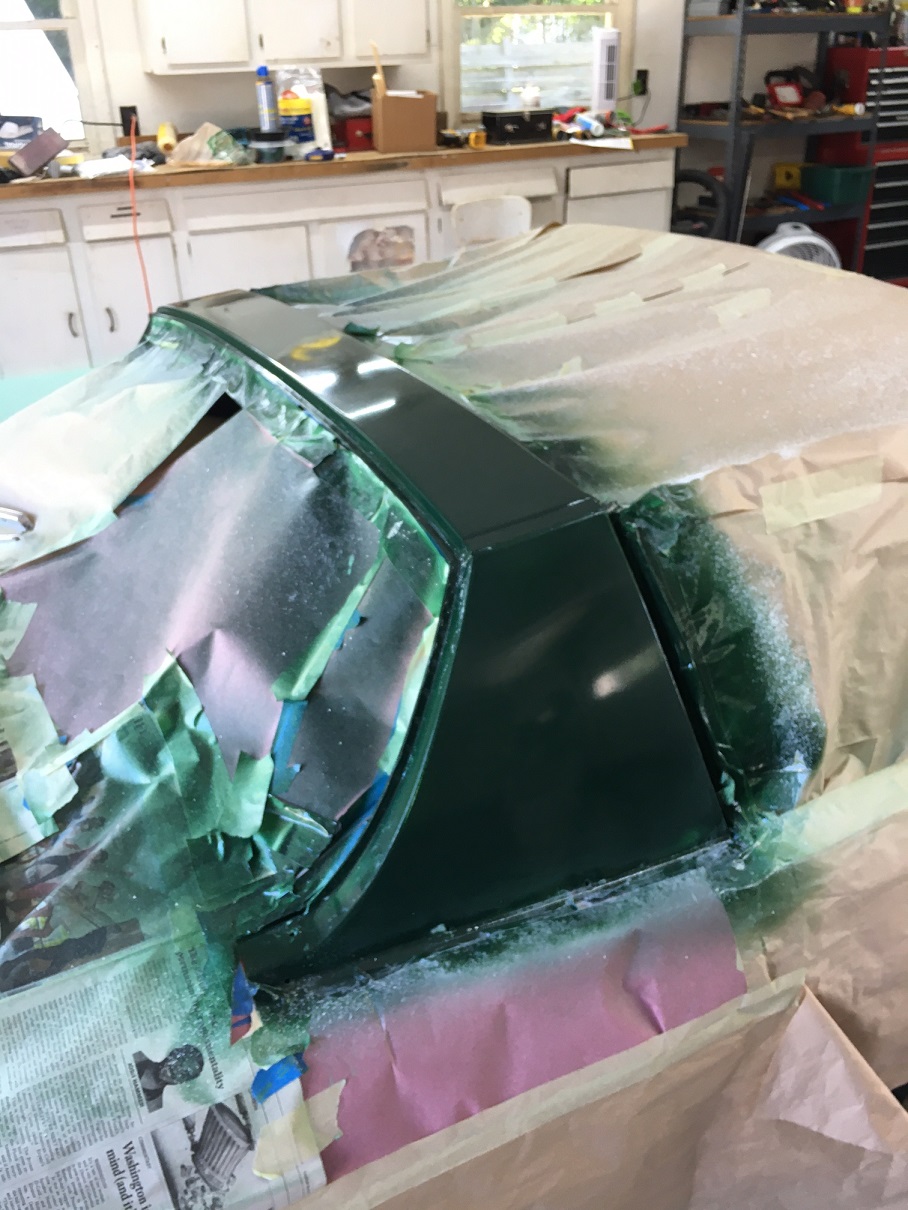

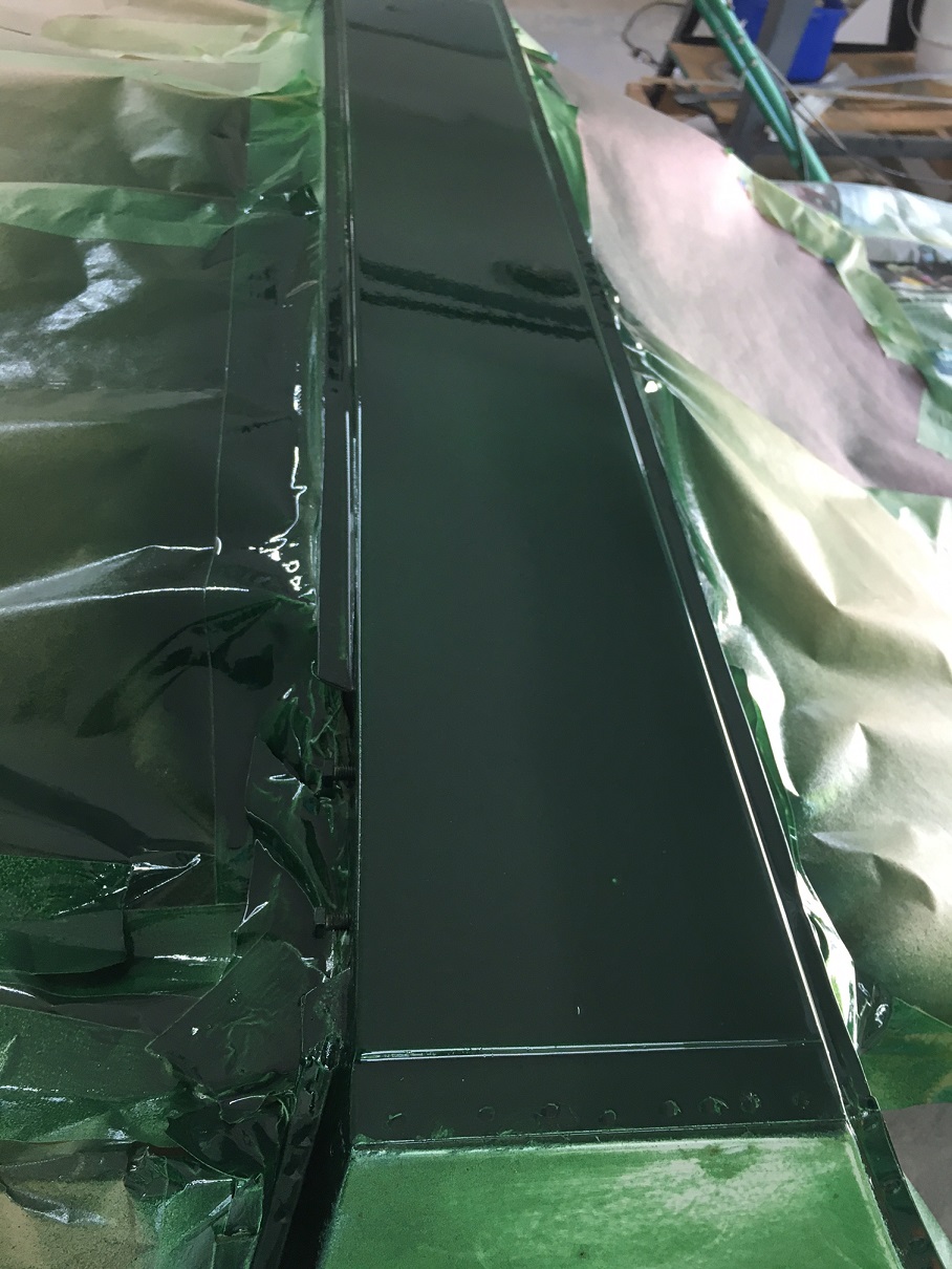

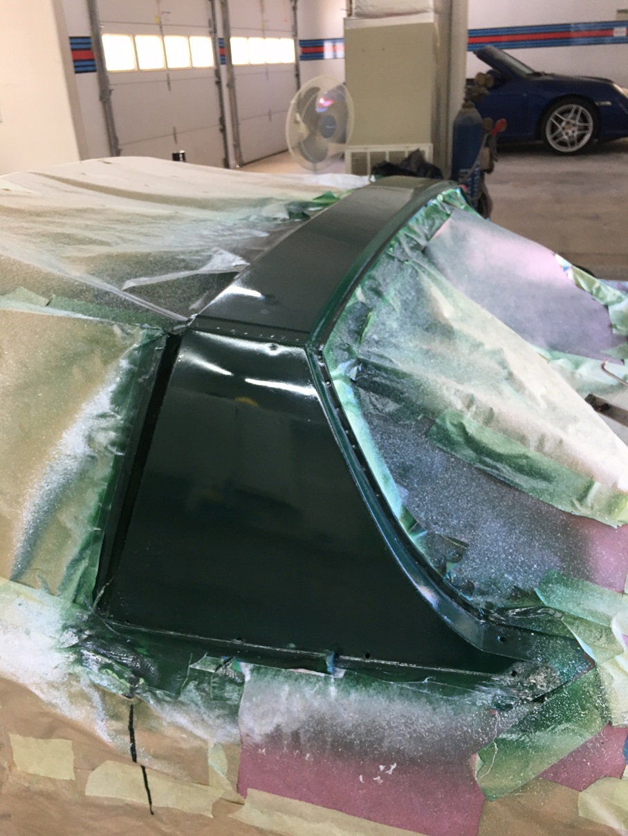

First thing I noticed was that I didn't get the paint thick enough initially. The guy at the store told me to mix it 4 to 1 (paint and reducer), which I did. I also told him I need a slow-drying reducer, which is what is recommended for turbine sprayers. The paint ended up too thin and I ended up with runs on the sail panel. The next time I actually used the Ford #4 cup that comes with the sprayer to test viscosity, and that's when I realized I needed significantly less reducer. Mistake #1.
Mistake #2 was initially trying to correct the runs by reducing airflow, which I now understand is the last adjustment that should be used. You want airflow for complete atomization of paint. I should have been a) using correct viscosity/mixture as noted above, and b) using paint flow adjustment before air flow adjustment. You can see some orange peel in the pics below, particularly on sail panel.
Mistake #3 (and 4, and 5, and 6, etc., etc.) was simply technique. I practiced on some sheet metal I had. Naturally some of the best paint I laid down is now on that scrap sheet metal (IMG:style_emoticons/default/smile.gif) I found painting the rollbar a challenge as it's hard to reach over and get a consistent angle of attack and motion on something that goes across the whole car. The sail panels were easier, naturally, but then I was dealing with the fact that I bollocksed them up the first time with too thin of paint and had to clean off the runs with solvent. That left a surface that was less than ideal for the second attempt.
After a bunch of sanding and attempts at paint correction I was pretty happy with the overall results in the sense that I learned quite a bit, it looks much better than it did, and the new sail panel vinyl looks great and covers up my mistakes anyway (IMG:style_emoticons/default/biggrin.gif)
Bottom line: I like this setup a LOT and I'm looking forward to trying again. It just won't happen until I'm ready to tackle the whole enchilada.
Here are some random pics of the pain on the car, just for viewing pleasure. Again, not even sure what order these are in from raw paint to post-paint correction attempt.

@BeatNavy Looks great... i mean, you can always sand the orange peel out of the clear anyway, right? (IMG:style_emoticons/default/biggrin.gif)
What size air cap did you use? It seems like they come with a 1.3mm, which is fine for primer, but the 1mm or 0.8 is better for base/clear?

Yeah, I mean some of it came out really nice actually. I think I could have laid more paint down on some of it to give myself more chance for polishing / paint correction, but I am pretty happy with this setup's potential (once the operator gains at least a little experience).
Another benefit I didn't mention previously: it could be the paint I used, or more likely it's the minimal overspray, but the garage just smelled better. With my old paint / preval sprayers (which are absolutely horrible, don't get me wrong), the whole garage would smell toxic for an hour or more. With this thing I almost felt like I didn't need the respirator - no mistake, I definitely wore it, but there was nowhere near the overpowering smell of chemicals I was used to before. Oh the wasted brain cells.... (IMG:style_emoticons/default/blink.gif)
It comes with the 1.3 needle / air cap, but you can definitely buy the others. According to the chart they provide (below), that's right in there for auto base color paint application. For primers, especially epoxy stuff, you need to go larger. As mentioned, one of my mistakes initially was reducing 1 to 4 (as instructed by retailer). I should have gone by the Ford #4 runout cup (supplied) time as in the chart below.
