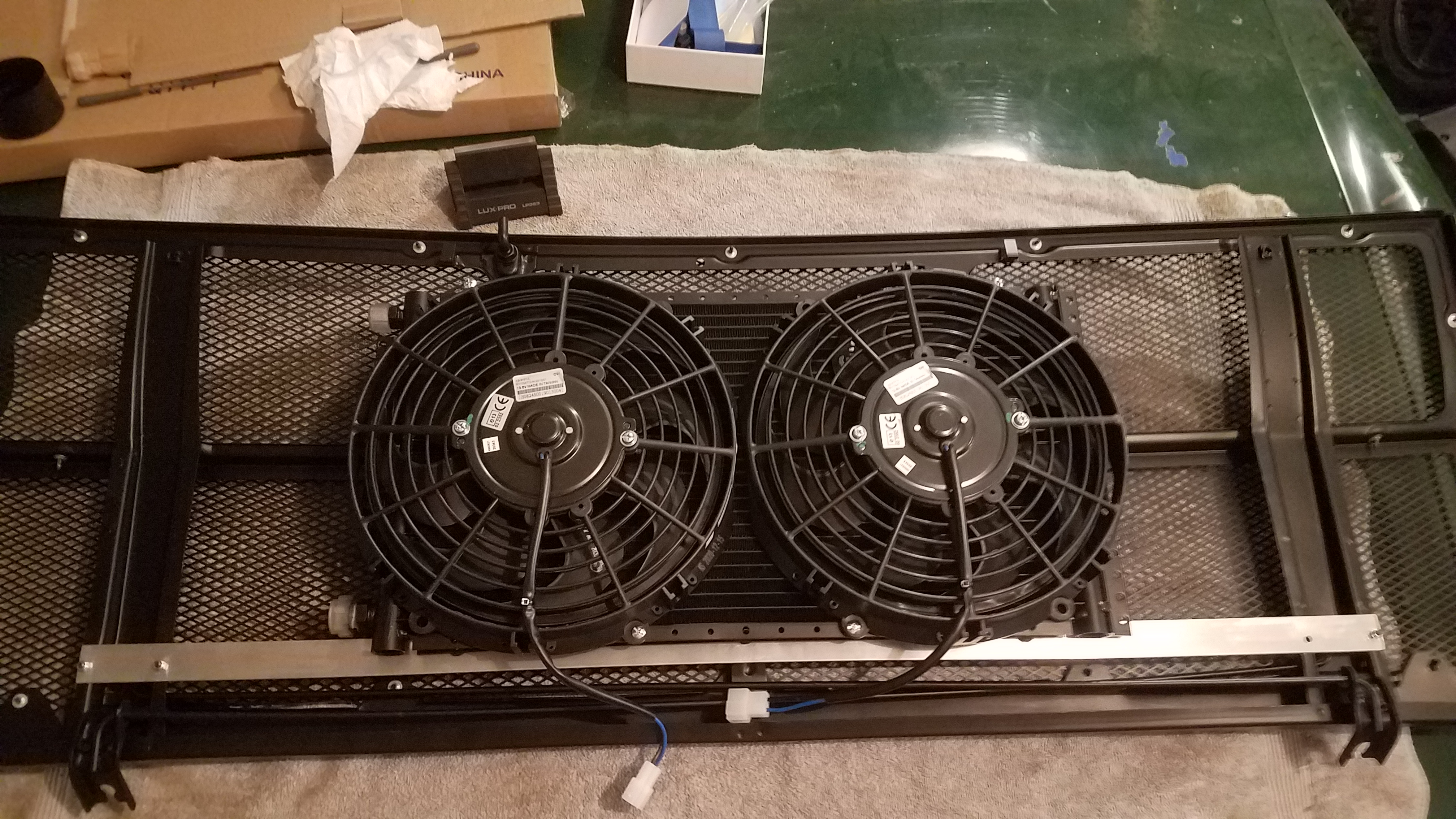

Getting close.
I just need some additional spacers so the condenser is at an angle. Parallel flow condensers pool the oil if they aren't angled down. Big port on the top, small port on the bottom.
I am trying to decide if I want to paint the support bar black or leave it raw aluminum for a little bit of silver under the grill. You can see it a bit in the previous picture.

I really like what you're doing and have high expectations for my car.
@Mark Henry has a challenge to achieve. Mine will be practice for his -6. (IMG:style_emoticons/default/smile.gif)
Everything under the grill should be flat black. No one should see it or know it's there.
QUOTE(AZBanks @ Jun 15 2021, 05:58 PM) *
Getting close.
I am trying to decide is I want to paint the support bar black or leave it raw aluminum for a little bit of silver under the grill. You can see it a bit in the previous picture.
