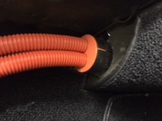

@azbanks This might help you avoid drilling holes in the chassis for the refrigerant lines, if you are willing to give up some of the heat. In my car I ran the battery cables down the heater tubes. Then we 3d printed end caps to support the cables.

This won't work for Warren's build, as he wants heat as well and just bought brand spanking new SSI's. I hope the compressor doesn't interfere with the heat valves, etc. plumbing.
I'm wondering how I'll run the lines to the dash but that's something I'll worry about when I get that far along.
