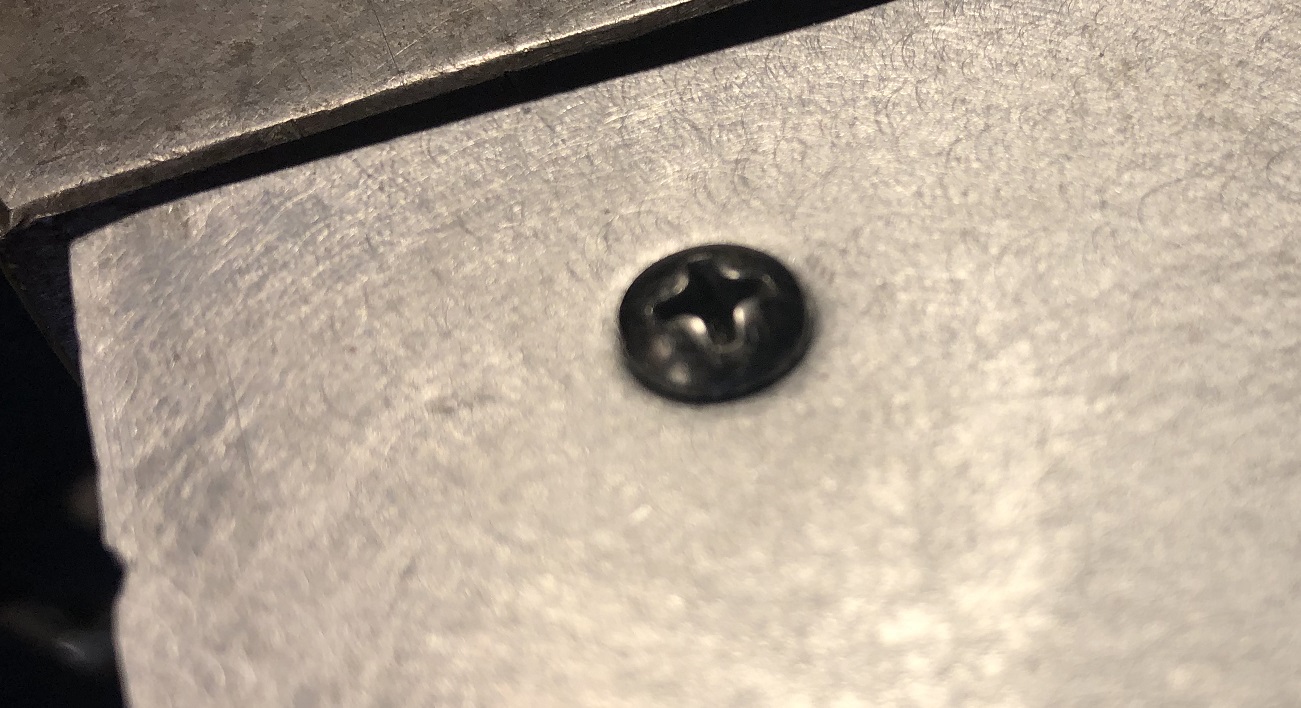

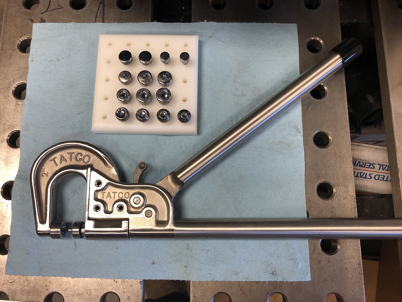

When you're a tool whore like me, you look for any reason/excuse for more shop goodies!
Since I'm making a few of these gauge panels for others, I simply couldn't deliver them without duplicating the stock panel's screw dimples.
So I treated myself to a Tatco hand squeezer with a rivet and dimple die set.
1. Drill an appropriate hole
2. Select the desired die
3. Position the die in the hole (orientation matters!)
4. SQUEEZE!
A dimple is created and the factory fastener sits just like we'd want it to. It's the little details like this that I really like.
It's great having the right tool for the job and now that I have it, I'll wrap up the gauge panels for those who've asked for one.
