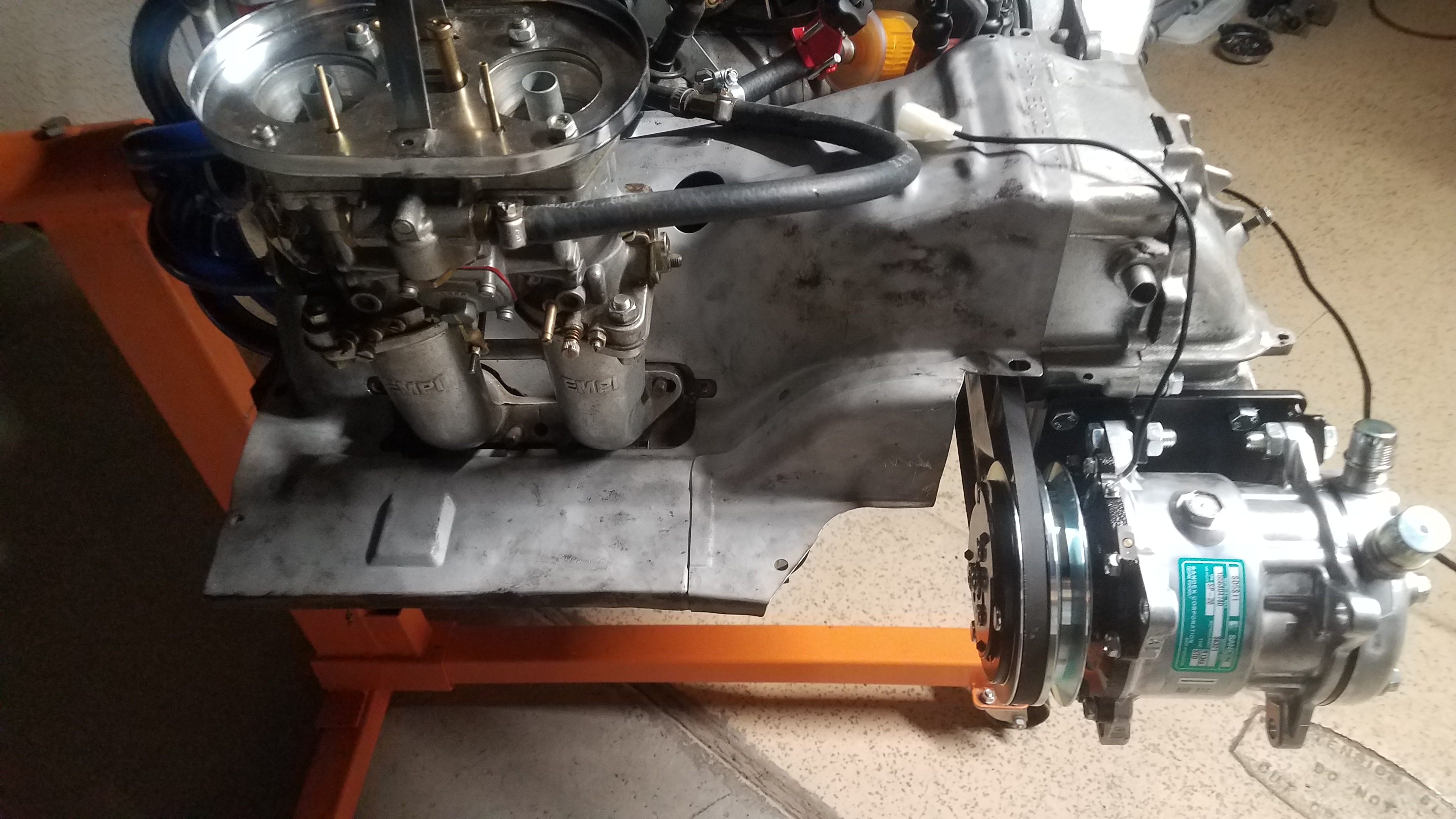

This is a total experiment based on other AC threads here and on the bird and based on systems and guess-timats from other cars. I made some of my guess-timats based on parts and sizes from my 1990 944 S2 Cab. The cabin of the 94 is a bit smaller than the 944 cab so parts that can cool the 944 should be about the right size to cool the cabin of the 914.
As I said, the 1.8 liter engine came to me with an OLD York compressor. I did not want to use that massive HP hog. There was a decent pulley mounted behind the fan but it is also a heavy piece of steel.
I bought an original dealer installed style AC system a few years ago from some one either here or on the bird board(I don't remember which and it doesn't really matter at this point). I bought it mainly for the under-dash evaporator and the controls.
The NARP never had AC so it is not hacked up. It has 99 problems but ragged holes in the body and front trunk for AC aren't any of them.
The engine tin on the passenger side of the 1.8 is hacked up and bent up pretty bad. I should have taken pictures before I started cleaning it up. I am going to finish cleaning it up and paint it. I don't want to hack up the good tin that was on the 1.7. I'll save that and hack it up for my next project.
(IMG:style_emoticons/default/sawzall-smiley.gif)

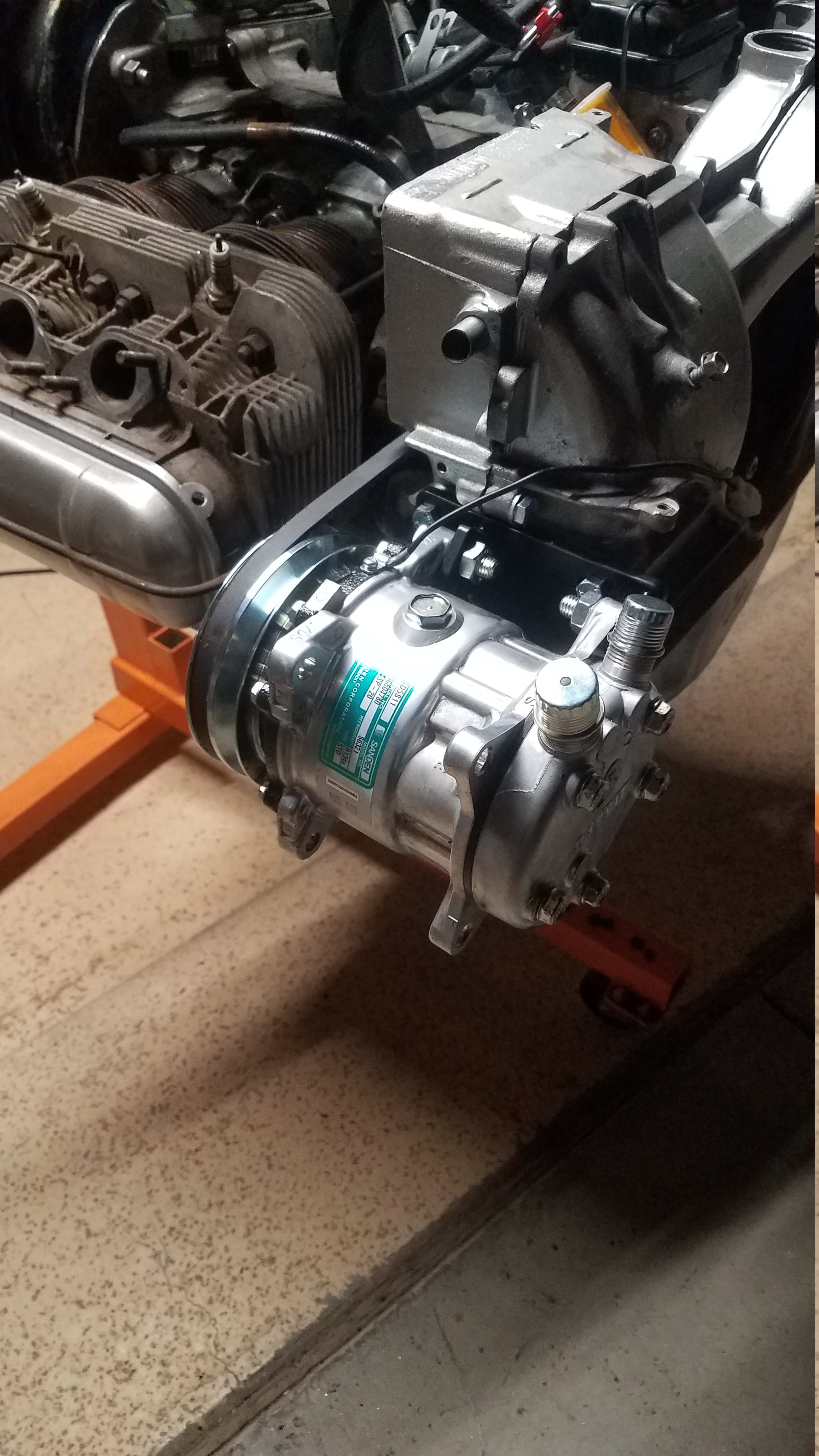

With the advances in modern compressors, condensers, and fans I decided to try an installation with the condenser mounted to the underside of a GT style engine lid.
In addition to the original style under dash evaporator, I am using a Sanden sd5h11 6333 compressor. It is the modern equivalent of the SD507 and is designed to use R-134a. I will be mounting it to the passenger side of the engine with amount plate I got from Gilmore Enterprises out of Las Vegas. Their website (gilmore-enterprises.net) doesn't list parts for the 914 or any individual parts but Ed, the owner is super easy to deal with. I called him up, told him what I was looking for, and it was on the truck heading out to me later that day.
I picked a universal fit parallel flow 11" X 21" condenser and 2 high flow, low profile 10" fans and a drier with a trinary switch.

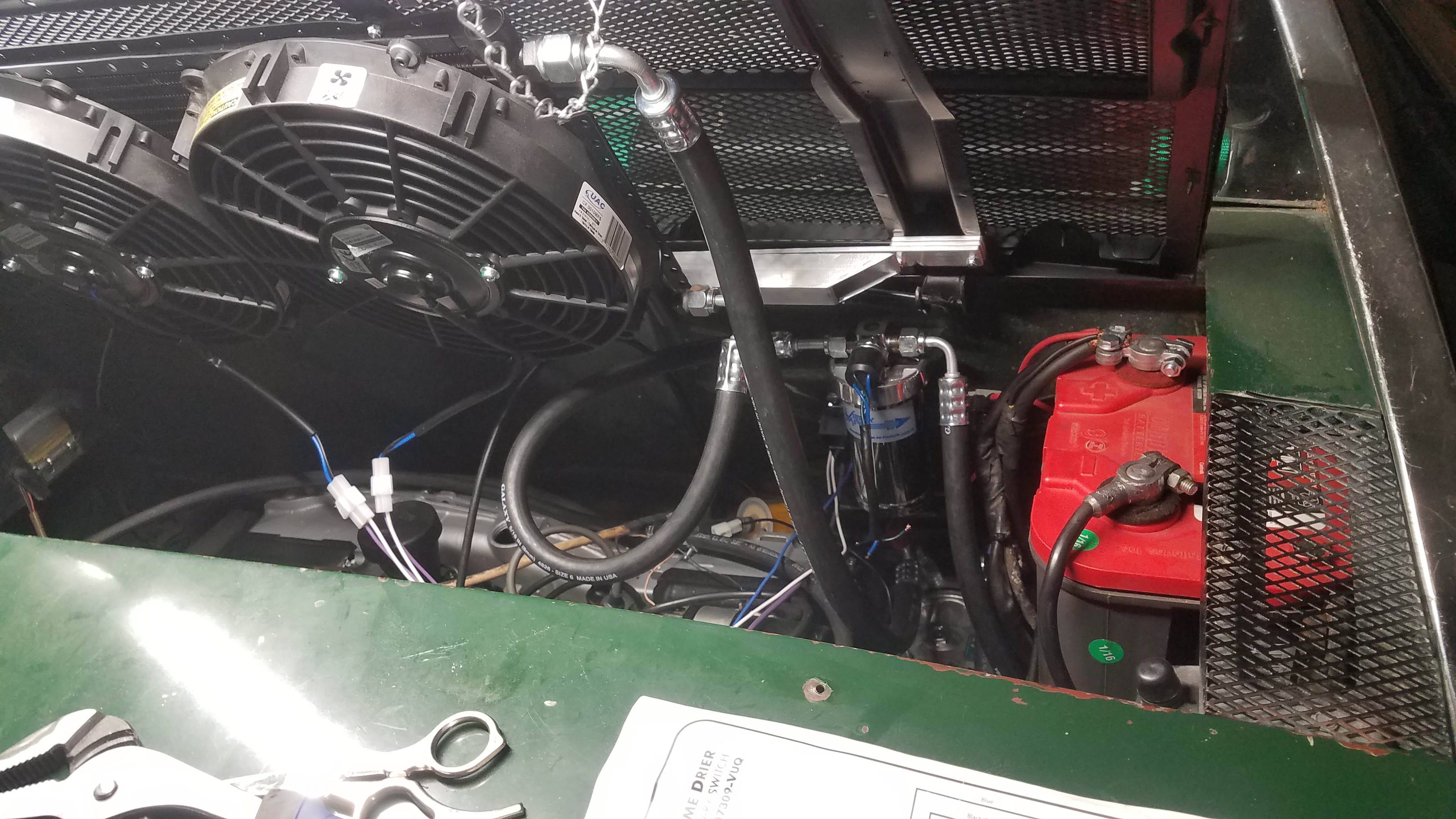

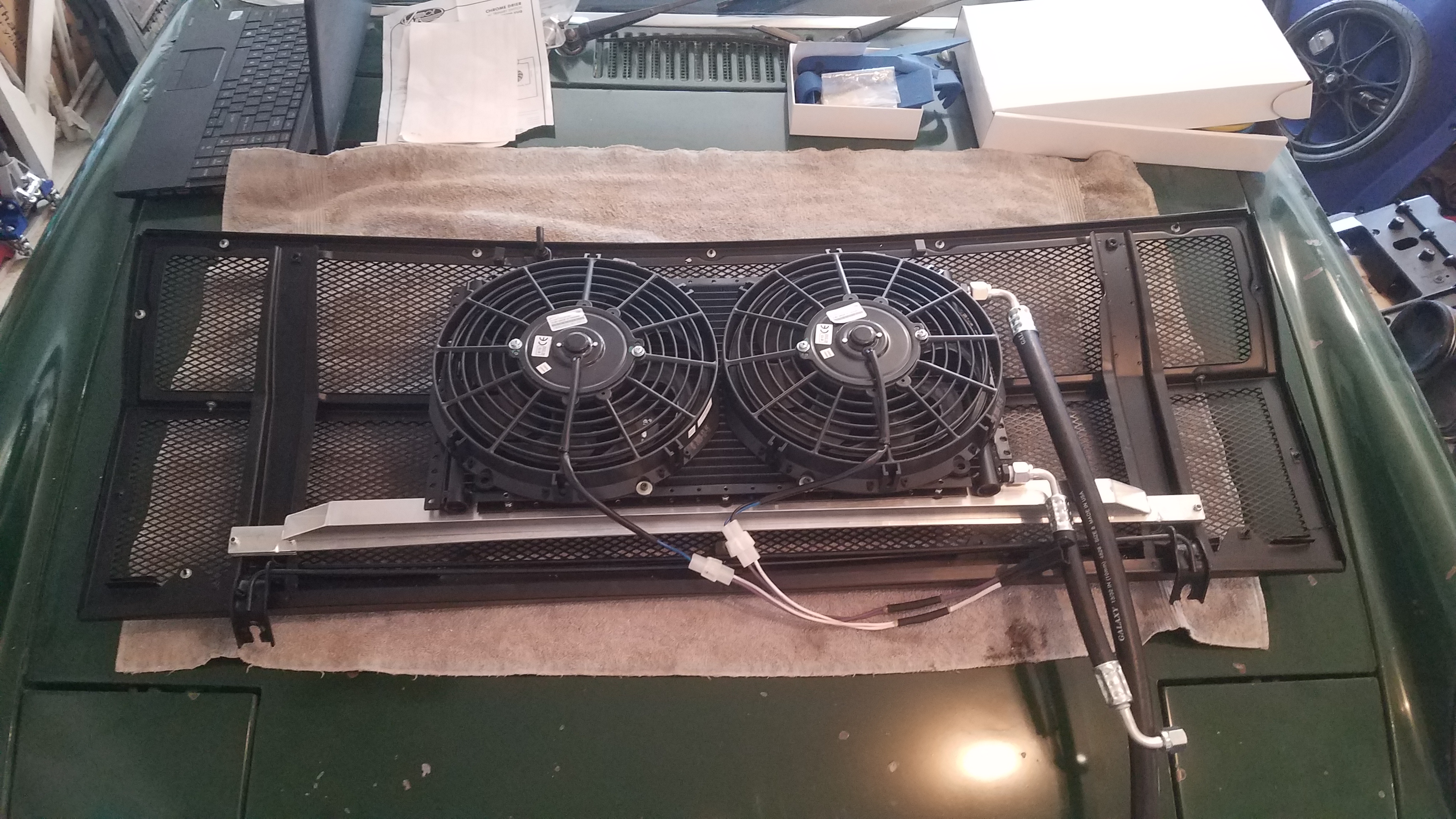

Here is the finished lid(at least finished for the near future) The exit hose has changed from what is in this picture. I had to experiment with several hose/connection setups before I found on that will work with the lid open and closed.

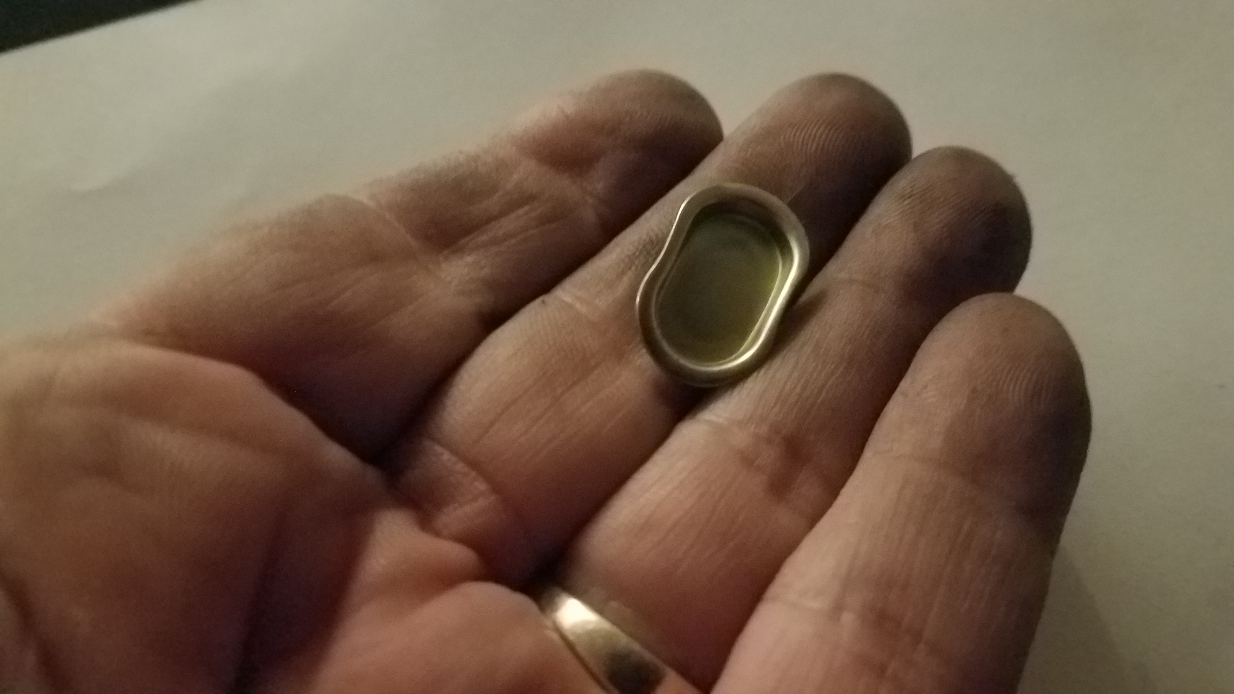

AZBanks   Does anyone know what this is, It fell off the eng...   Jun 8 2021, 09:17 PM
nditiz1   Looks like the side cover plate from a distributor...   Jun 9 2021, 05:19 AM

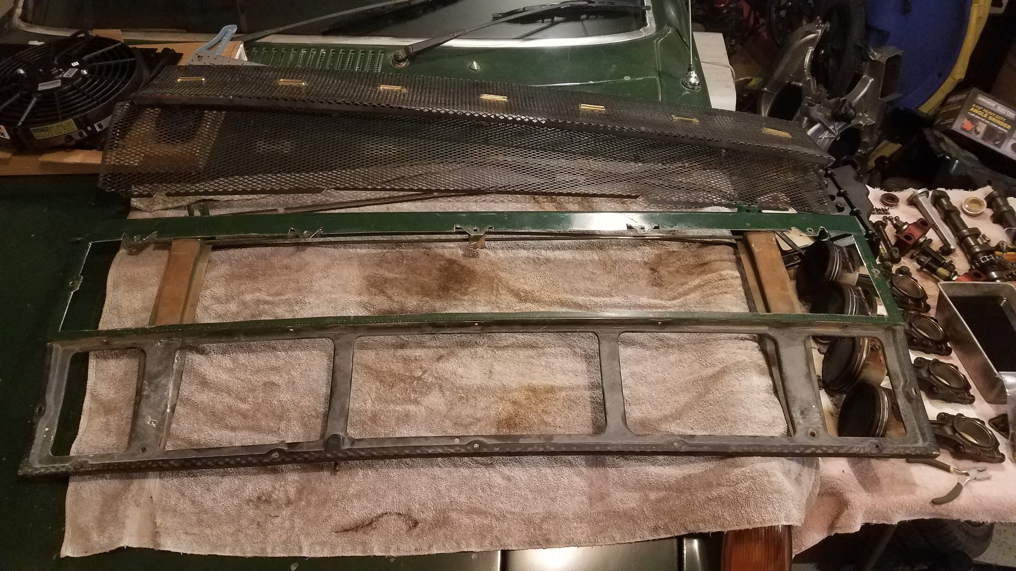

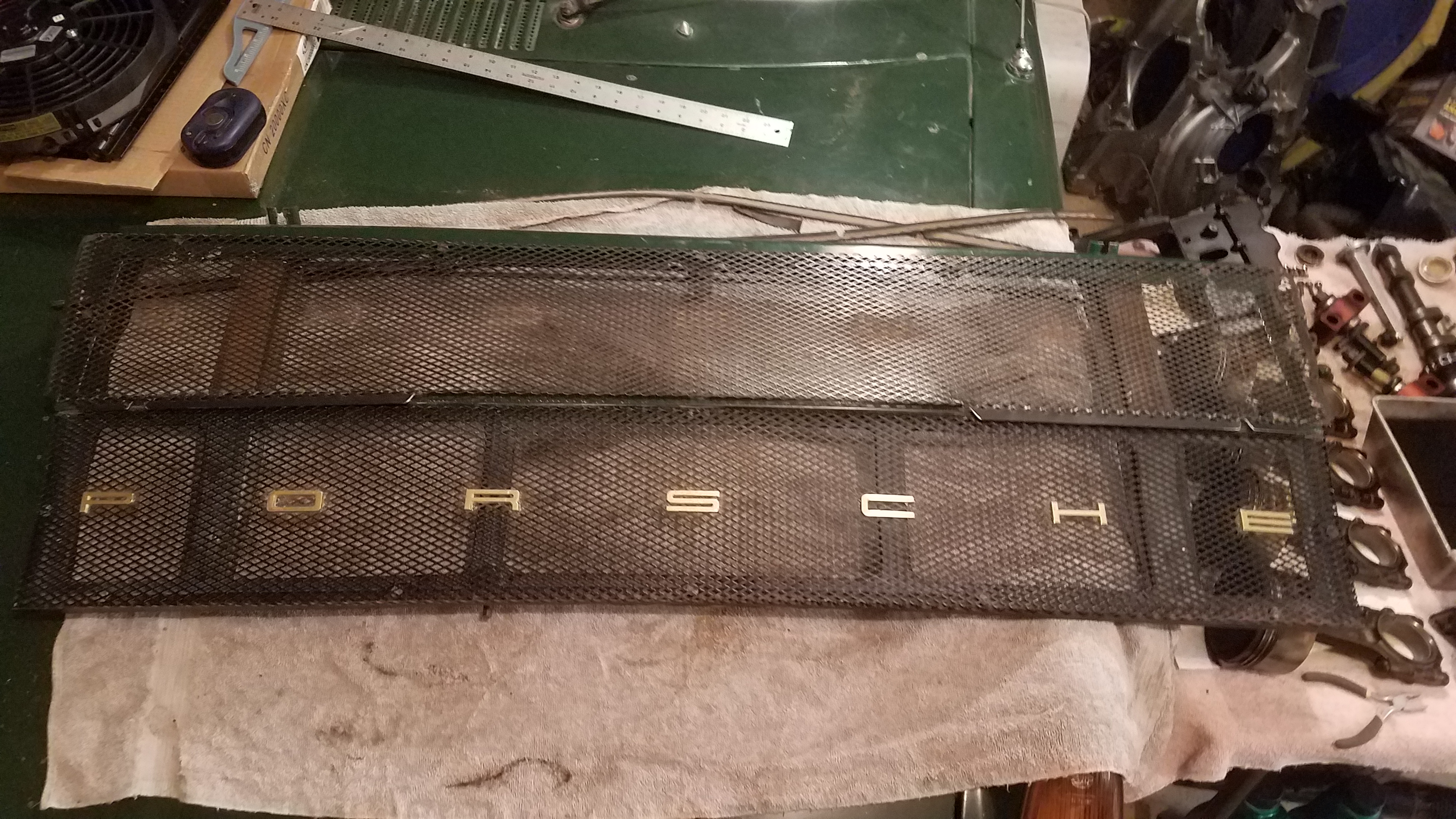

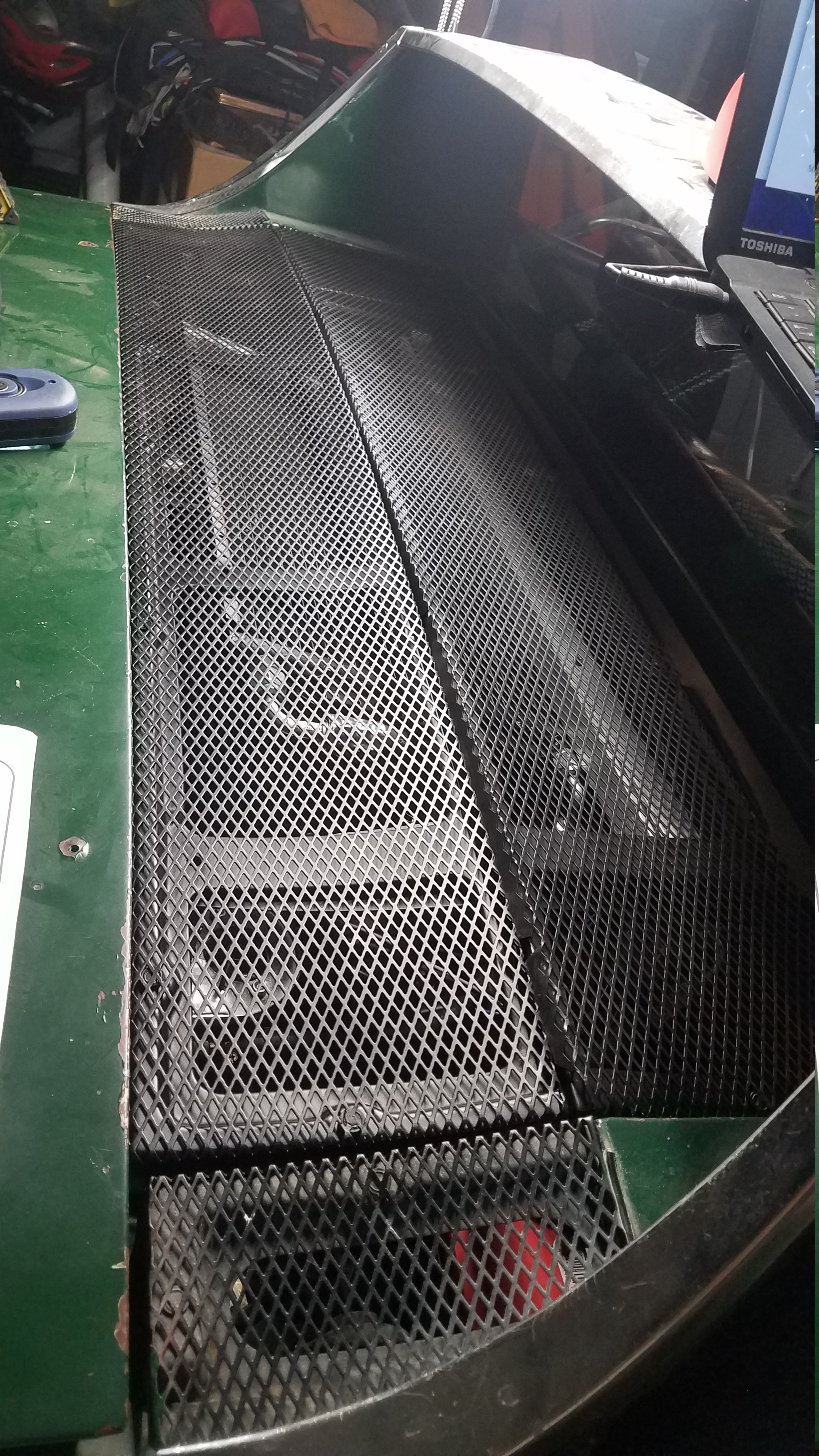

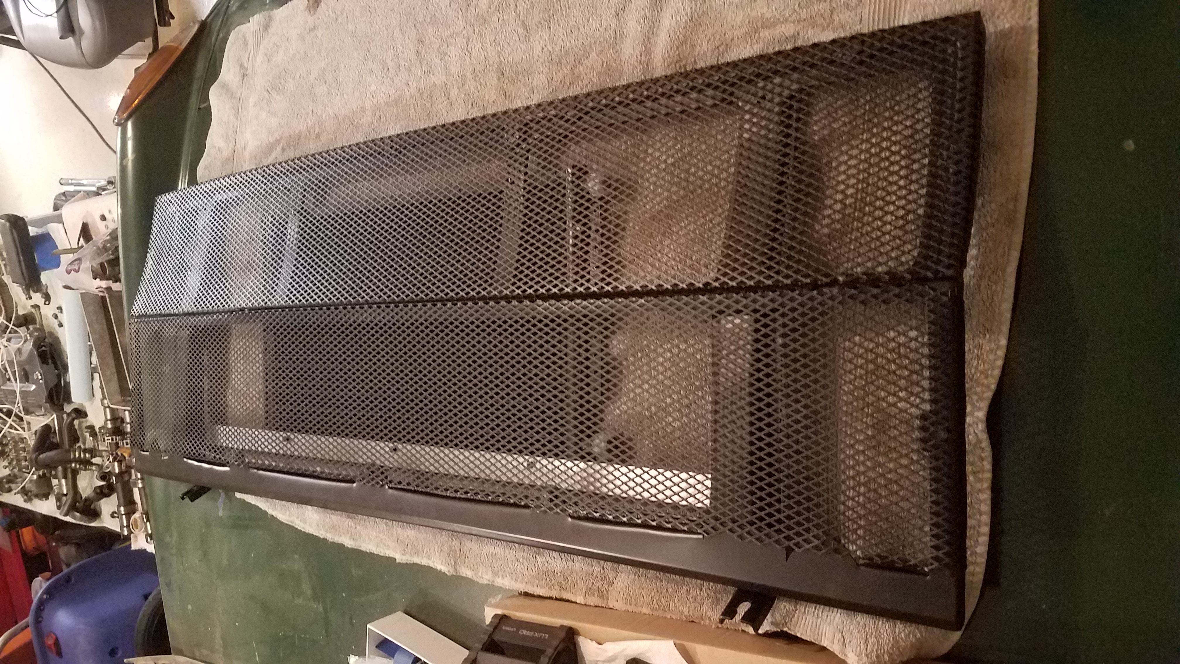

AZBanks   Making progress.   Jun 15 2021, 05:44 PM
AZBanks   Grillin' time!   Jun 15 2021, 05:44 PM
AZBanks   Testing the mount.   Jun 15 2021, 05:46 PM
AZBanks   There is a lot more metal missing than I would lik...   Jun 15 2021, 05:49 PM

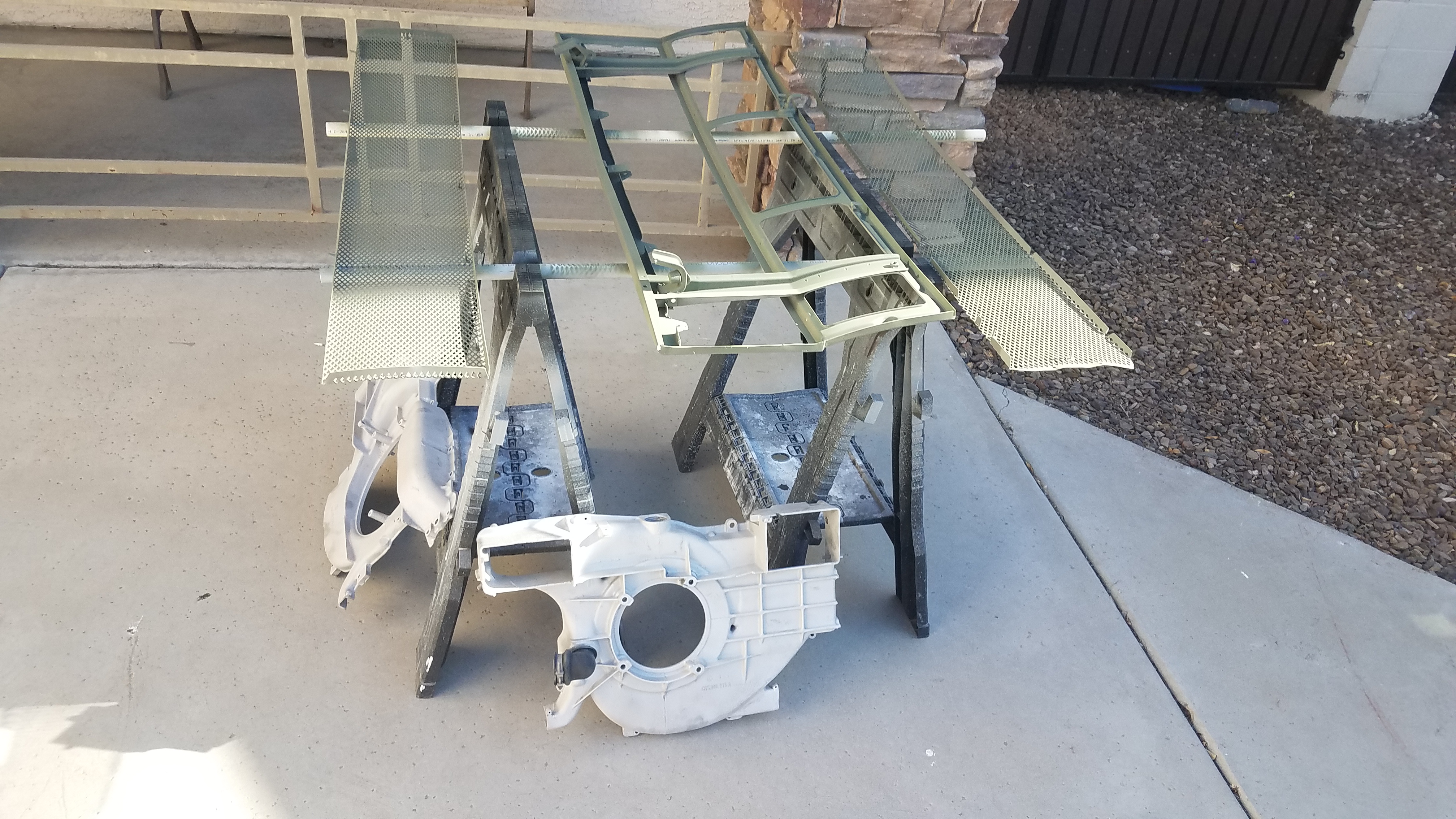

AZBanks   After media blasting and a coat of primer.   Jun 15 2021, 05:50 PM
AZBanks   Put a lid on it!   Jun 15 2021, 05:52 PM
AZBanks   Getting close. I just need some additional spacer...   Jun 15 2021, 05:58 PM

AZBanks   I have space to go up to a 12" X 26" con...   Jun 21 2021, 11:51 AM

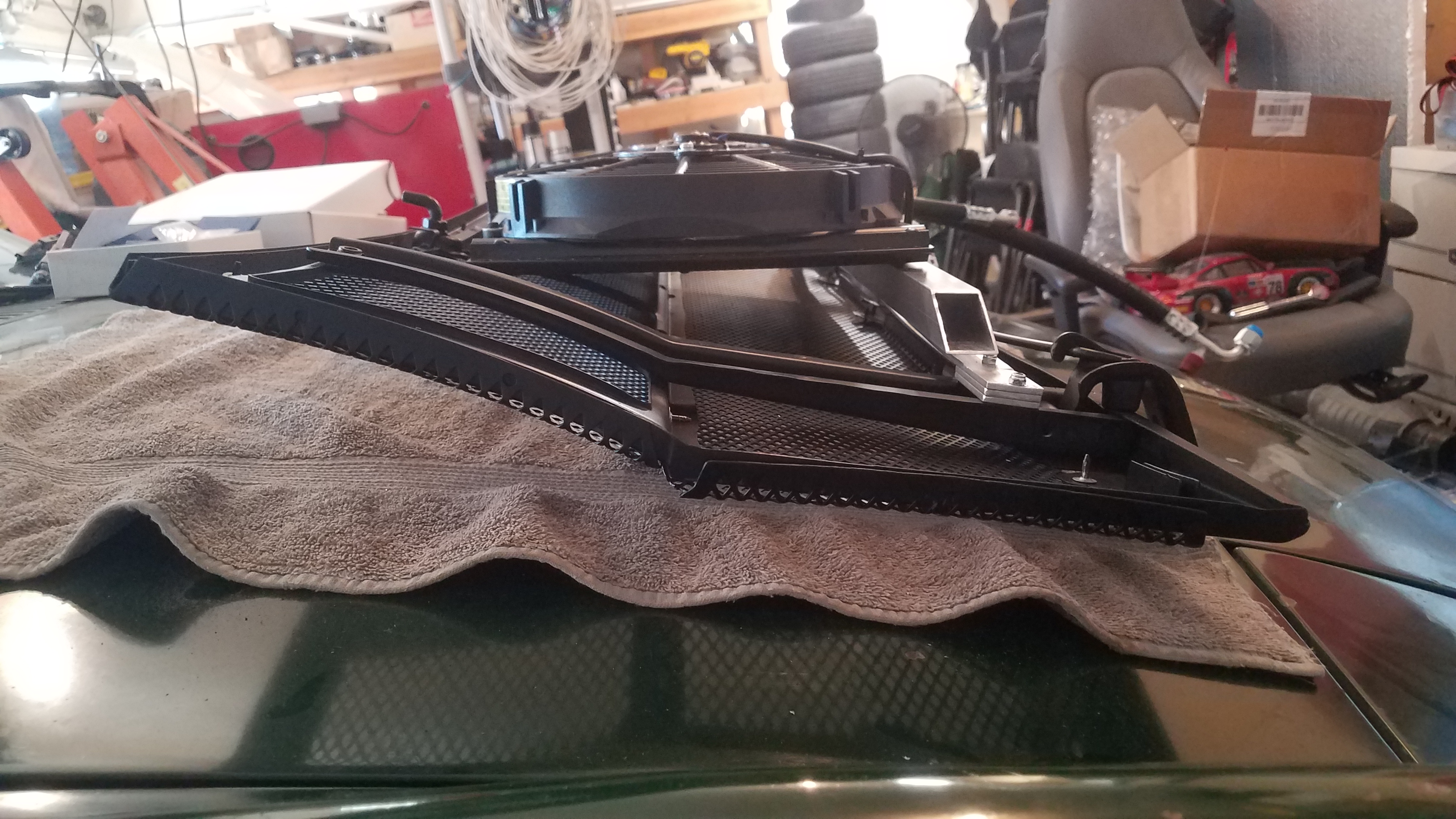

AZBanks   Side view. I had to add the 1" square alumin...   Jun 21 2021, 11:56 AM

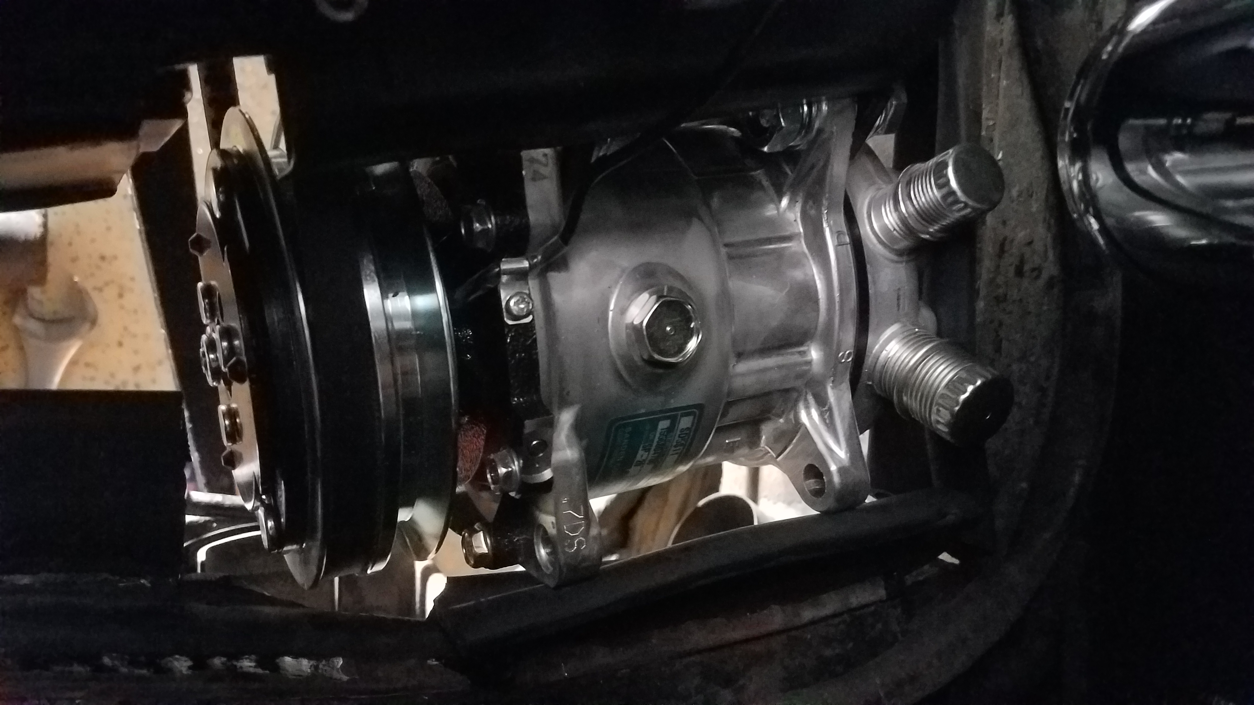

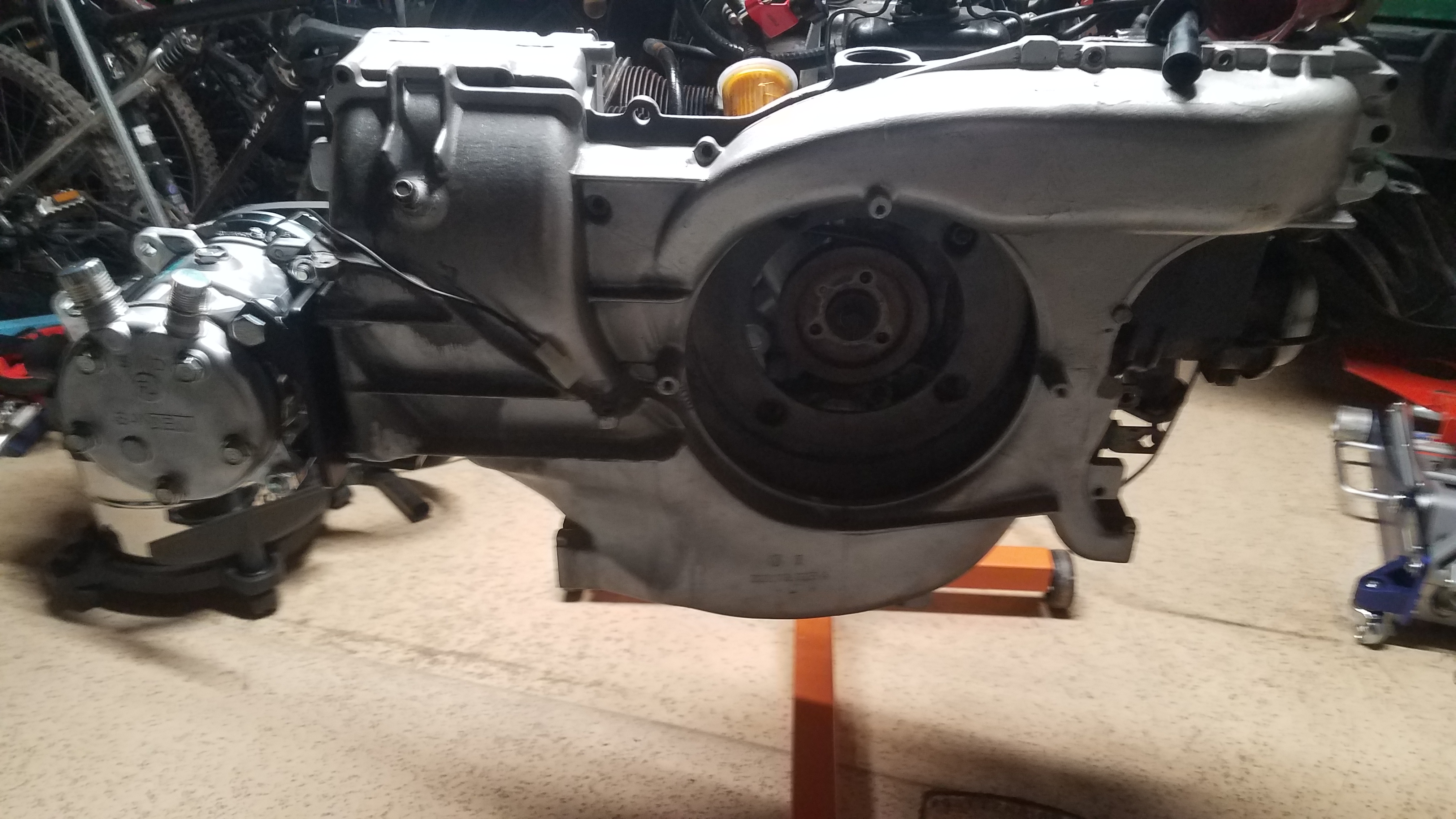

AZBanks   I was very worried about the compressor hitting th...   Jun 21 2021, 11:59 AM
AZBanks   Here is the lid closed with all hoses connected. ...   Jun 21 2021, 12:02 PM

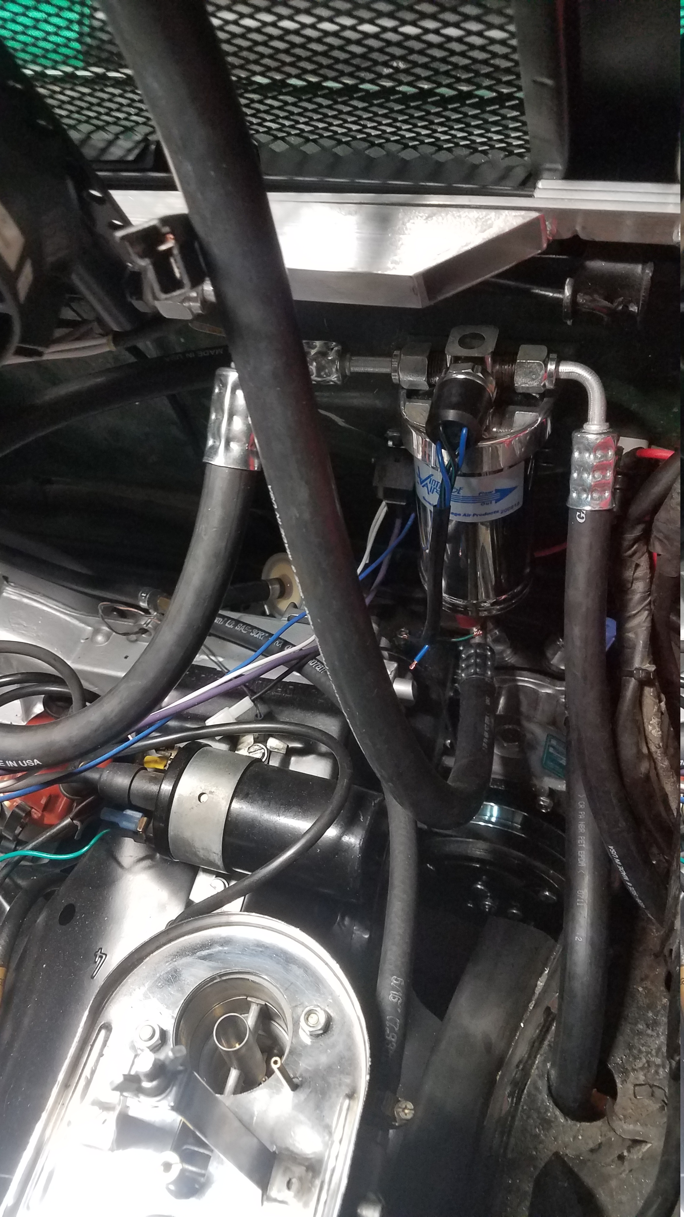

AZBanks   Here is the lid open with the hoses routed. The bi...   Jun 21 2021, 12:09 PM
AZBanks   Here is the compressor with the lines connected. I...   Jun 21 2021, 12:13 PM
