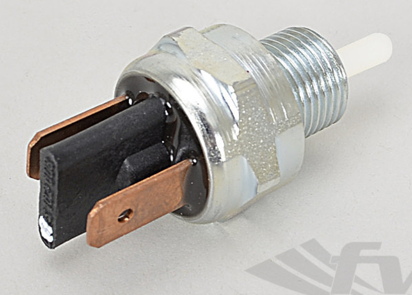

I took the big metal cover off now to try to tap on the switch, and I am more confused now. What I vaguely remembered as a small button is actually a big plastic vertical "bar" like separating the two electrical connectors. I attach a picture from the internet of a very similar looking switch.
Is the black plastic thing a cover that needs to be removed before I tap on the switch? Or is the black thing the switch itself that needs to be tapped down? Its bottom part appears to be flush with the body of the switch.
