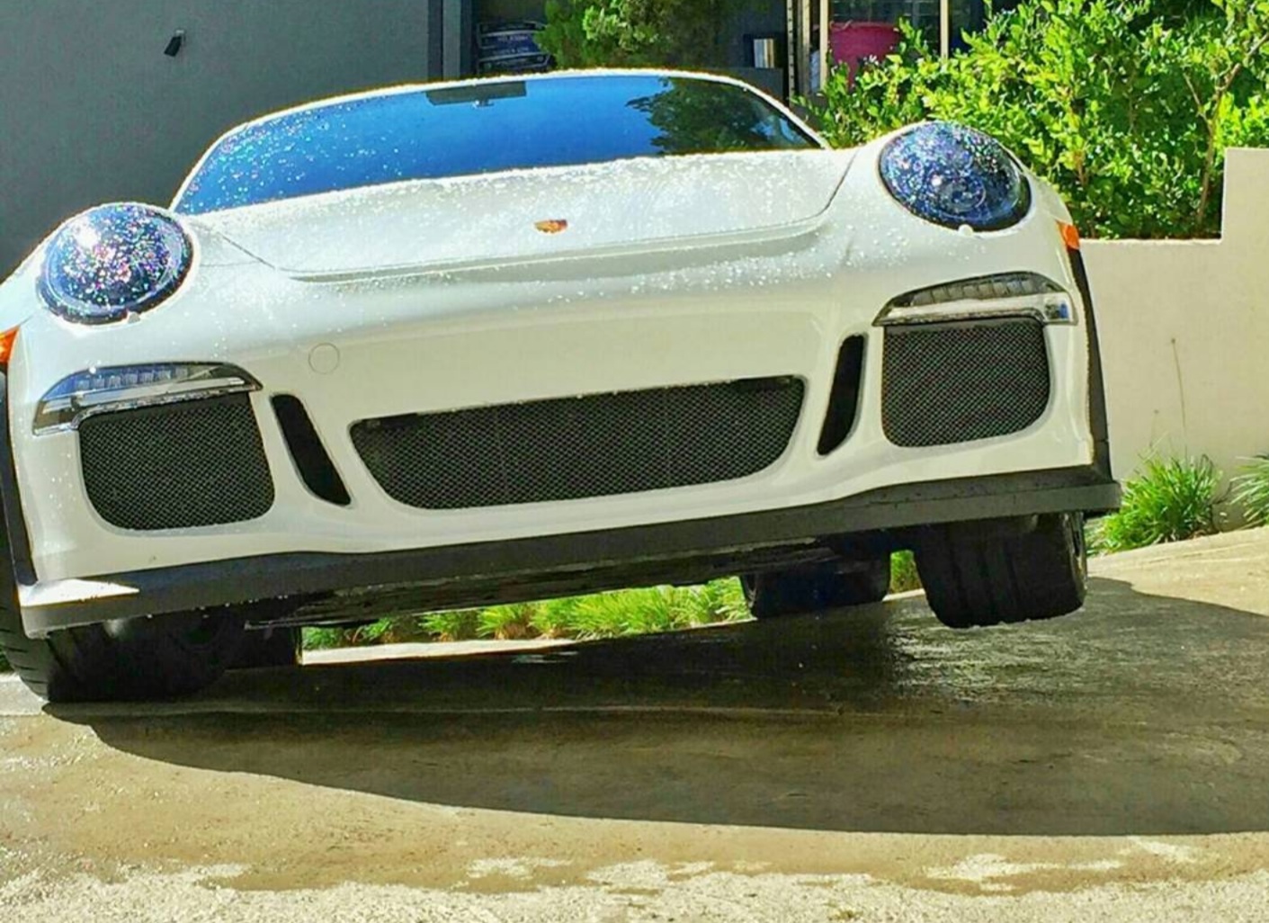

john77   My new airdam won't clear from the street up m...   Jul 17 2021, 04:10 PM
Maltese Falcon   I think that your approach is as severe as my neig...   Jul 17 2021, 04:46 PM
rhodyguy   Nice fix to an unfixable situation.   Jul 17 2021, 04:50 PM
john77   Thanks man. Nice fix to an unfixable situation. ...   Jul 17 2021, 05:32 PM
Maltese Falcon   Thanks man. Nice fix to an unfixable situation....   Jul 17 2021, 07:16 PM
