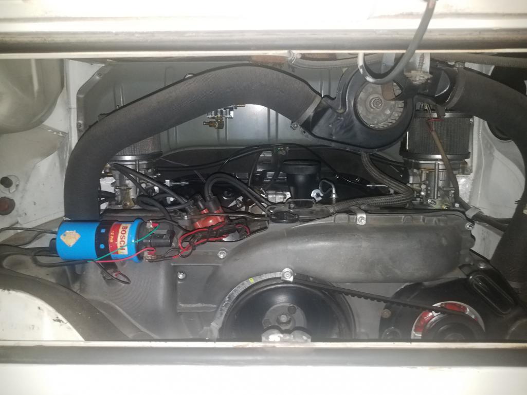

OK, It runs now, and pretty good too! ![]() ![]() ![]() Group: Members Posts: 1,457 Joined: 3-January 03 From: Santa Clarita, Ca Member No.: 85 Region Association: None
Busses were all TIV from '72 to '83. Lots of T4 guys in the Baywindow forums over there.
I have a FAT Performance 2056 in my '73 Westfalia. It runs and drives great, runs out of 4th gear though. That will keep you from running a bus at 80mph all day. You probably shouldn't go that fast in a bus anyway... Engine was originally built for a Sebring Kit Car on VW chassis by it's PO. I wasn't really sure how it would work out in the much heavier bus but it's been just fine going on two years now. Running dual Weber 40idf, I have an oil cooler kit sitting in the garage, just haven't gotten around to installing it yet. Attached thumbnail(s) |
