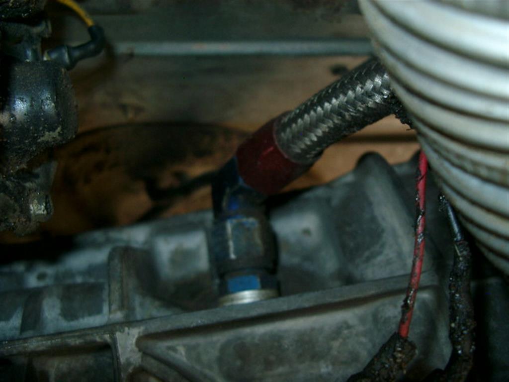

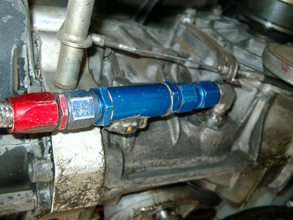

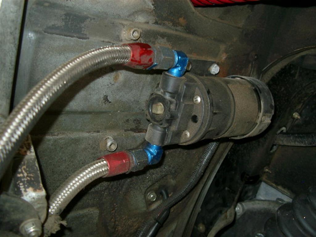

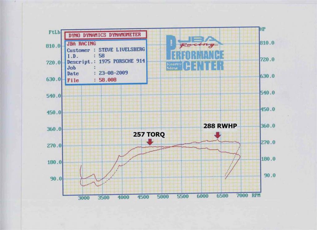

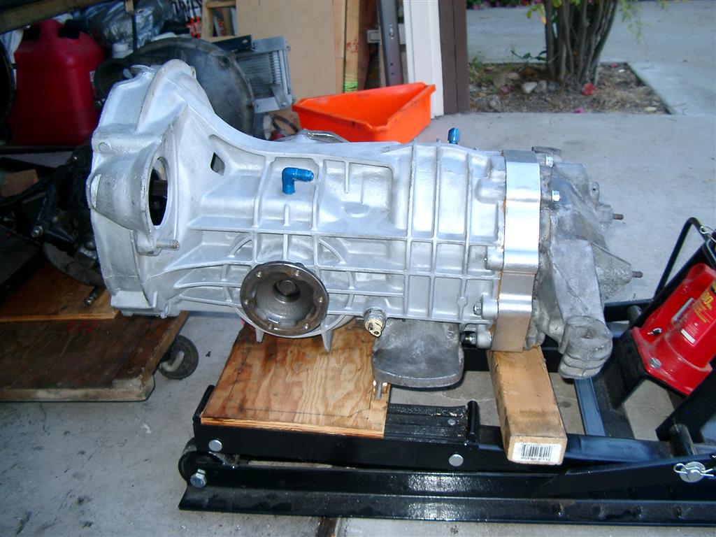

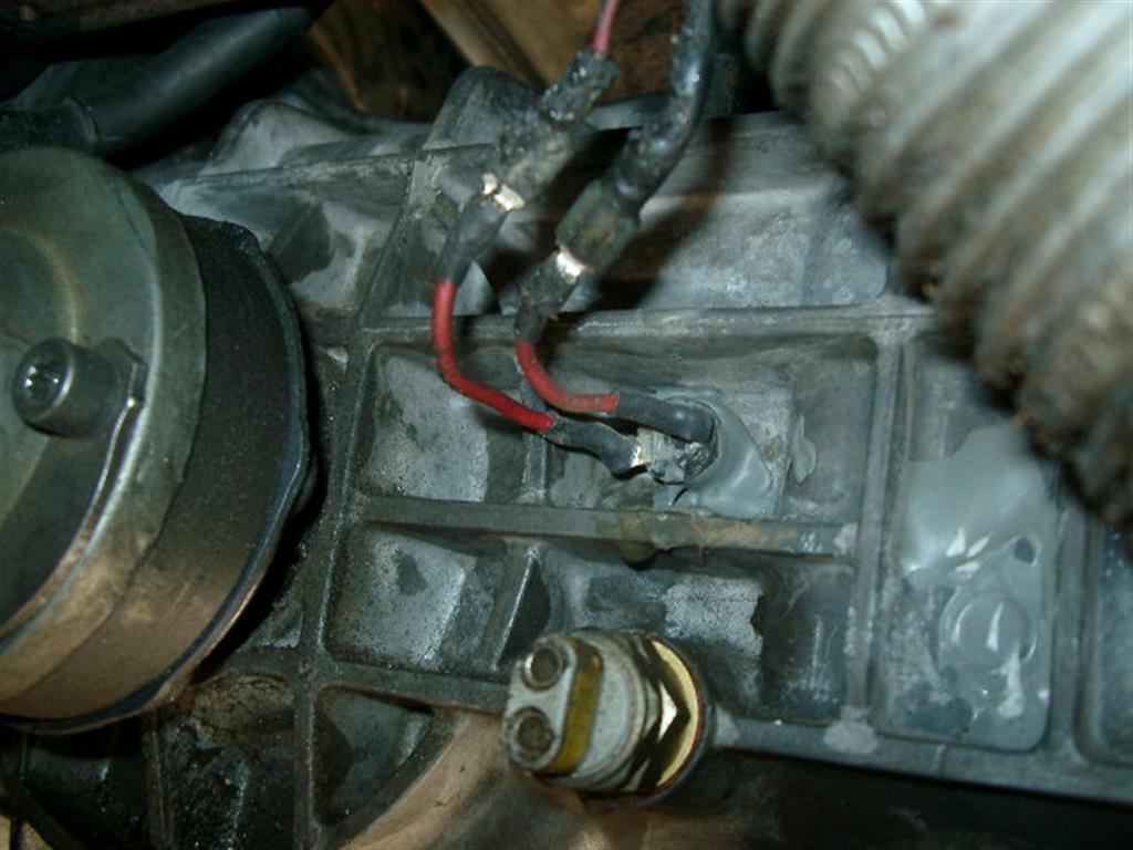

I ran a 914 transmission in a dedicated track car for 23 years. Over time I upgraded the gear box to billet intermediate plate, steel synchros, modified gear set (AFNSY), external oil cooler, pump, and spray ports.
Heat is the death of transmissions and I was working it hard with a 3.4 liter twin plug at nearly 290 rwhp.
In 23 years I had two on-track failures and they were before the cooler and spray ports. One failure was ring and pinion, and one was 3rd gear. I did refresh the box about every 3 or four seasons depending how many events I did. A big year was 10 events.
I used 1st gear sparingly - only to get moving and loading the trailer. Most tracks involved using only gears 3,4,5.

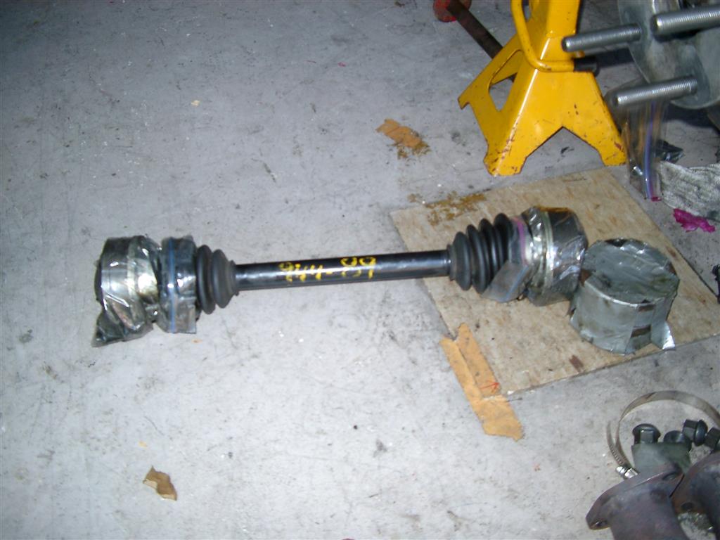

My CV joints and axles were 100 mm CV's sourced from a 944. Direct bolt-in if you also source the trans output flange and hub flange from early 911/912. Never had a CV failure.
I used a thermo switch epoxy to the side of the case which energized a relay to turn on the cooler pump at 180 degrees F.
Sorry about the filthy condition of the parts in the photos - best I could find in my archives.
