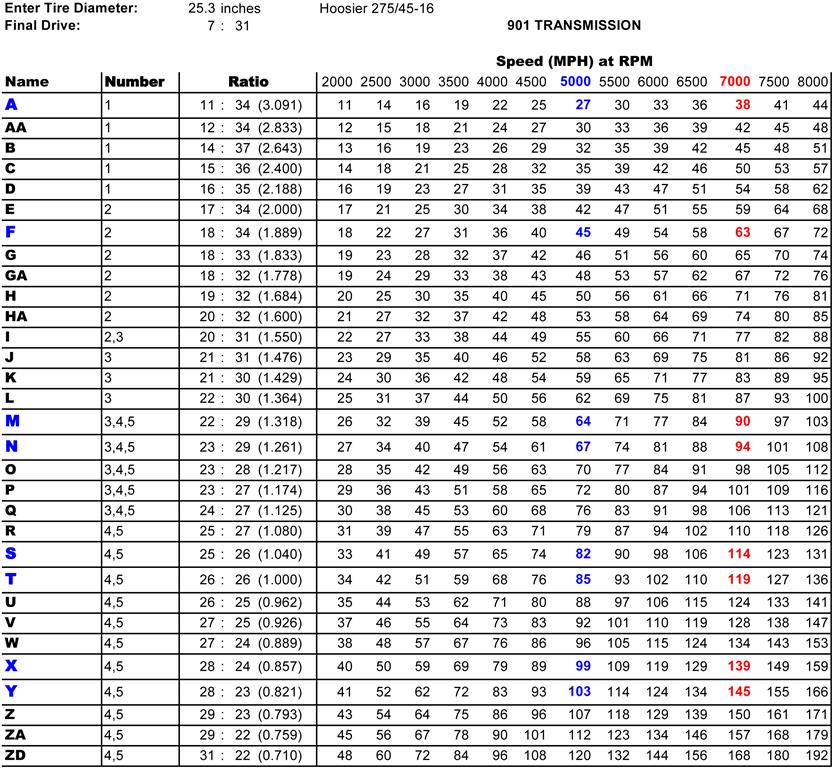

For gear ratio selection, You want to be at redline in top gear at the braking point at the end of the longest straight. Obviously this applies to only one track, so unless you are going to have multiple gearboxes or are going to change gearsets for each track , you may have to compromise. I had two boxes a long and a short gear box (AFNSY and AFMSX) but always kept the long box installed and kept the short box in the trailer as a spare. I could hit redine in 5th on the front straight at Miller Motorsports (now UMC) which was 145-150 but was not at redline on most other tracks.
You have to know the tire diameter that you will be using, your redline, and the track with the longest straight to plan your gearset. I have an interactive excell file that lets you change the tire diameter and or gear ratios but I cannot attach an excell file so I've saved it as a JPG.
