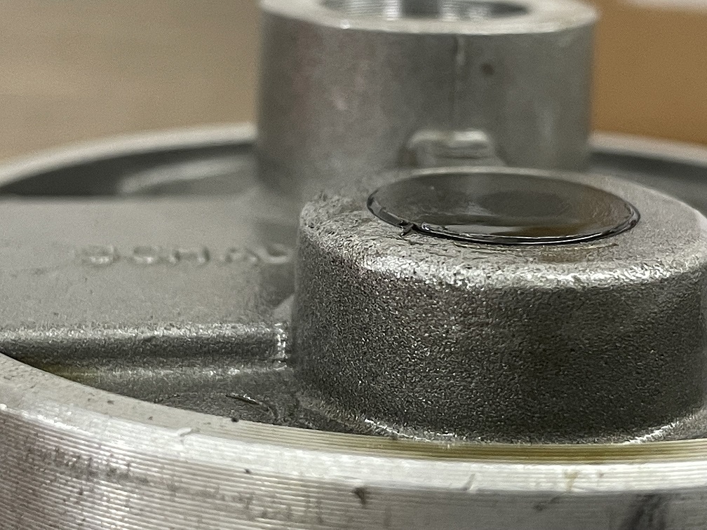

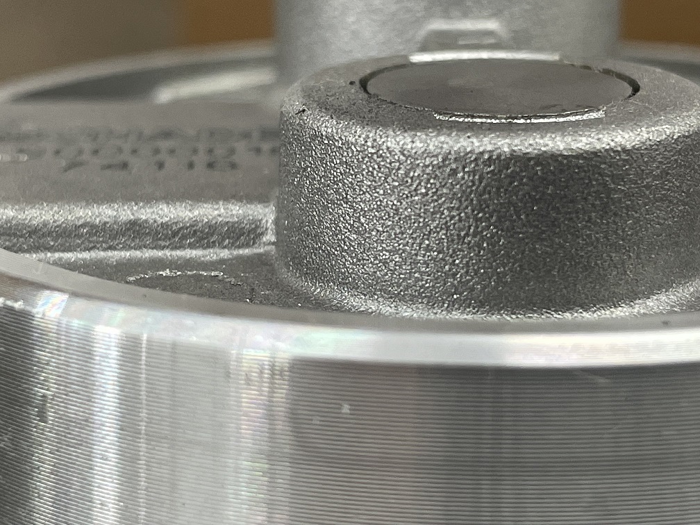

Ok, so the pump housing came off the case easier than I anticipated. I compared the old with the new. One thing that jumped out at me is that the idler gear pin seems to sit proud of the back of the pump housing on the old one. Here's a comparison:
(taken with my wife's iPhone 12 pro, with amazing resolution. Unlike my iPhone 6 which makes every picture look like a vintage loch ness monster pic)
Old pump with idler gear pin sitting proud:
New one from type 4 store:

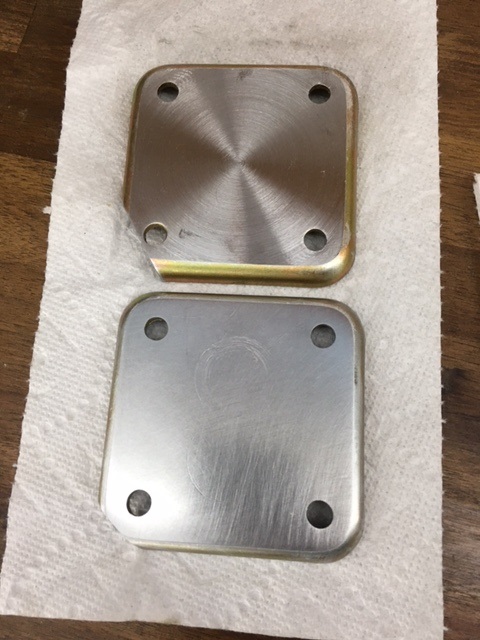

I took a look at the old and new covers. For some reason on the new one from type 4 store they really got aggressive cutting off the corner on the one side to make it clear the case. They didn't leave as much "meat" on there as I would like. So I sanded down most of the galling on the old plate and I'm thinking about reusing that. I exchanged emails with John at the Air Cooled.net and he thought the cover was reusable if I ground out the galling. Hopefully I smoothed out the galling, while still leaving grooves for the Loctite 518 to bite into.
Here's a comparison of covers (taken with iPhone 6):
Just kidding, here it is with new one on top, old one on bottom. Took a lot off that corner when I don't think it's necessary to be that aggressive.
