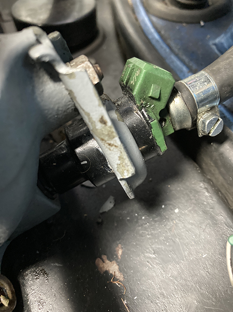

Help - my new to me 1973 1.7 Djet came running really sweet, but almost immediately developed the 'hunting tick-over' of lean running / air leak. We replaced all the vacuum pipes, found one of the inlet gaskets had a very slight leak. Seems somewhere along the line things have been tweaked to compensate for the leaks so that now they're cured, the car is running super rich. Having had a L-jet for years the Djet is new to me so any advice on where to start first would be much appreciated. Thanks ChrisAttached Image

Just out of curiosity, have you checked which injectors are in there? Mine came with 1 1.7 injector and on a 2.0 that means one really lean cylinder. Some fool might have put 2.0 injectors in yours.

QUOTE(emerygt350 @ Aug 20 2021, 11:44 PM) *
OK - I'd never even considered the injectors could be wrong but...

emerygt350   Just out of curiosity, have you checked which inje...   Aug 20 2021, 04:44 PM
Halfnelson   Just out of curiosity, have you checked which inj...   Aug 23 2021, 07:57 AM
Halfnelson   Lots of questions spring to mind like how it was e...   Aug 23 2021, 08:02 AM
emerygt350   I have 1... And it is yellow. I bought those n...   Aug 23 2021, 06:19 PM
emerygt350   The left side is the 2.0   Aug 23 2021, 06:27 PM
steuspeed   Wrong injectors.. amazing! I bought a set of S...   Aug 23 2021, 10:34 PM
ChrisFoley   Those look like 1.8L injectors, for L-Jet. Someone...   Aug 24 2021, 09:52 AM
Halfnelson   Those look like 1.8L injectors, for L-Jet. Someon...   Aug 25 2021, 09:37 AM
emerygt350   Wow, the plot thickens.   Aug 24 2021, 11:23 AM
emerygt350   The one you are looking for is the fj114. 59 doll...   Aug 25 2021, 10:09 AM
