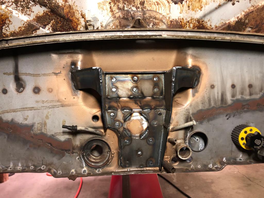

Making the conversion to a 6 cyl, we have several choices to make with mounts, exhaust, fuel, oil tank, engine tin, ....
I recently purchased the OEM mount from Mad Dog, you couldn't ask for a better fit. It nestled into the recess and allowed basically no room for error. I socked it in with a couple self tapping screws and went ahead with the plug and fillet welds.
I removed the paint from the mounting surfaces with paint stripper and cleaned it up with a sanding disc prior to welding
From what I understand the factory placed additional reinforcement in this area. Running the welds for this mount I sensed it the way my MIG was acting. I bet you could pick the entire car up from this mount. Very well done Mad Dog Attached Image Attached Image

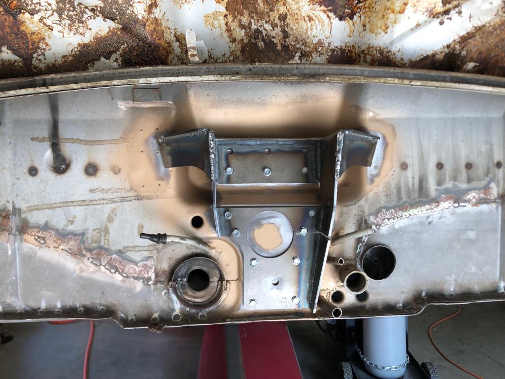

pencap914
post Aug 31 2021, 02:02 PM
Posts: 81
Joined: 16-April 06
Member No.: 5,872
I had a little time this weekend to finally weld this up. Fits like a glove!
