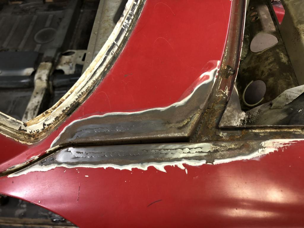

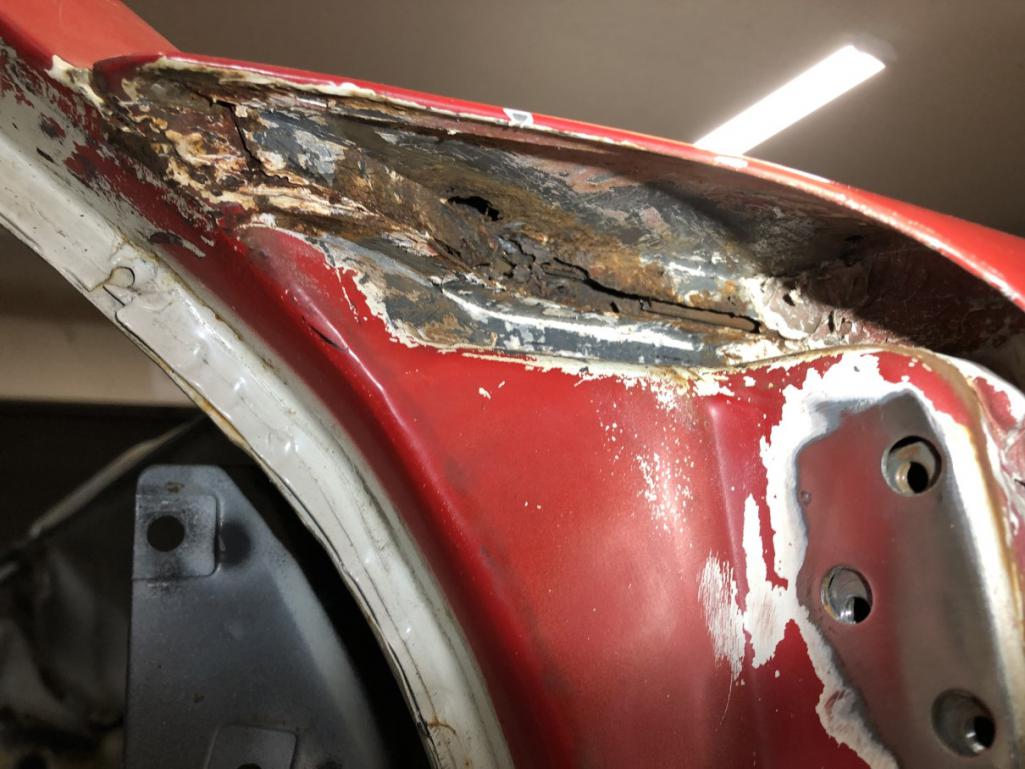

So now I have a problem to solve: What to do about the brake proportioning (err.. pressure equalizer?) valve. My car is a late 74 build so its the later style more commonly found on 75-76 cars, so I had to remove the valve and bracket to make way for the /6 engine mount. I may see if PMB would be willing to take this one as a core for a rebuilt early valve, then find some hard lines from an early car, or bend my own.
Next big project: Take on this ugly mess found on both sides of the car:
A previous repair attempt was made, but unfortunately its just insufficient. I purchased the cowl repair panels from AA. Not really looking forward to this repair, but it has to be done. This certainly will push my skills to the max. Lets hope I don't c**k it up too bad!
