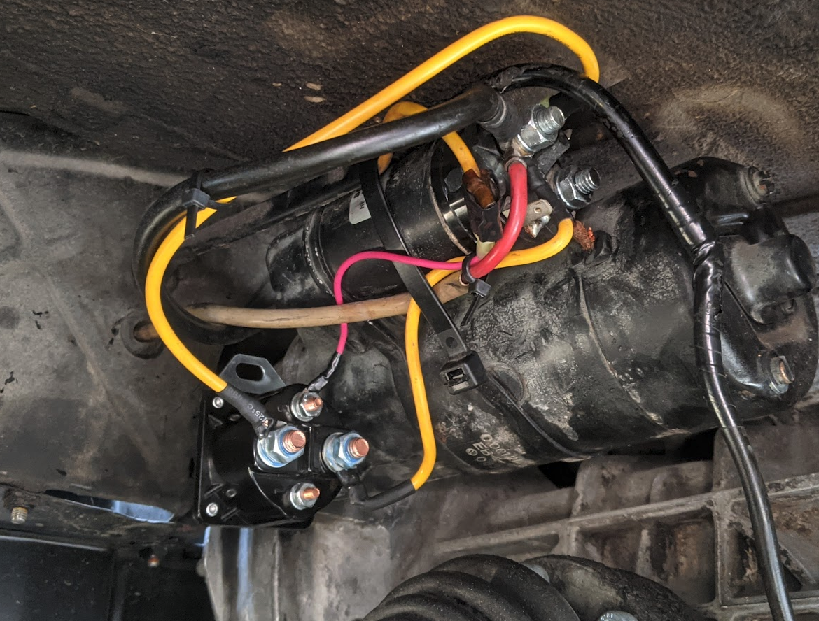

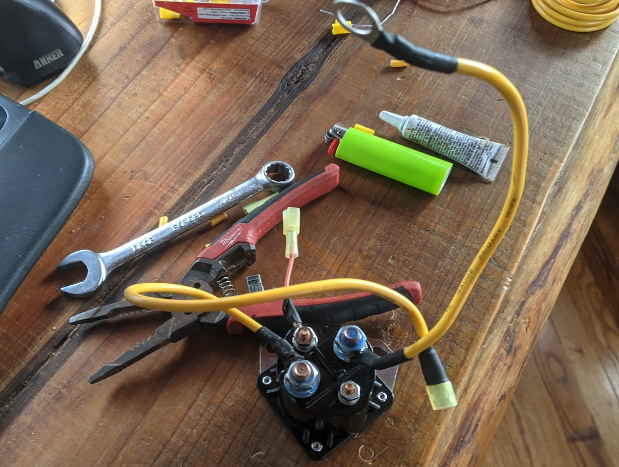

Did this today. Used a $17 solenoid from O'Reilly. Here's the link to the part.
The 90 degree mounting plate makes it easy to attach to the starter mounting bolt. Ream out the 3 o'clock hole on the mounting plate. No need to bend anything.
Wire yellow to the "S" lug on the new solenoid/relay.
Female blade wire on the 9 o'clock lug, if "S" is noon. 14" wire.
Eyelet terminal mounts to the 3 o'clock lug. 12" wire.
