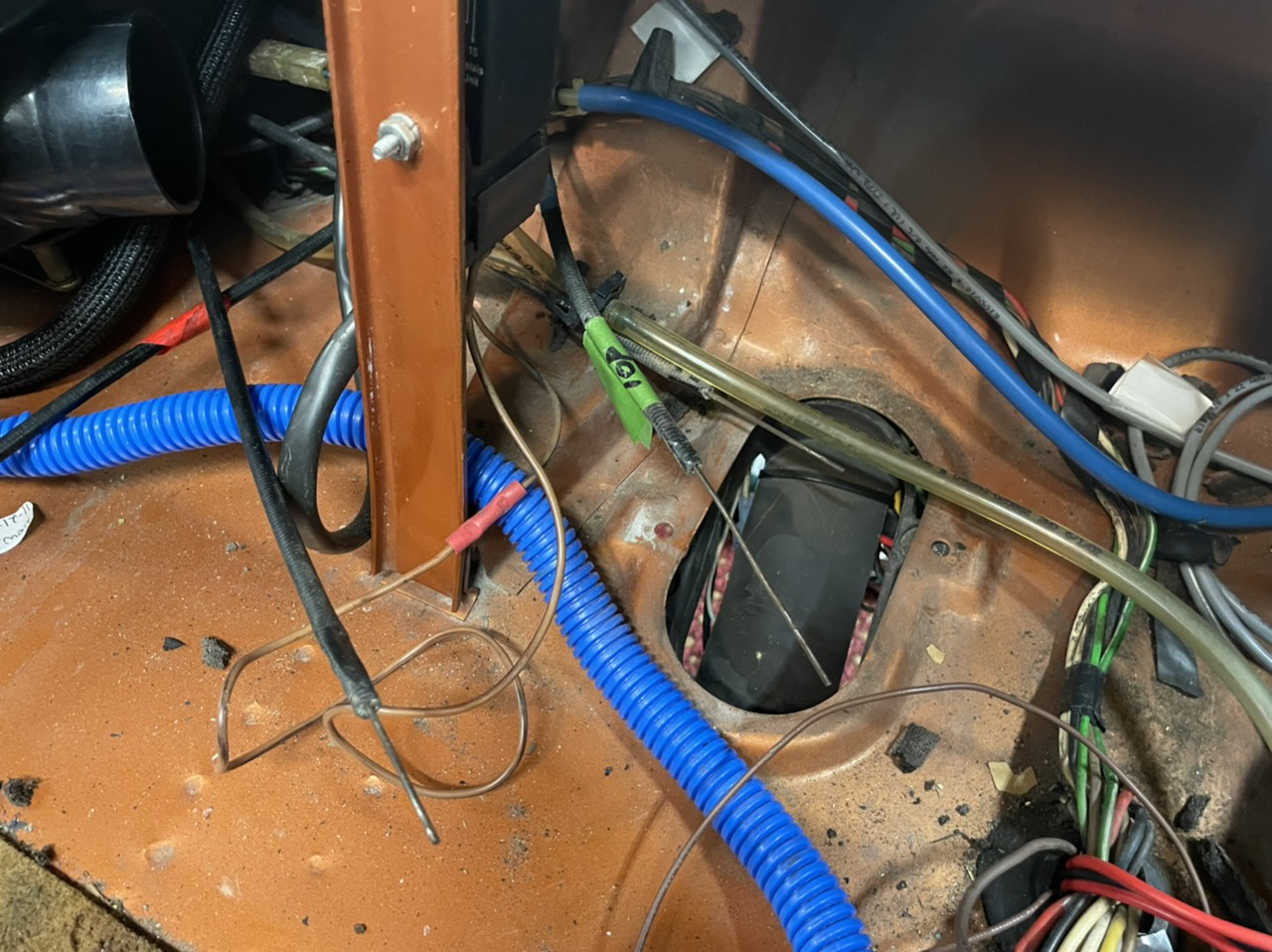

How is that valve removed from under the cowling. My plan is to pull the gas tank for better access first; then replace the driver side heat/defrost valve. The re-install the control cables.
Any tips will be appreciated…
( see sample photo, not my car )

Got the valve out, came out pretty easy. The hard part was removing the clips that hold the cable. I’m hoping I can reassemble the valve with deforest nozzle and reattach the cables. Tight fit !
Any tips ?
I did unscrew the bolt to the post.
